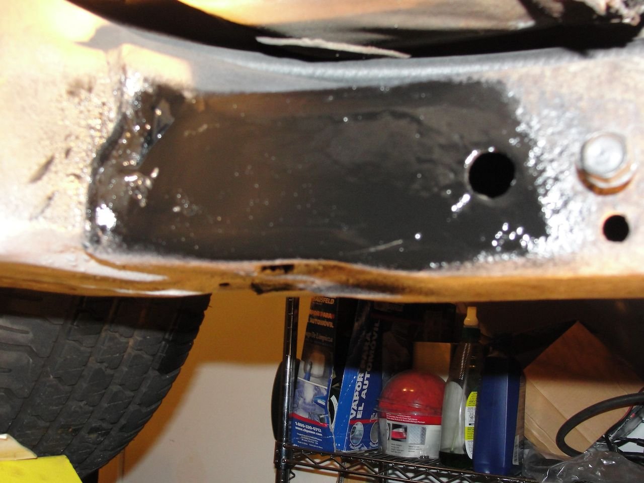

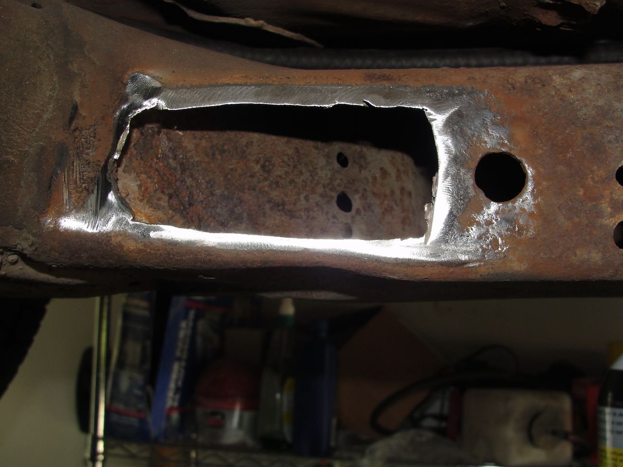

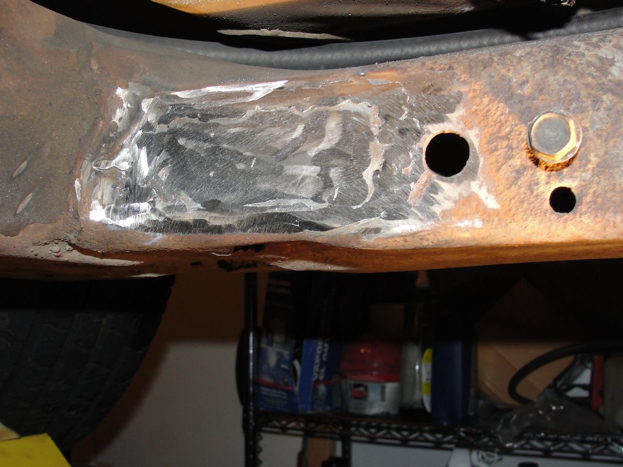

Here is one of the reasons I'm putting in a replacement frame. I think its a better frame than most (so I think I'll sell it) but since I had the opportunity to get a rust-free frame I think I want the most solid frame possible for the next 50 years.
This is the hole I didn't like
Trying to scope the problem
Got to decently solid (but still thinner on edges)
Welded new in, then ground flush
Por-15 on top
Goldhawg is offline
