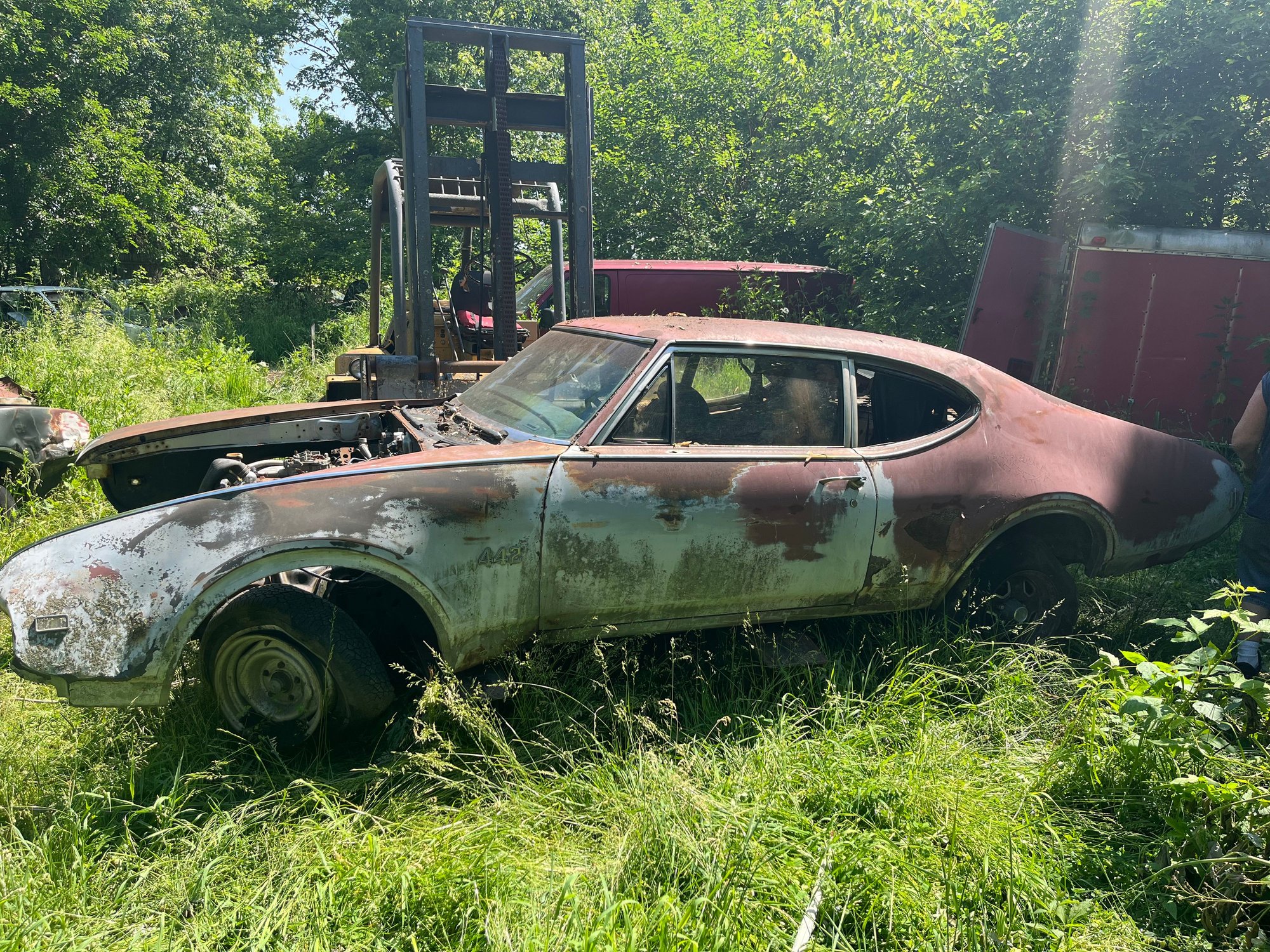

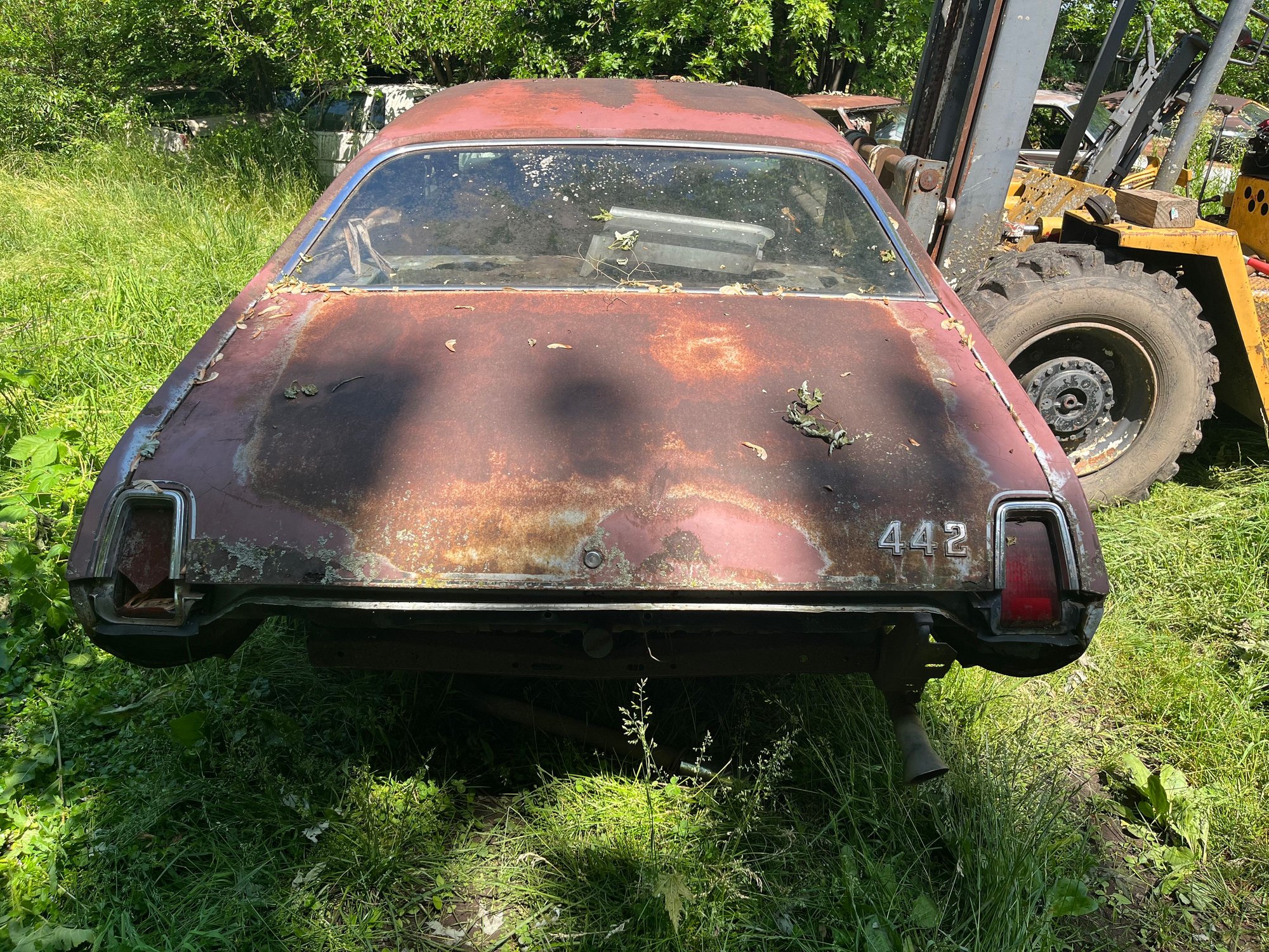

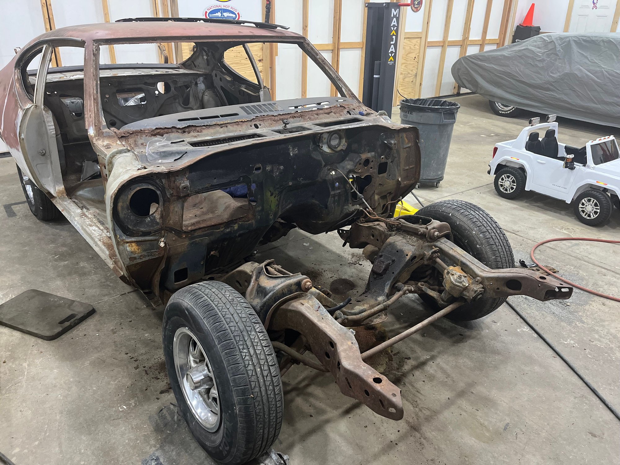

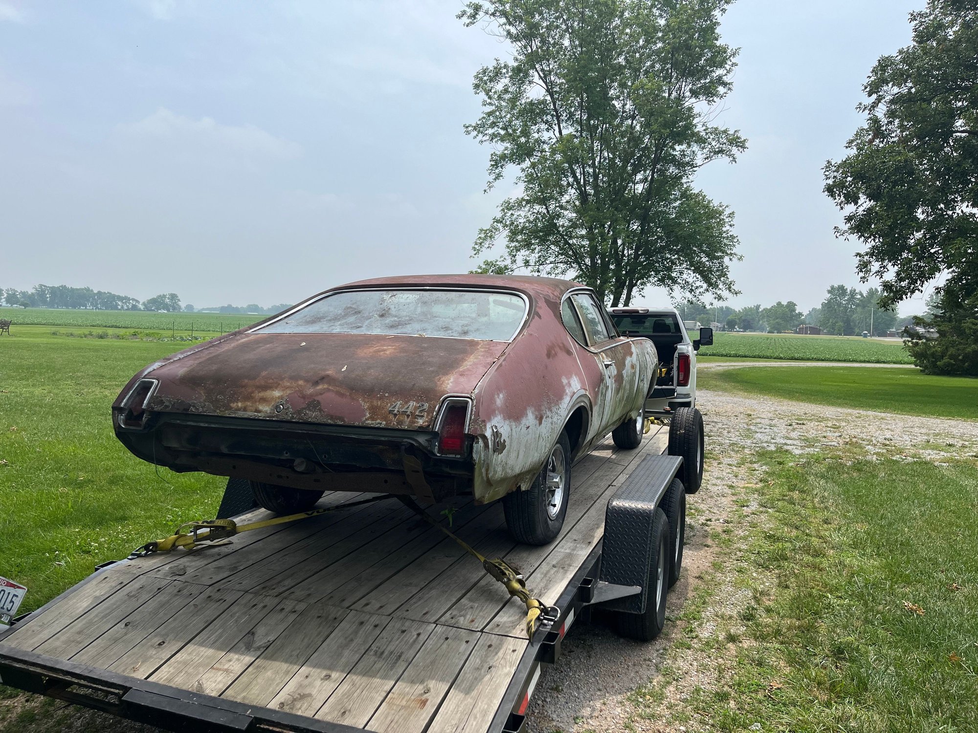

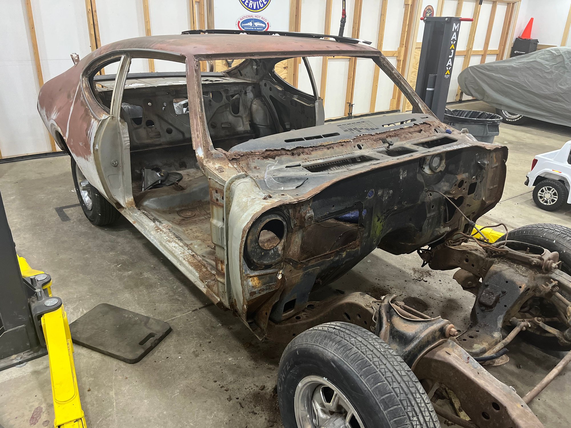

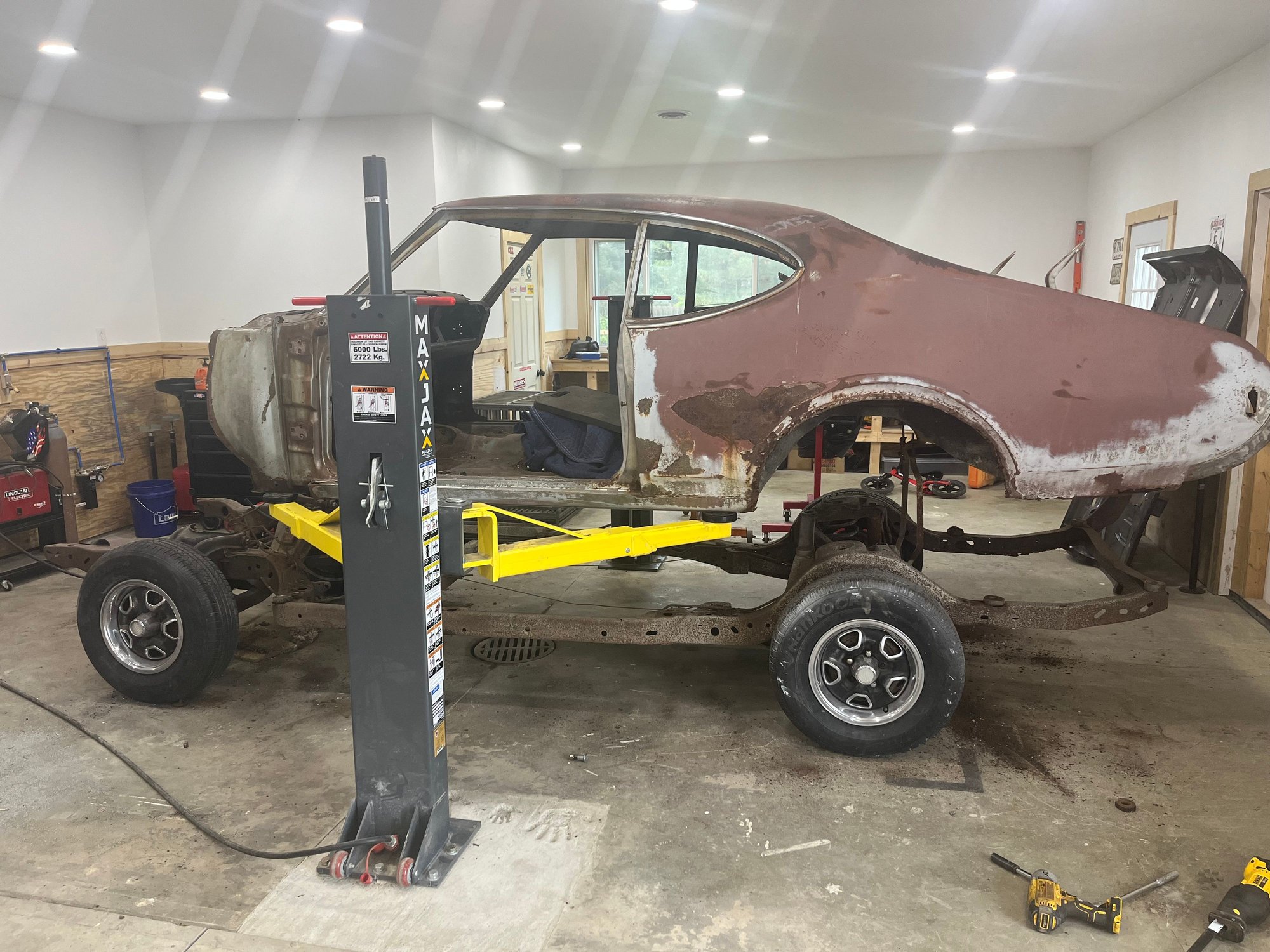

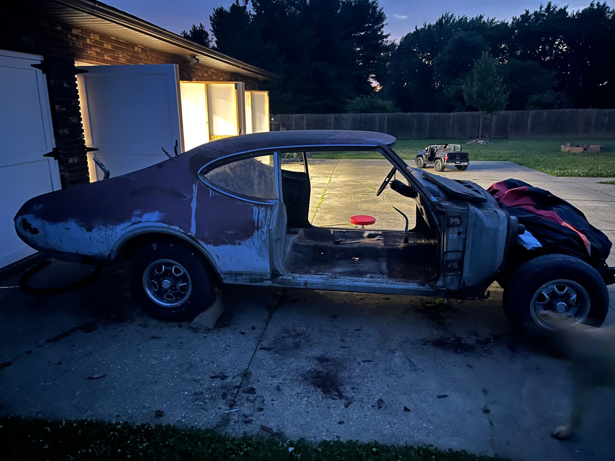

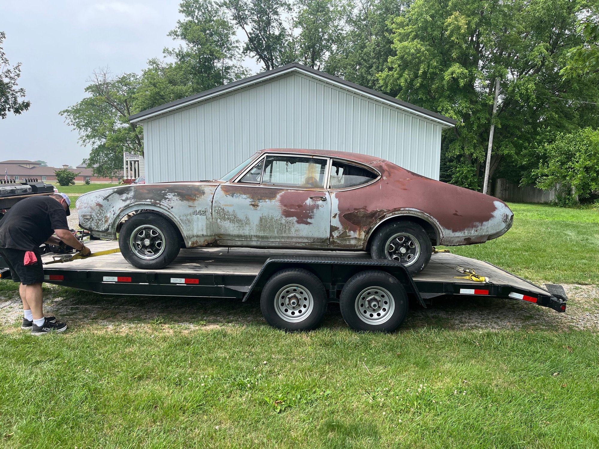

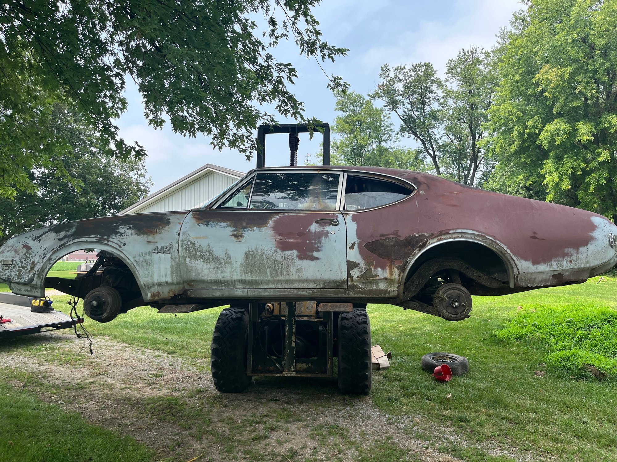

So for the past couple years I’ve been buying and selling parts on this site for my 69 cutlass S convertible restoration, now I’m hooked. I bought my first Oldsmobile when I was 16. It was a 69 F85 i drove it all through high school and sold it to my best friends brother when i was 20. 24 years later i bought my 69 convertible and took 2 years to restore it. Going down that road has lead me to my current project 69 W30 442 Post. I bought this car from a friend of mine in Indiana it’s more of a rescue restoration than anything. I’ve been to nationals and Lansing show and few other Oldsmobile shows and still haven’t seen a 69 w30 post. So i figured let’s bring this one back from the grave. Ill take any advise from you guys that i can get.

The car is a bench seat with 4spd and tilt steering

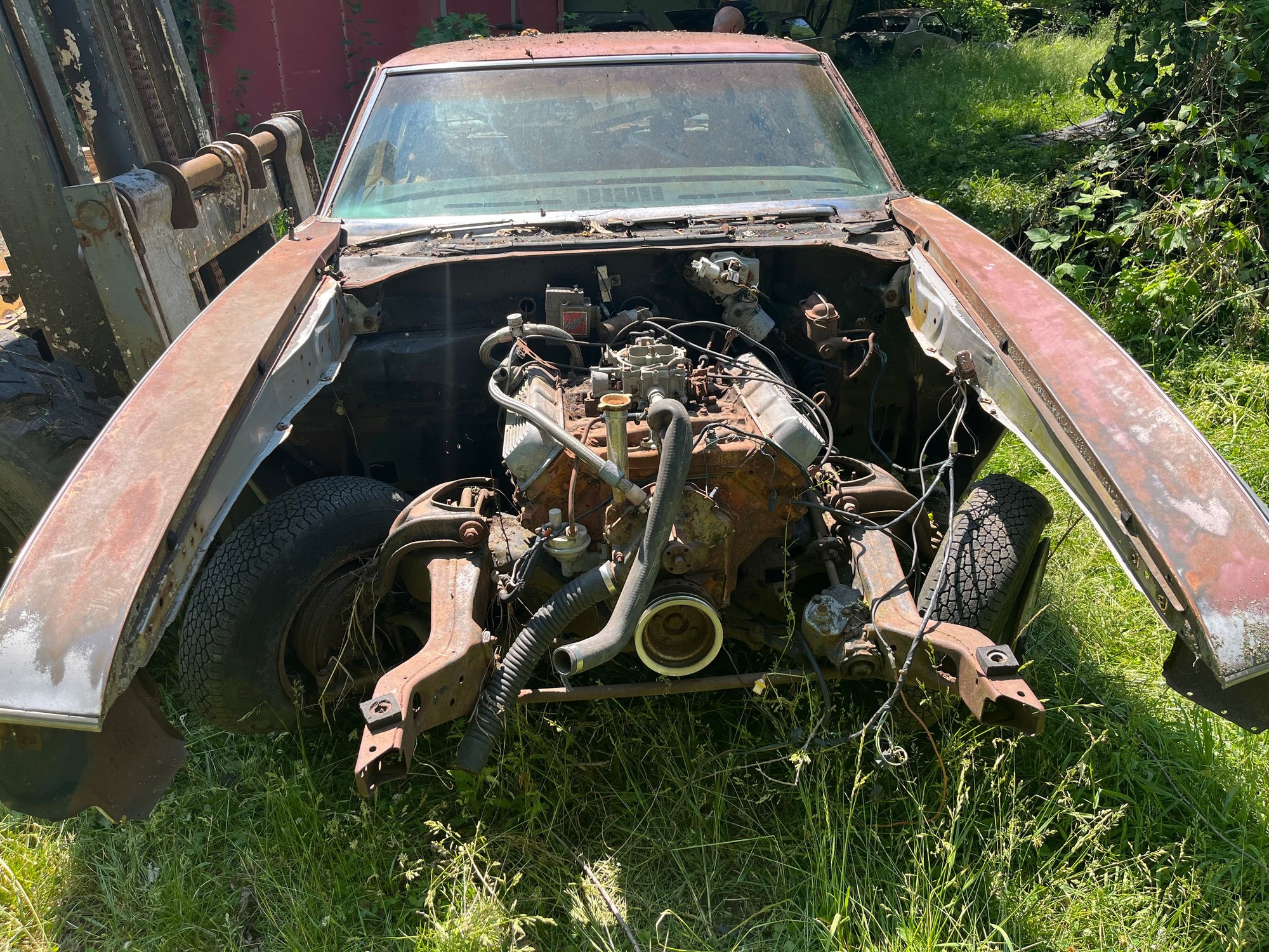

Some more pics

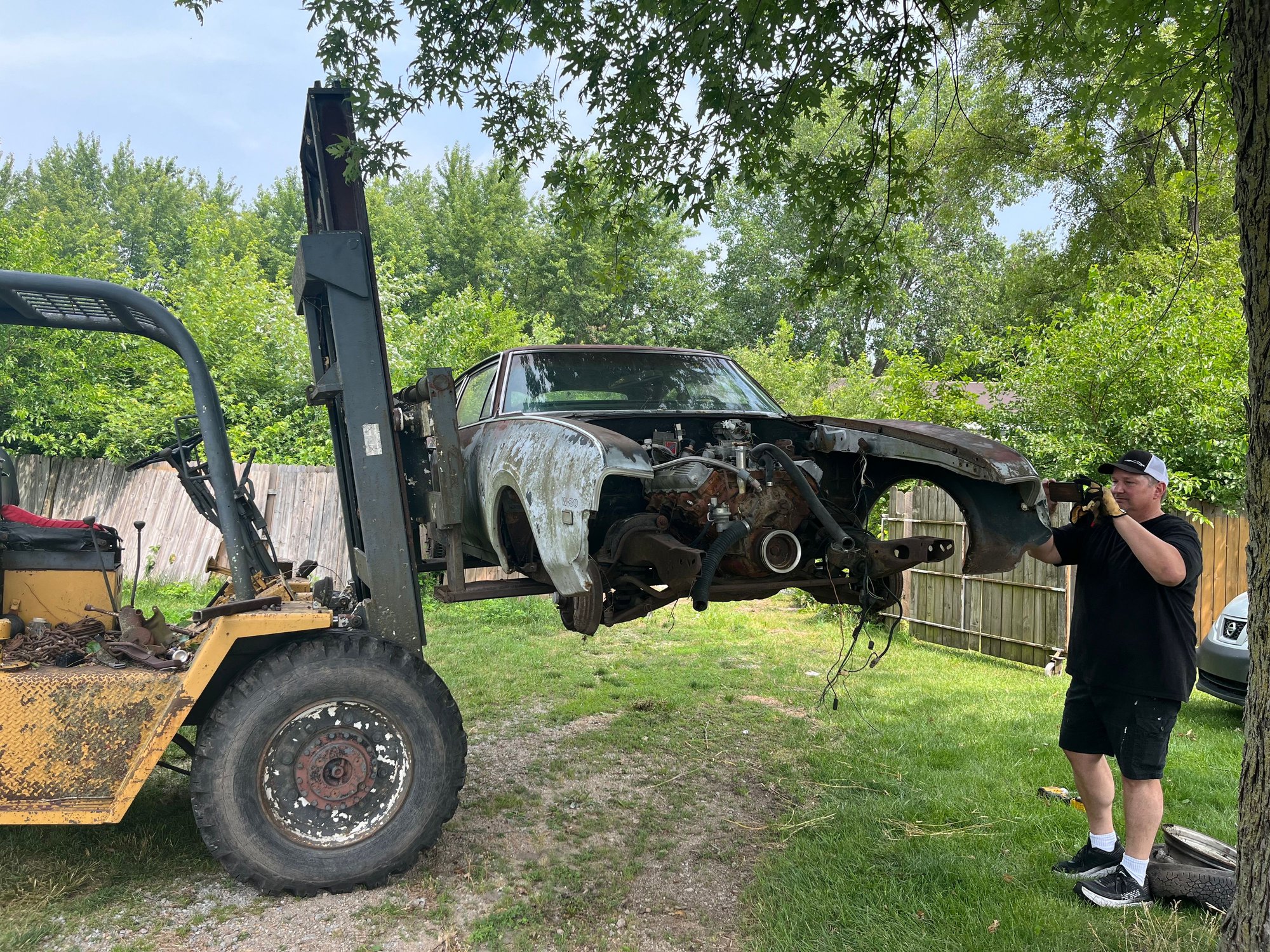

Cool project! We need more pics of the car. Any idea of what engine/trans is currently in it?

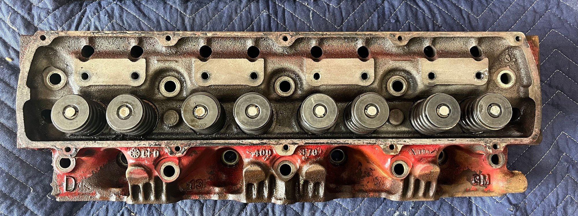

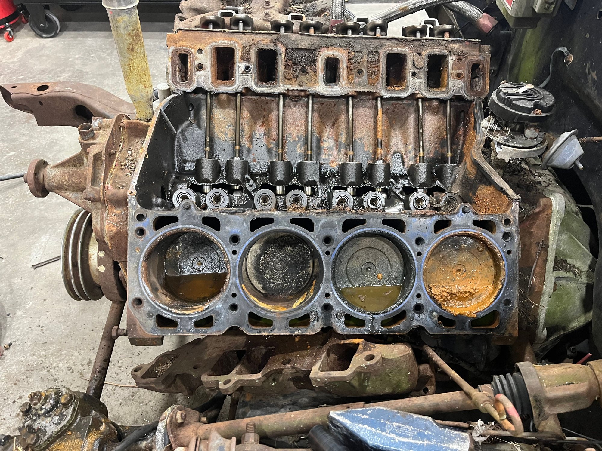

It came with a 400 G block and a m20 4spd, talking to the owner this engine block was replaced in mid 70s. I sold the D heads that came with the car and bought a complete 69 w30 motor. The motor that came with car was blown up ill attach some more pics

Some motor pics

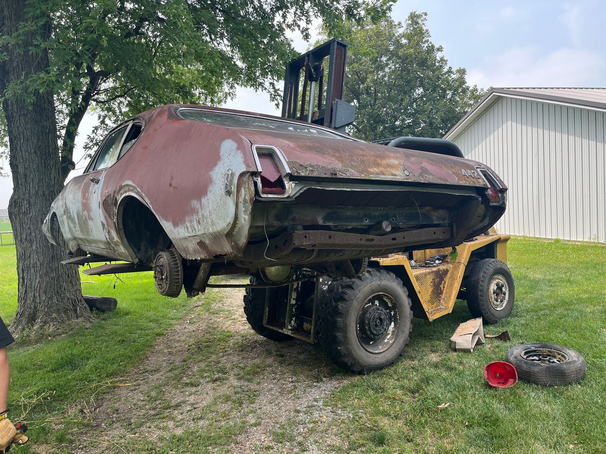

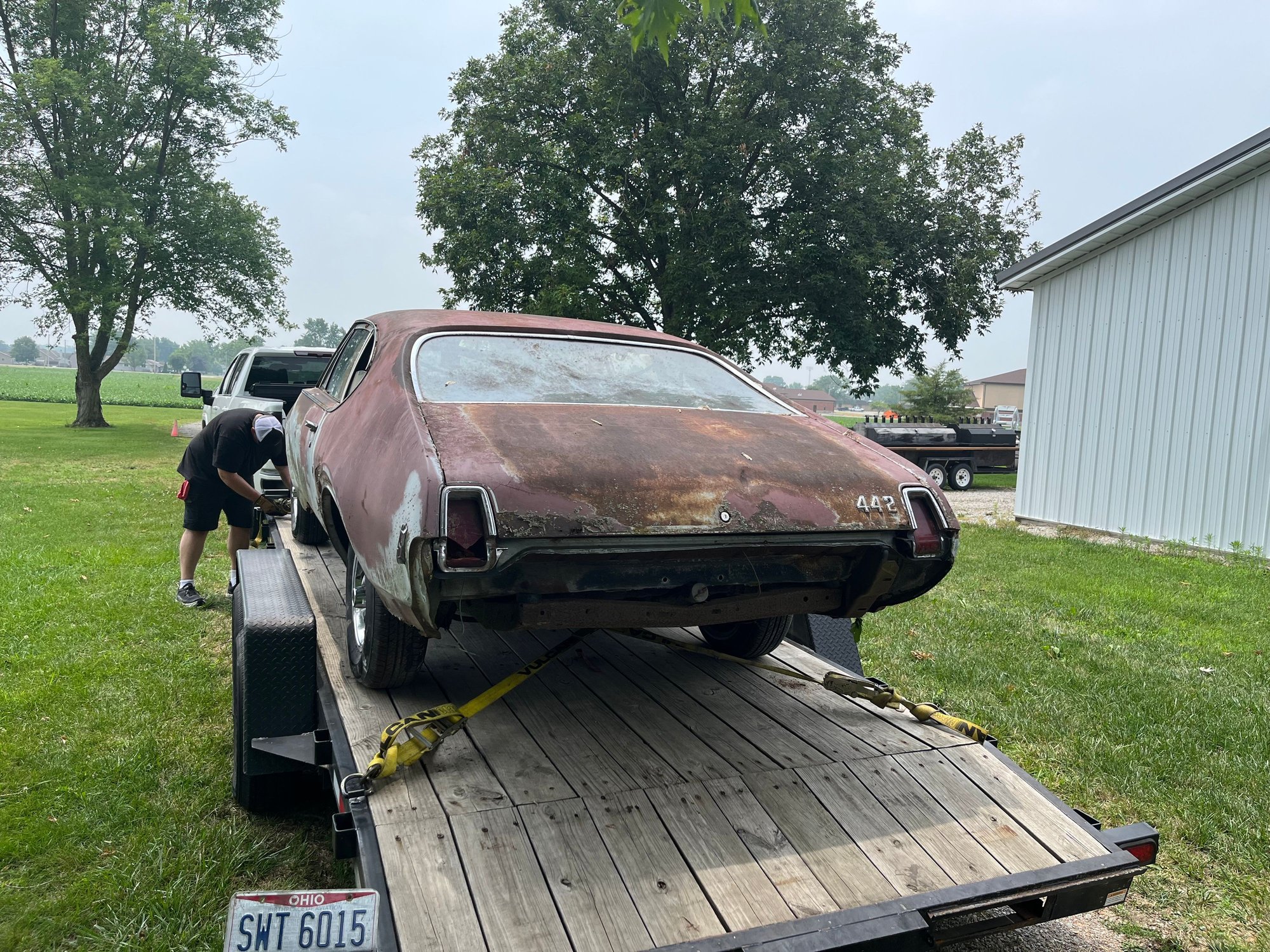

Back story on the car is the origanal owner blew up the second motor he put in it, then decide to trade it to my friend in 1985 for a 68 w31. My friend parked the car in 85 then was gonna use it as a parts car. It sat ever since till i came along a bought it. As far as interior i have the back seat and front seat i threw away it wasn’t salvagable. My intent is to bring it back the way it came from the factory. I’ve been collecting tons of parts for it still need a couple things but im on my way. Colors are platinum with black interior and black stripes on the hood. The only thing I’m gonna change is the transmission. My older brother talked me into a TKX 5spd the car has the correct TO 3.91 rear gears

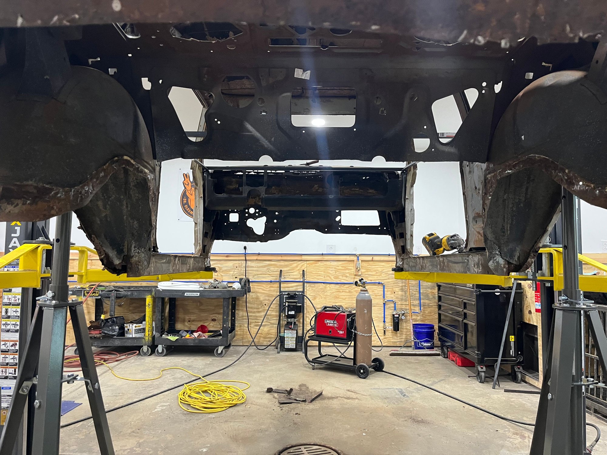

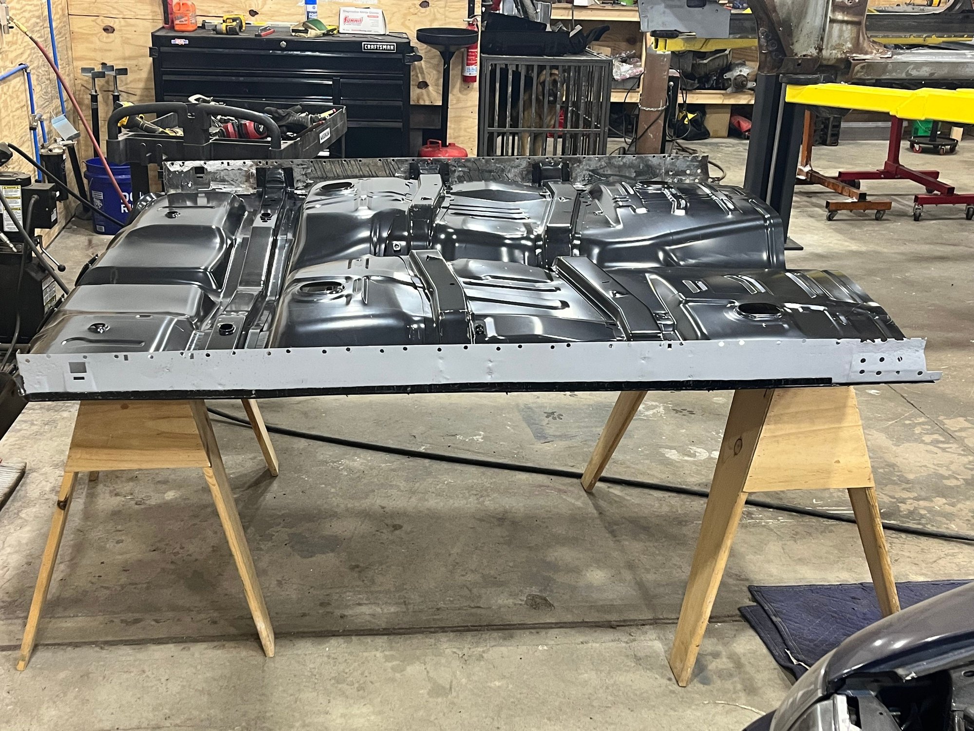

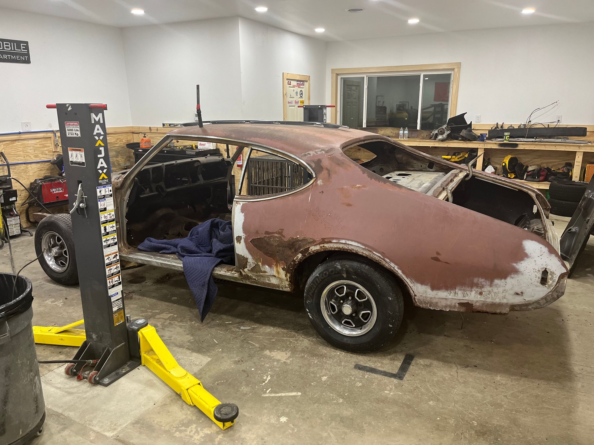

Quick update, i have all the floors removed and waiting on Parts Place for my full trunk and firewall. I removed right side inner rocker to repair the rot behind inner rocker on lower cowl.

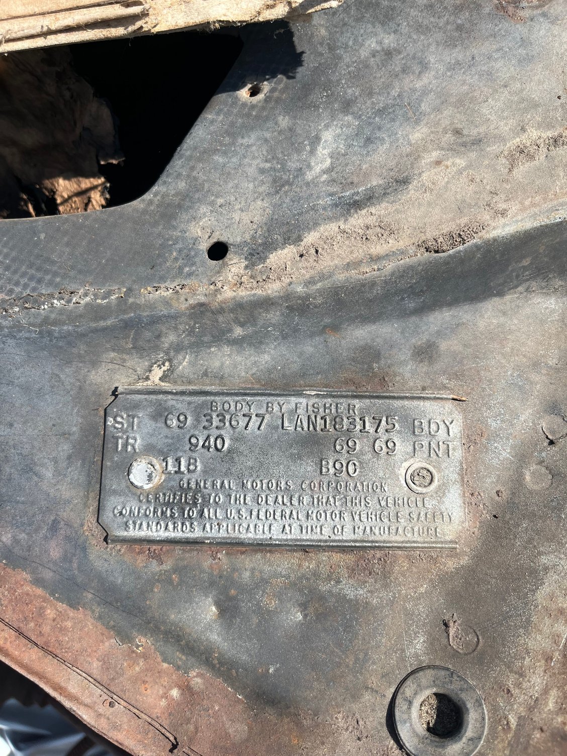

You are a brave person. Unless the doors have been changed, I don't believe that is a 69 since the 69 doesn't have vent windows.
my post 69 has vent windows.

Post cars have vent windows. Looking forward to following the build, like how they had the car equipped manual steering and W30 manual brakes what is not to like.

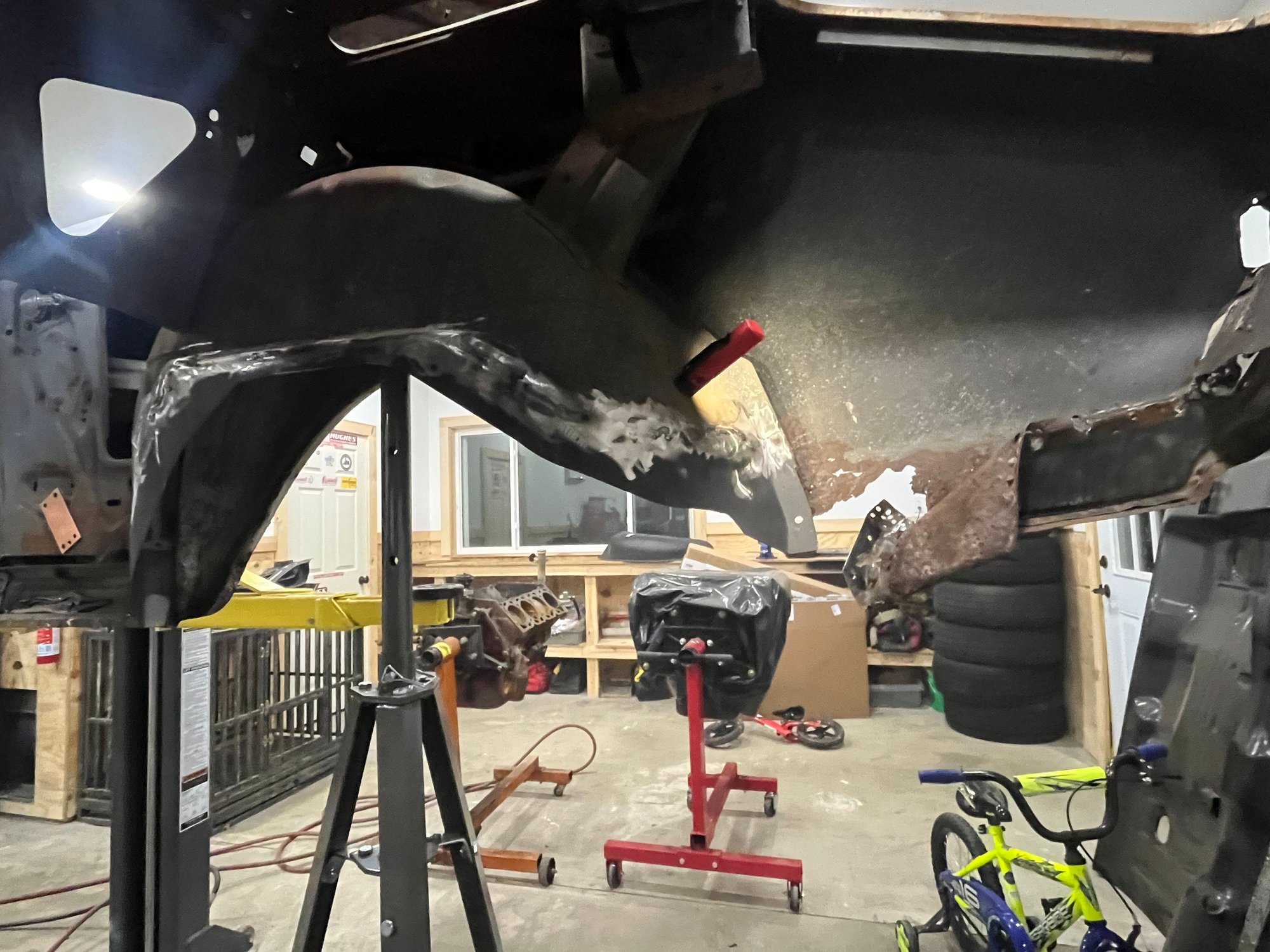

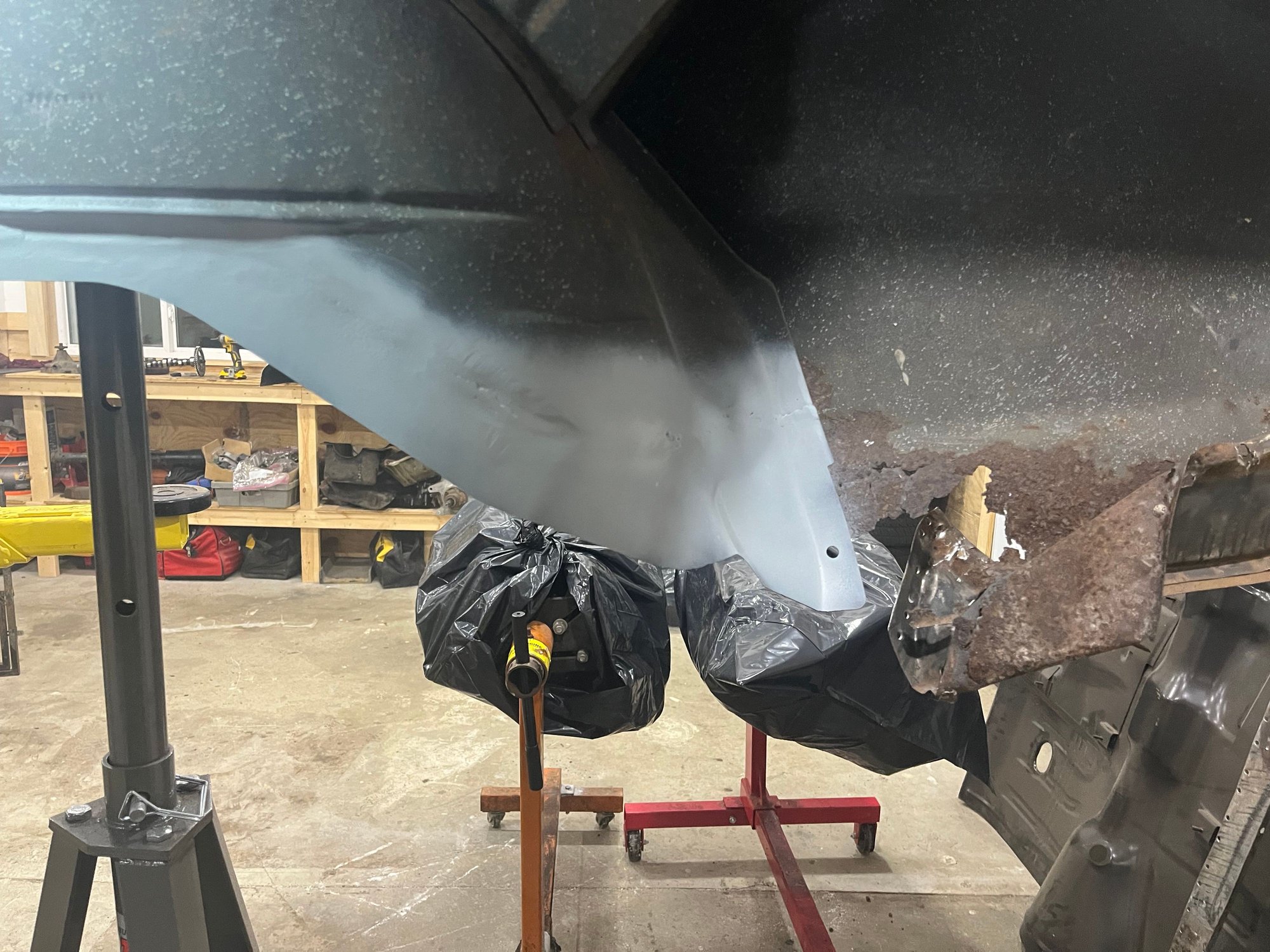

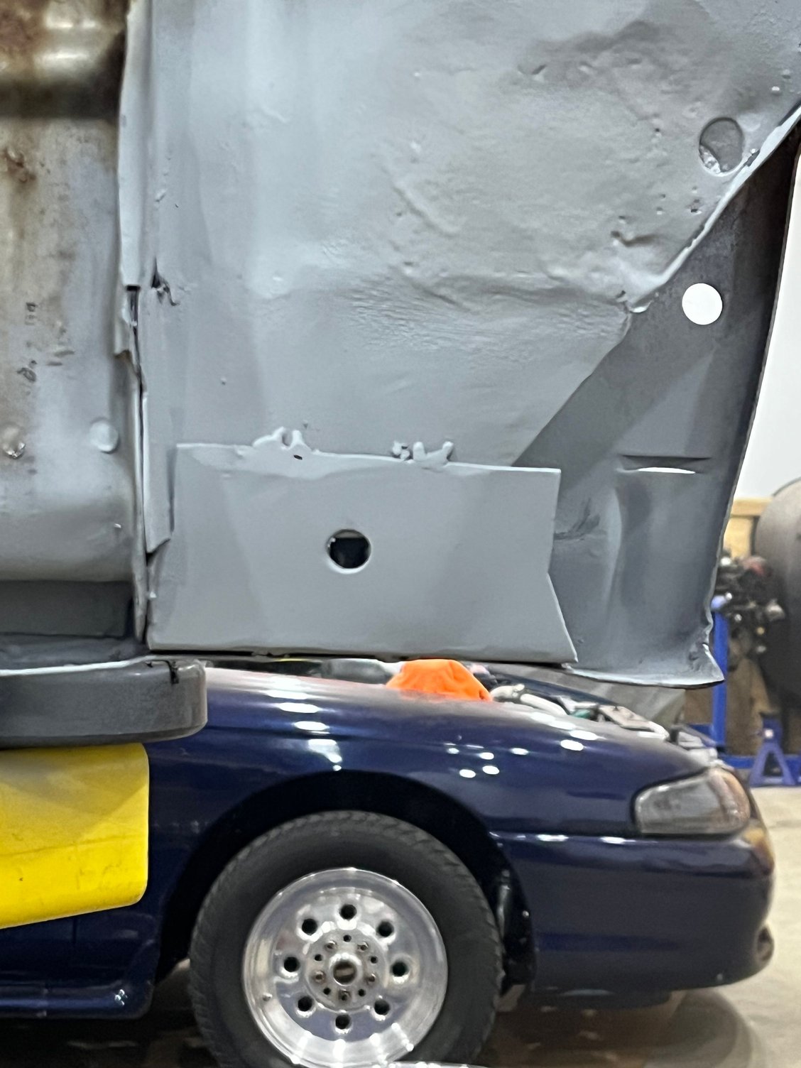

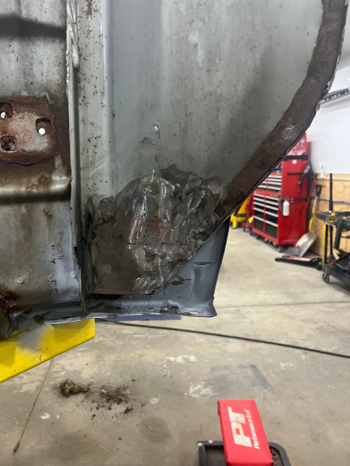

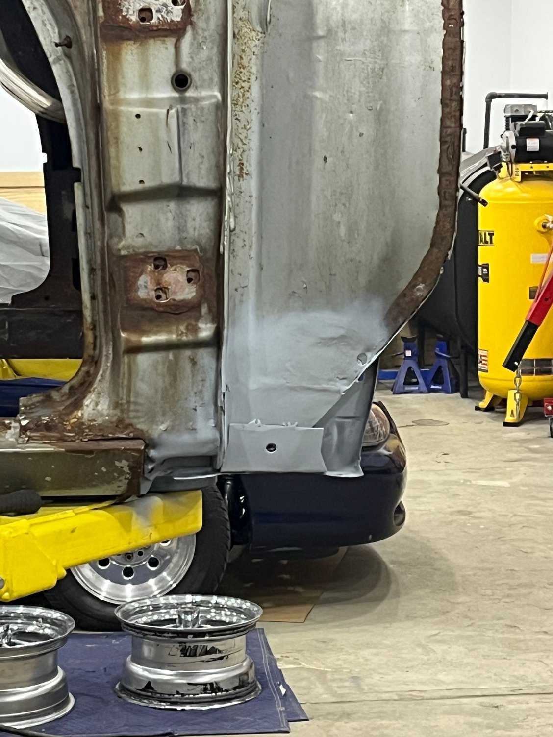

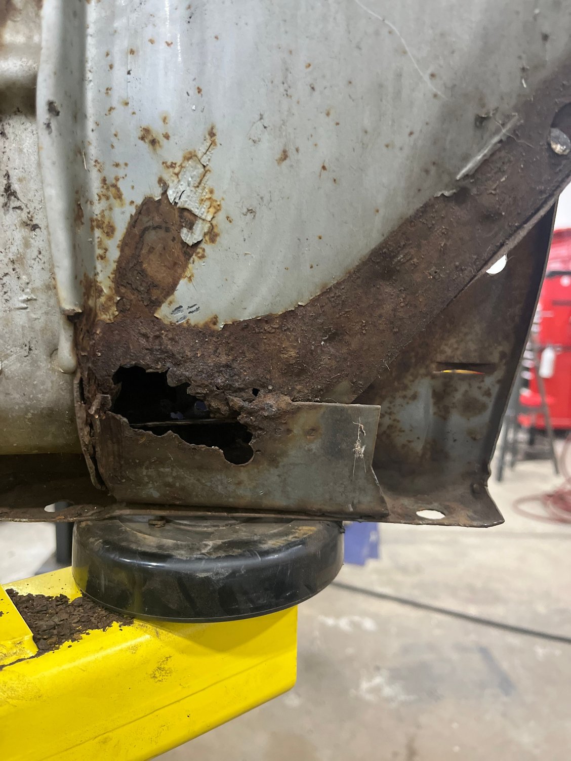

Some updated pics of passenger side lower cowl that I patched this weekend

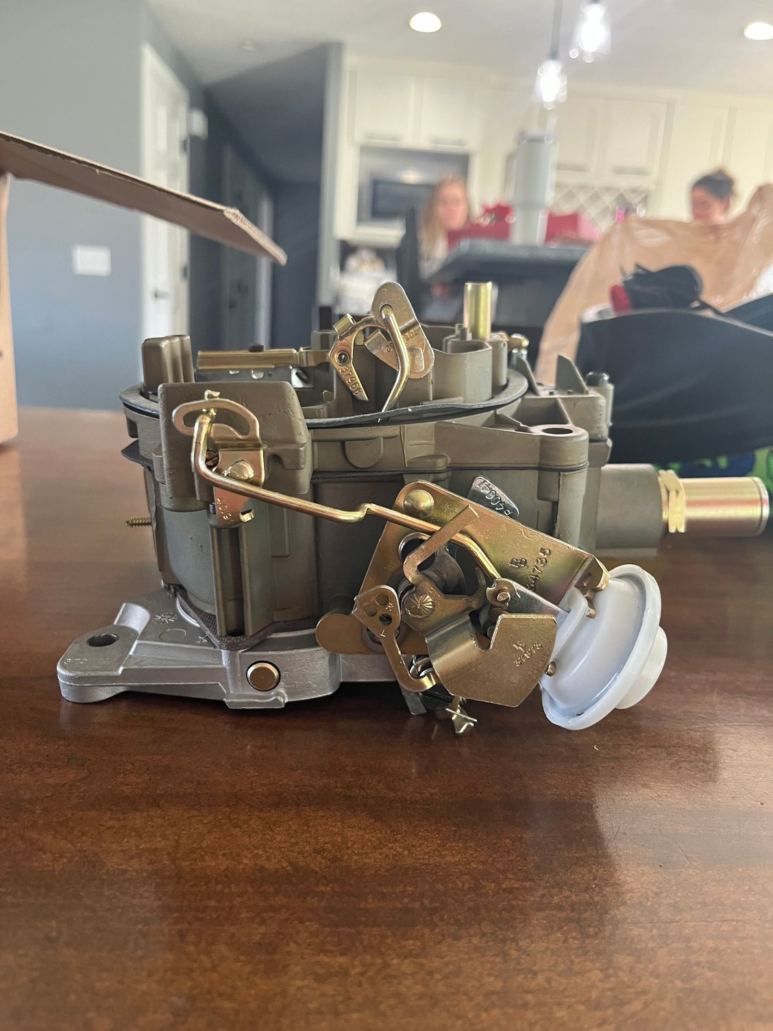

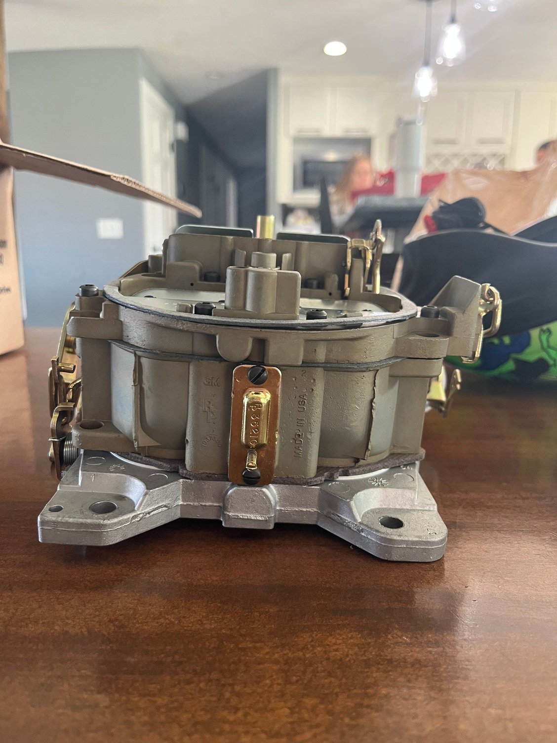

I sent my carb out to get restored and got it back on thanksgiving here’s a few pics

Who did the carb?

Chris’s Carb Shop in Dayton Ohio, they do distributors too. They re doing my distributor I’ll have pics when I get them back. I’m currently looking for a NOS cam part number 402569 if anyone knows of one for sale
Be aware that the #402569 is the very "healthy" 328/328 cam.

Yeah it’s the cam that came with the car and I really want to get as original as possible

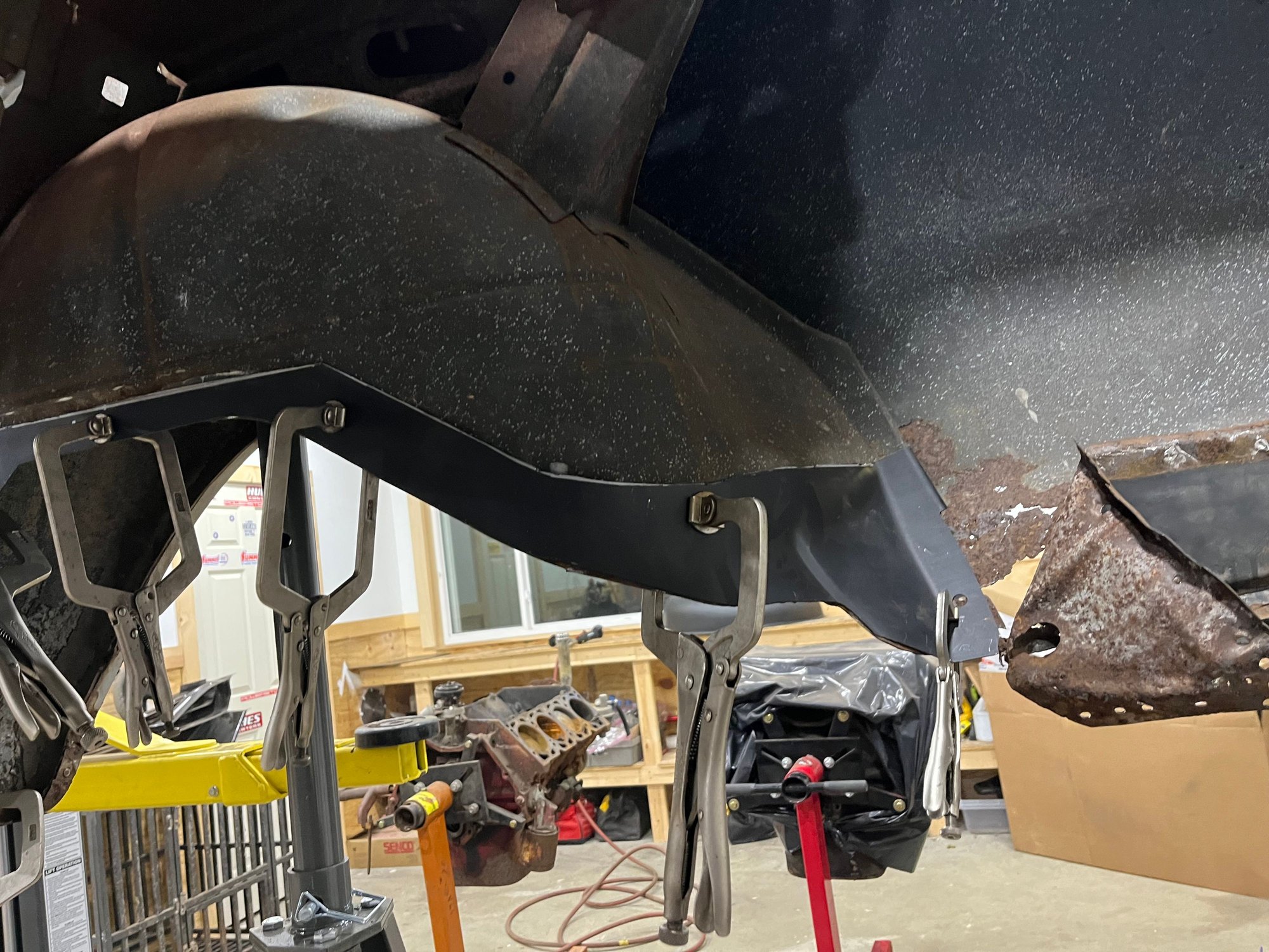

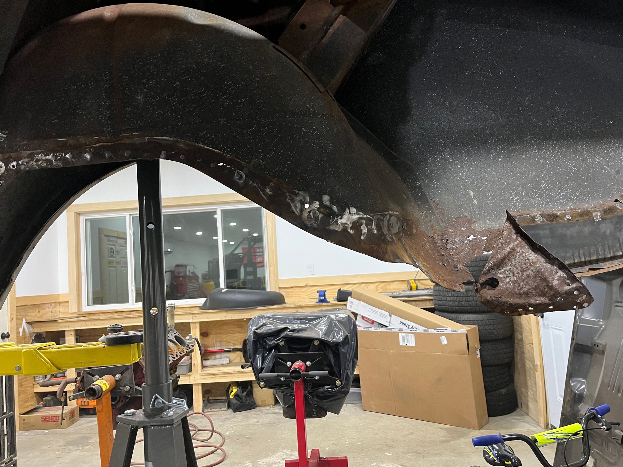

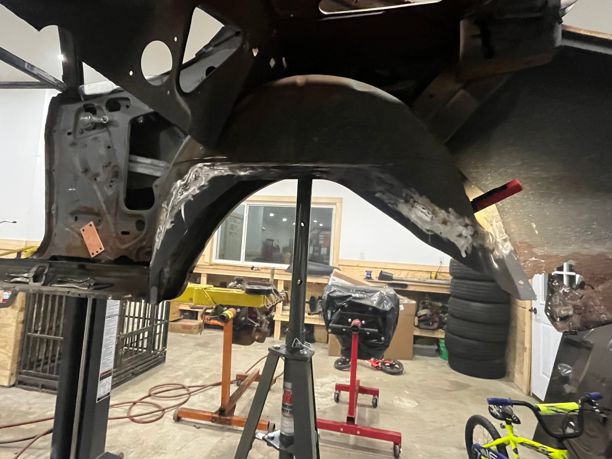

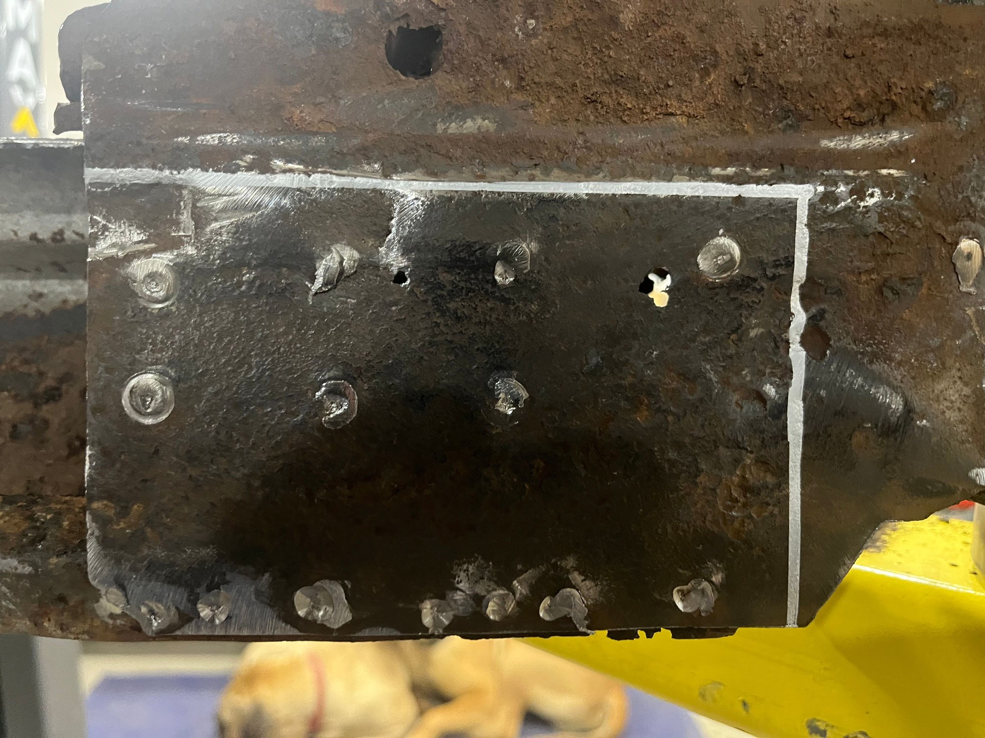

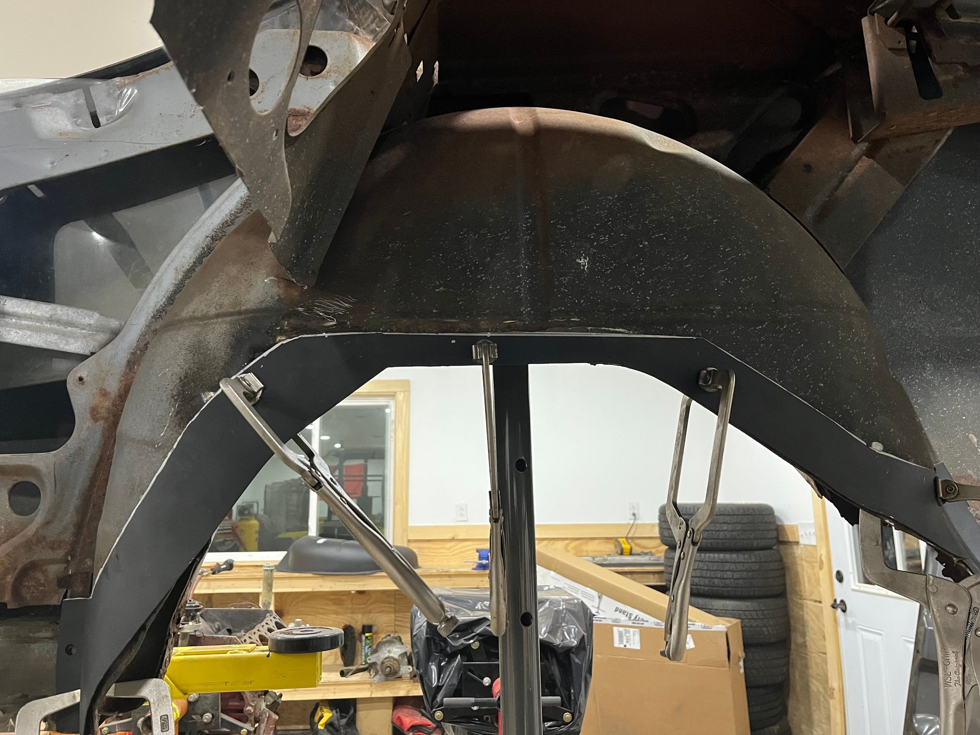

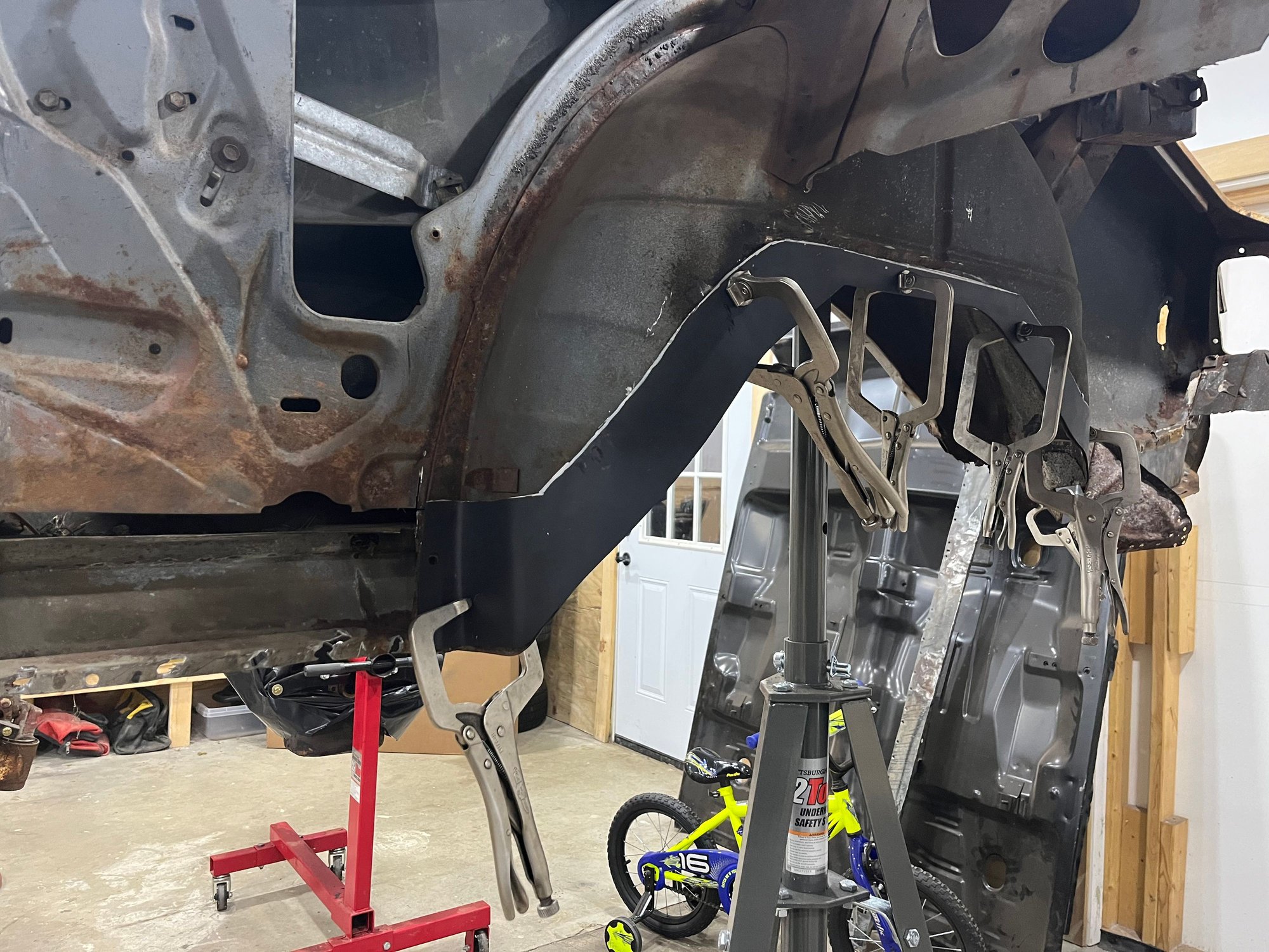

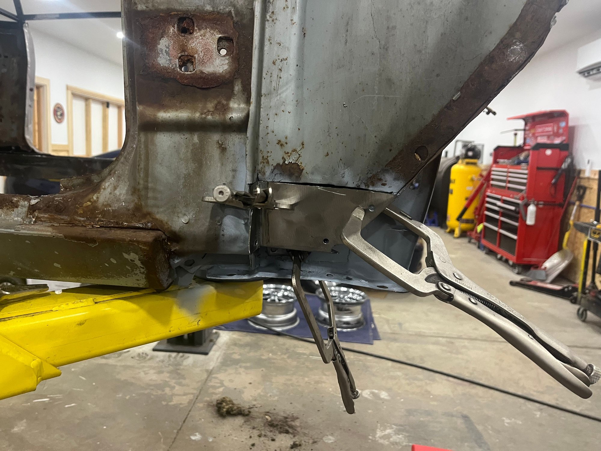

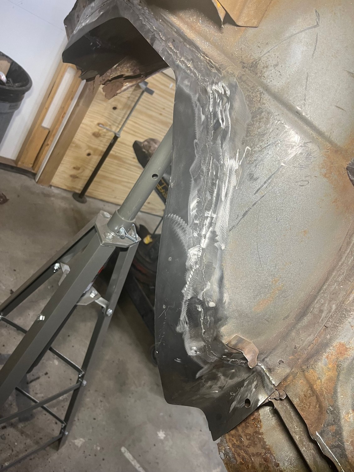

Couple update pics, passenger side lower inner wheel well was rotten so i cut it along the line of where the trunk and the floor tie in so it’s not noticeable. I would have never tried this project if it wasn’t for my friend Steve. He’s doing a 69 W31 on you tube and I reference a lot off his videos.

This is like doing an early Mustang, they were notorious for rust. Looking forward to seeing up dates.

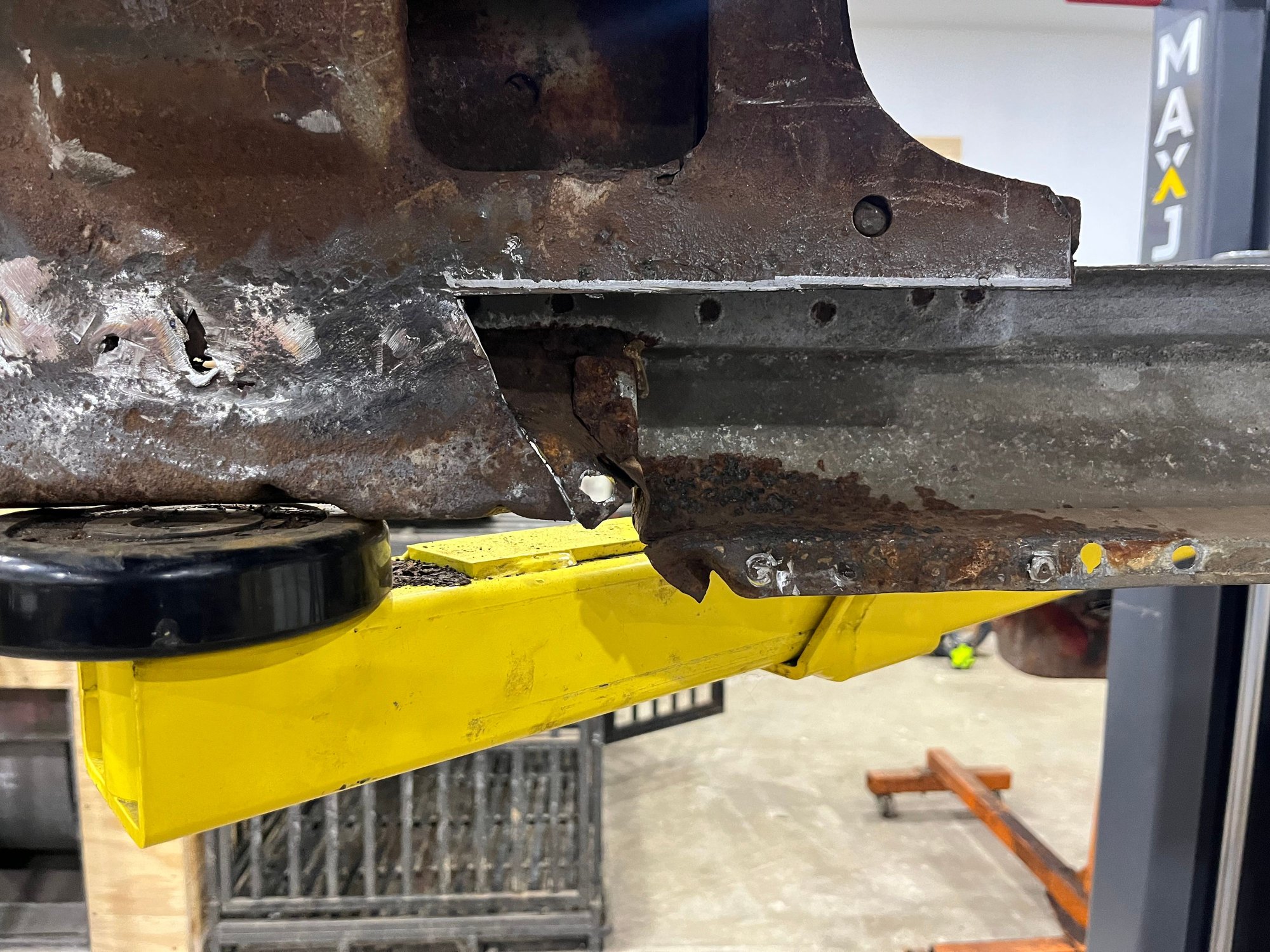

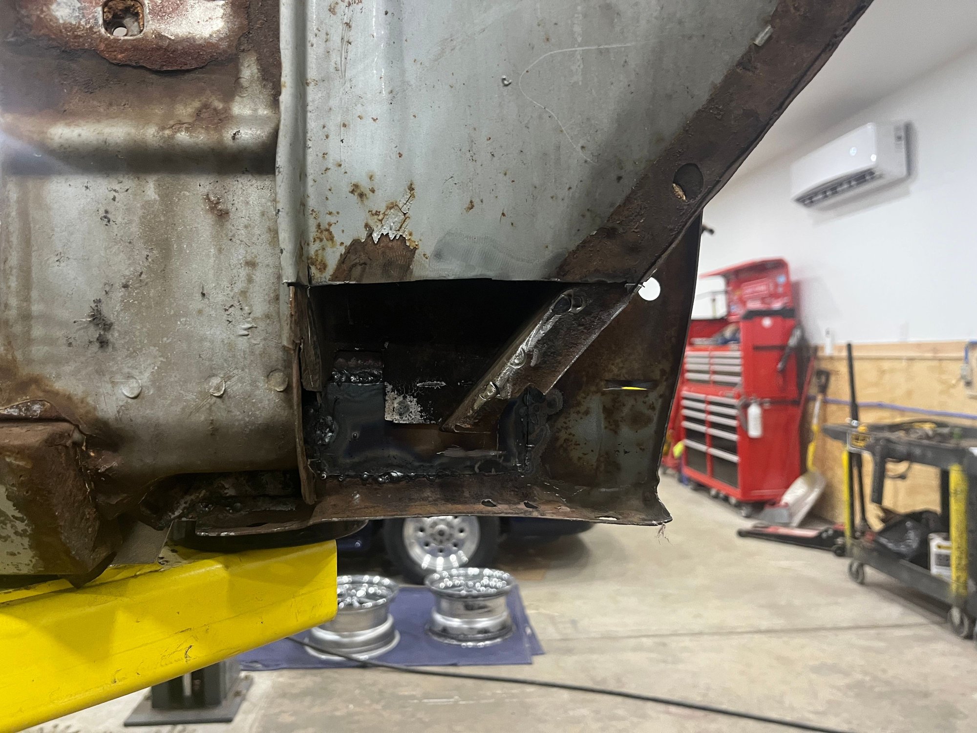

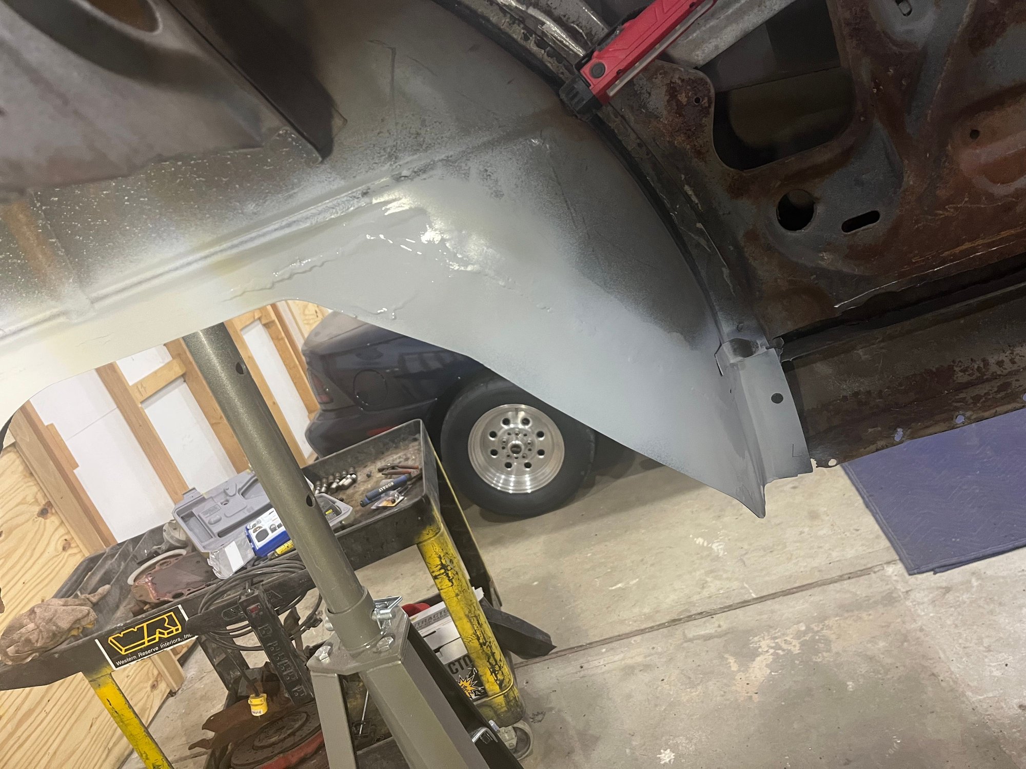

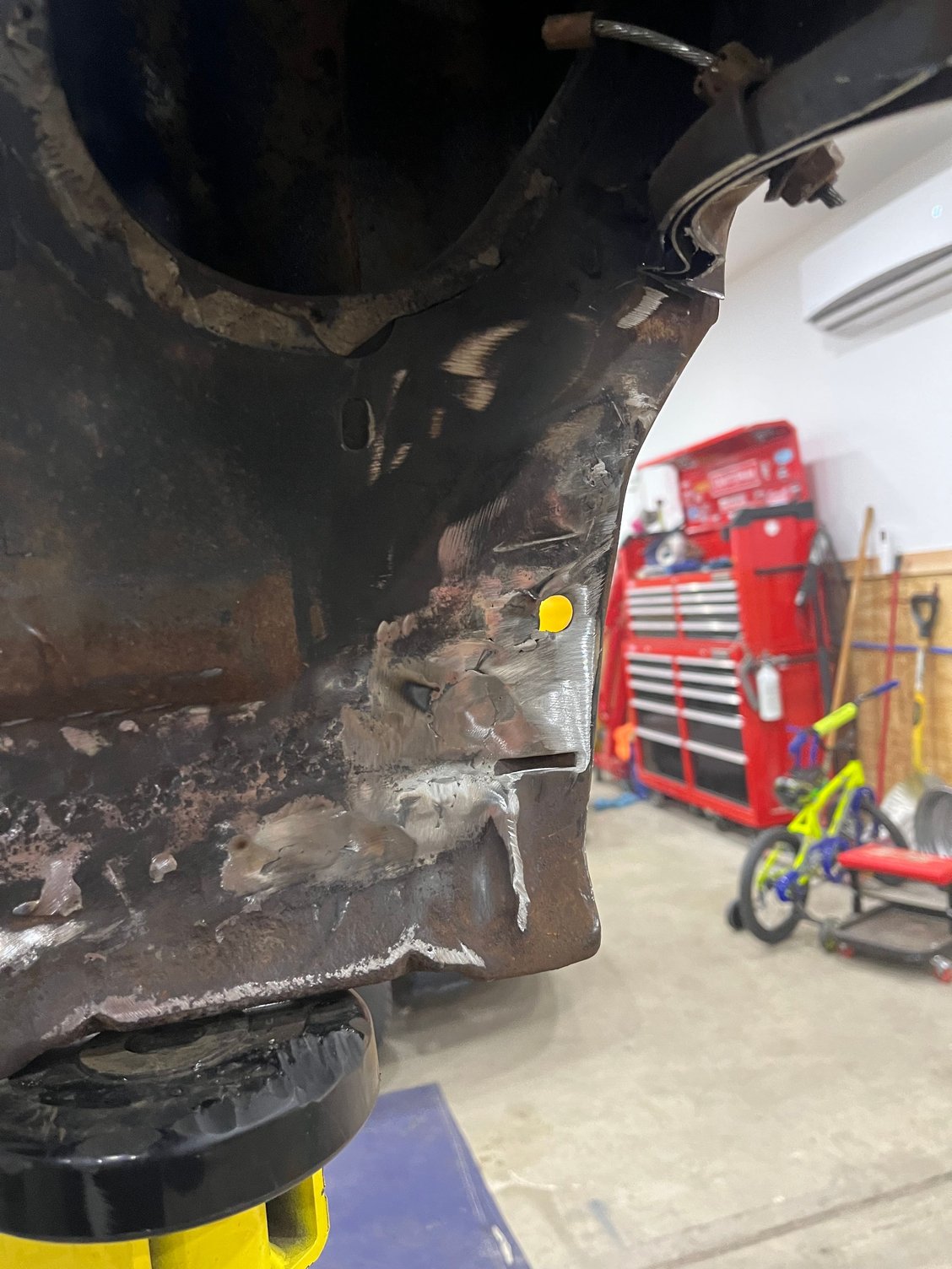

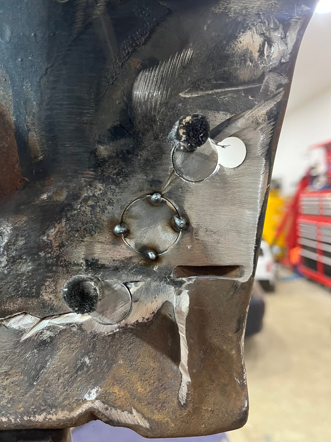

Quick update, removed driver side inner rocker and cut the rot and patched in new

How do you like that "MAX JAX" lift? I'm thinking of getting one myself.
I will be following along on this project,.....you have my attention

I love the max Jax no more crawling around on the floor, gets the cars up 55 inches off the floor. I did have to cut concrete out dig down a foot and repour the concrete

Quick update, i got the rear driver side inner wheel well patch. And got my inner rockers patched up and straightened out also got them prepped on my floor ready to mock up. Over the weekend we made another trip out to Indiana to buy some more stuff off of Ron. And i also bought a bunch of parts off Dave 442 in California,those parts will be shipped soon. Without those 2 guys I don’t think I could do this project they literally have everything i need for my 69s. I’ve purchased a lot of NOS parts for this car this year for example quarter panels, outer rocker panels, grille, headlight bezels, all the badging for the car, window cranks, door levers, all NOS. But I’m currently looking for NOS tail light bezels if anyone knows of any for sale.
