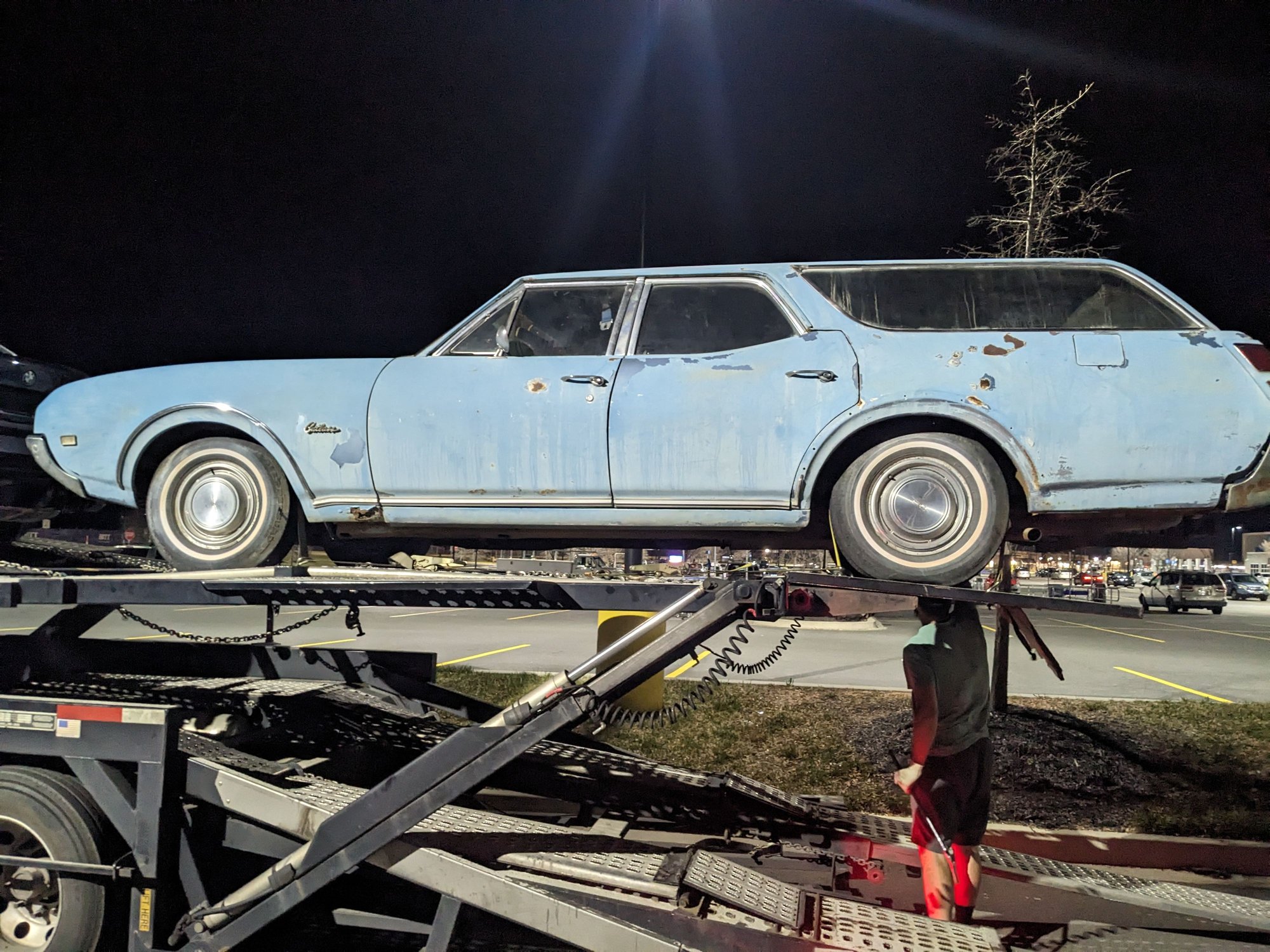

Car arrived at 11:00 last night. The shipper was adamant that I have to take it in the dark, which I protested but I didn't have a lot of leverage on a Saturday night. Picked it up in the local WalMart parking lot. On the plus side, they did deliver eight days after I signed the shipping contract and made it from Phoenix to just northern VA in 2.5 days.
Now to inventory what it needs (everything...). Sketchy brakes, ancient tires, no e-brake, dead battery, crispy interior, shot exhaust, non-functioning interior lights, and in need of a serious tune up are the obvious things. Definitely lived a lot of time in the desert. Car did start right up with a jump box and I drove it around the lot and onto the trailer, so that's a rarity for most of the crap I drag home. Cursory look under the lights shows no obvious body rust except for the front fenders, and I already have the patch panels (second gen parts made from new dies - much better than the ones that were previously available for the 68-69 cars). Unfortunately I have a meeting of my OCA Chapter today, so I won't get an in-depth inspection until later. The new box of stainless mandrel bends already arrived and the Walker mufflers are on the way. Special shout-out to flemming442 for the 15x7 wheels. Now to find two more. Dog dish caps are also on the way.
I should add that up close, the side trim really does not spark joy. It would go even if I had all of it.
joe_padavano is offline

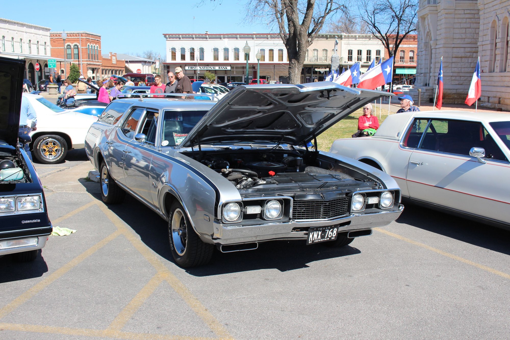

This 68 used to belong to a member of NTOC who built it from a wagon that came out of a field. He sold it several years ago and I believe it went to Oklahoma.
redoldsman is offline
A friend of mine has a 69 that is similarly done up. His was a factory 350/4spd car that his family bought new. Currently a 455/4 spd.

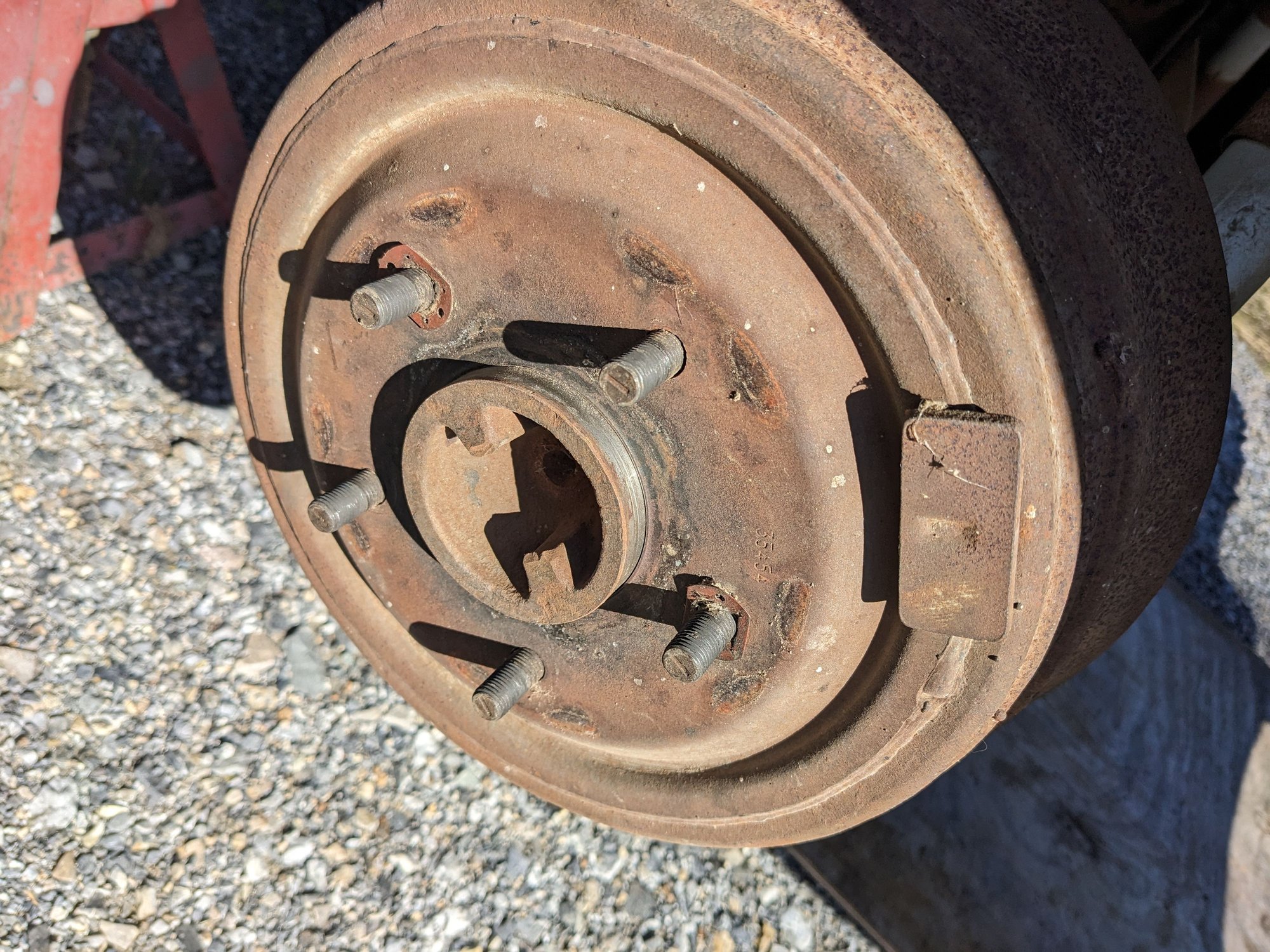

I absolutely HATE GM pinchwelds. Two NV desert wagons, two cases of pinchweld rust. Note the amount of silt behind the stainless trim around the rear quarter windows. I knew there was evidence of water leaks before I bought it. Fortunately, most of the leaks appear to be coming from a loss of adhesion between the urethane and the metal. Unfortunately that loss of adhesion is due to scaly rust on the pinchweld flanges. I won't know how bad that is until I get the glass out. Hopefully there's enough metal left that I can just media blast, prime, and re-bond the glass. There is one hole that I've found so far, though at least that repair will be hidden by the trim if the swiss cheese doesn't extend out too far.
In other news, the car still has the original bell-mouth rear drums and two-piece front rotors, and all appear to be usable. I hate to say it, but since this car will be a driver, I'm swapping these parts for new replacement drums and rotors and keeping the good parts for my 69 H/O.

The brake drums have never been off of the car.
Hairy Olds is offline
Old March 25th, 2024, 08:27 PM
  #73
Bernhard's Avatar
Join Date: Jul 2012
Location: Vancouver BC
Posts: 2,807
The mechanic may have reused the retainer.
^^This. I also originally thought the drums had never been off, but once I removed them there were brand new Raybestos 242 shoes installed. Clearly not factory.

I had the exact same corrosion on my flattop that had spent its time in Los Angeles up to my stewardship. I had to fabricate some metal patches for mine and also had to put a small patch on the fwd side of the wheel arch as well due to water accumulating inside the body. We still don’t have a fraction of the grief that Vista owners deal with. The photo of Aron’s car looks to be at Sweethearts and Orphans at the Weatherford courthouse. That car was drug out of a farm pasture.

That picture of Aron's car was taken at Sweethearts & Orphans in Granbury.
Old March 26th, 2024, 06:12 PM
  #78
Funkwagon455's Avatar
Join Date: Jun 2009
Location: Aledo, Texas
Posts: 2,413
Yeah, well that’s an honest mistake!🤣. They are neighbors and both have the same vibe! Thanks for your clarification though Glenn! Come visit us at Pate later this month, we always have fun.

I have to say that it's always a joy to work on desert cars. Front shocks R&R in like 20 minutes. No torch, no cutoff wheel, no broken clip nuts, no muss, no fuss.
