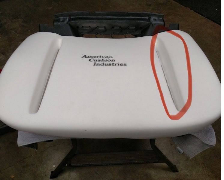

So I have a set of foam from ACI for my 1970 Cutlass Supreme that I purchased through Legendary, and it they don't have any slots at all in it. Is this correct?

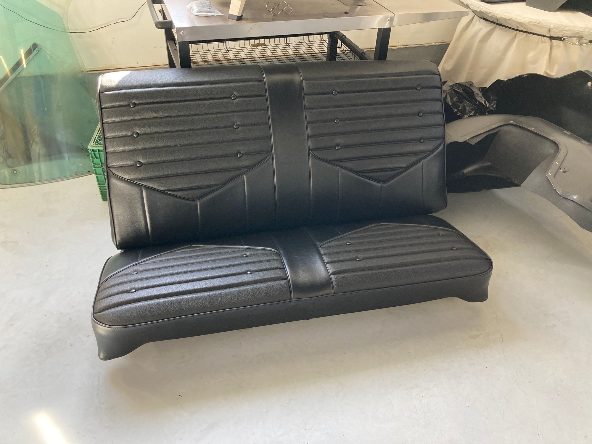

70 should have half slots like the ones in post #13 (notice the "half" listing ribs in Alain's seats in post #12). 71-72 have no slots.
Not all the '70 Olds covers use/used slotted foams. I'm thinking convert seat covers and Supremes didn't/don't have the need for the "pull through" slots. Maybe others as well but I haven't studied it closely.
You can go to Thornton's website and see the breakdown on there. IMO it's accurate.

Good catch. Correct, the Supreme (including all 442 convertibles) used the 71-72 foam as well.
