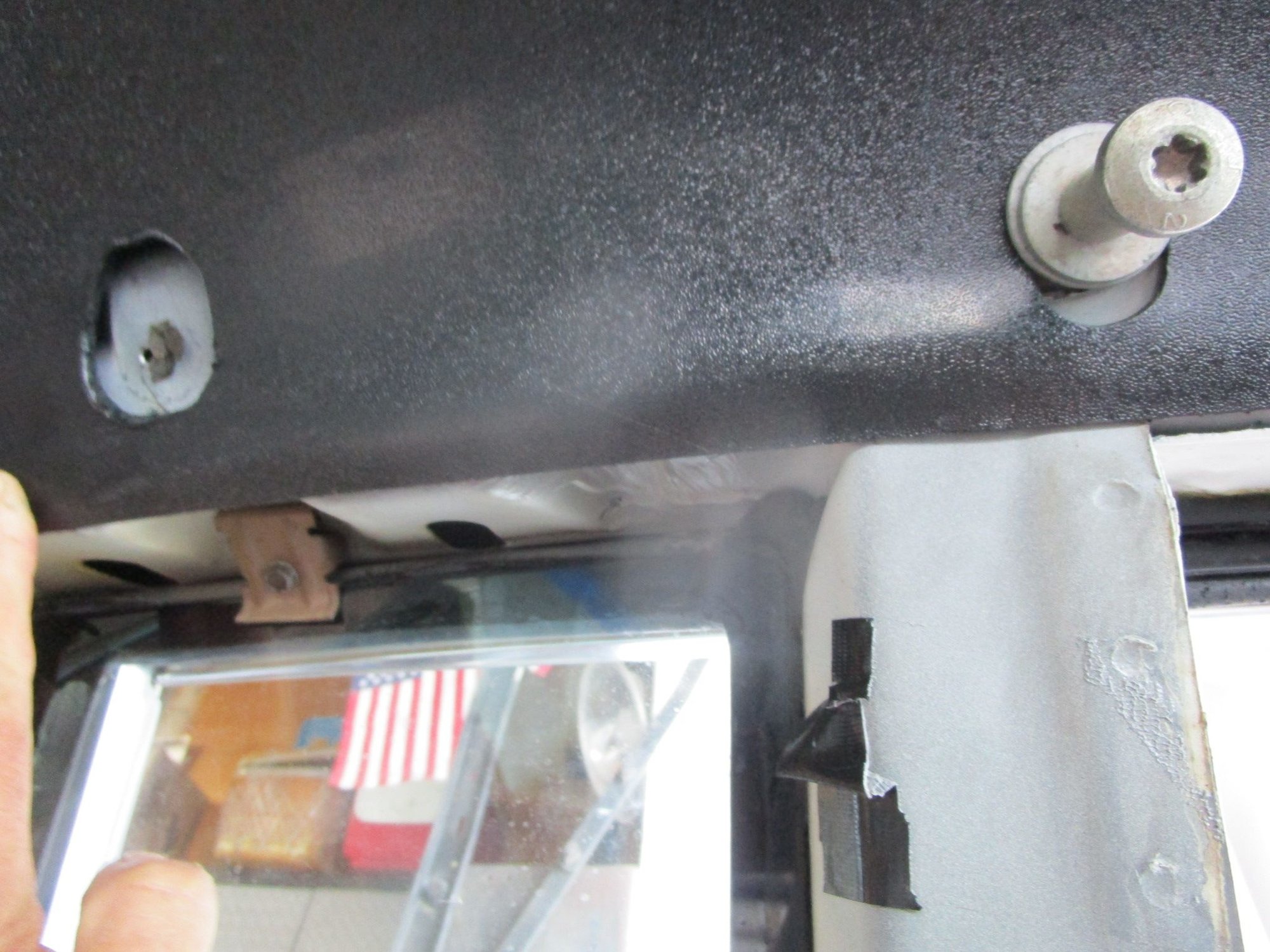

4. I used the driver side sunvisor mounting as a reference to start with. I then used some wide washers with the seat belt screws to hold up the board.

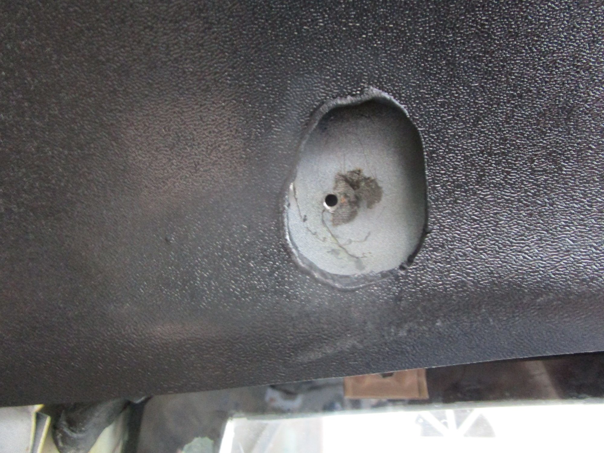

5. I found that the holes for the passanger side sunvisor mounthing was way off. I bullied some screws into the board and into the exisiting roof frame screw holes to hold it up.
6. I got a hot knife and carved out a bigger hole for the passanger side sunvisor.

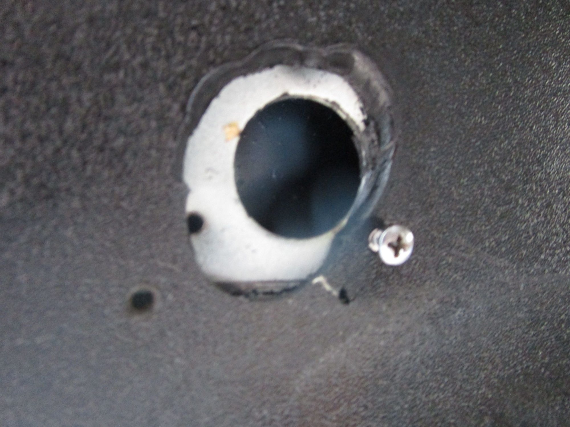

7. I found the driver side coat hook hole was about 1/2 closer to the seat belt screw then the passanger side, Again, I got a hot knife an carved out some material to the left of the premade hole. Then installed the coat hooks.

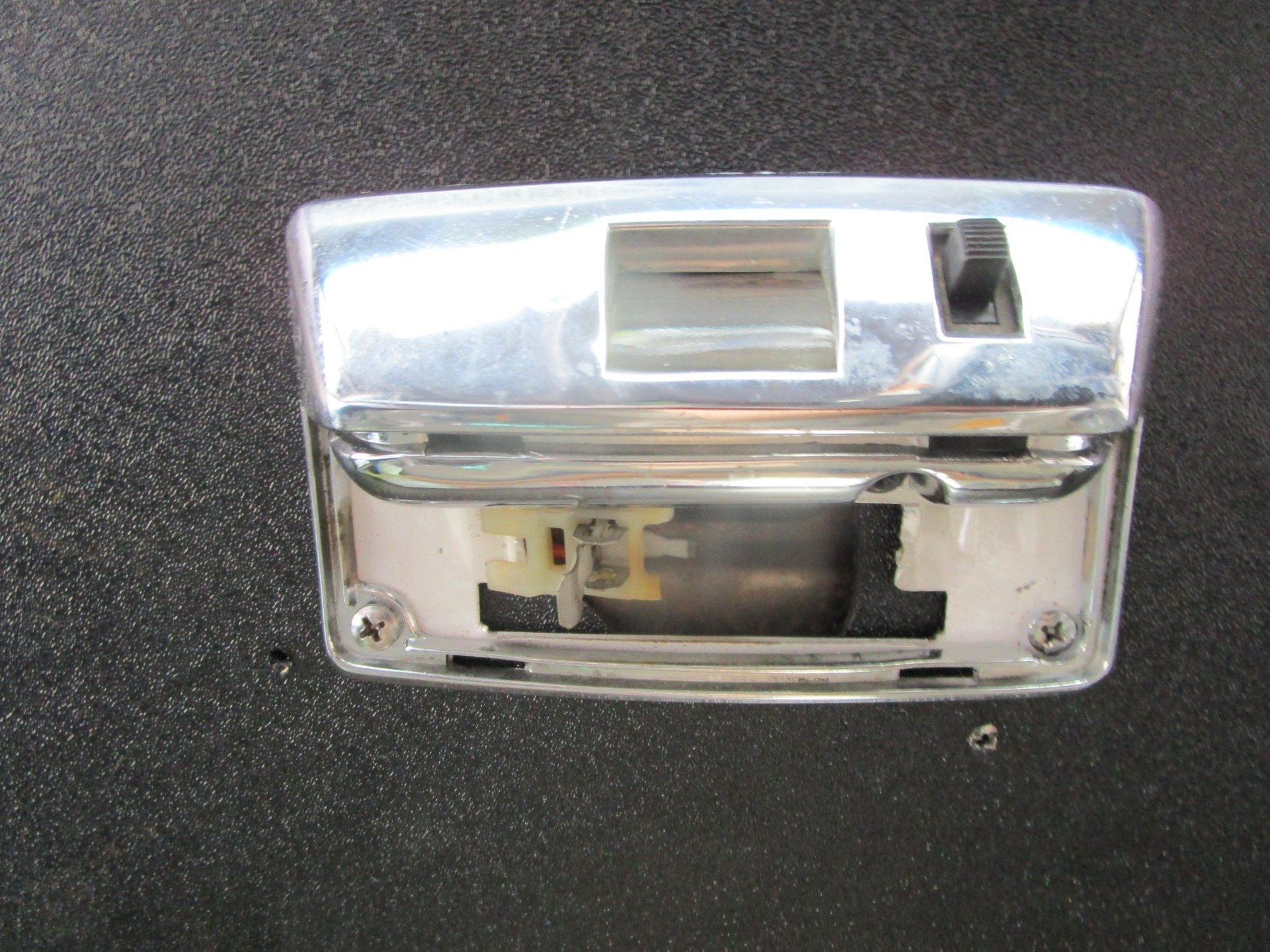

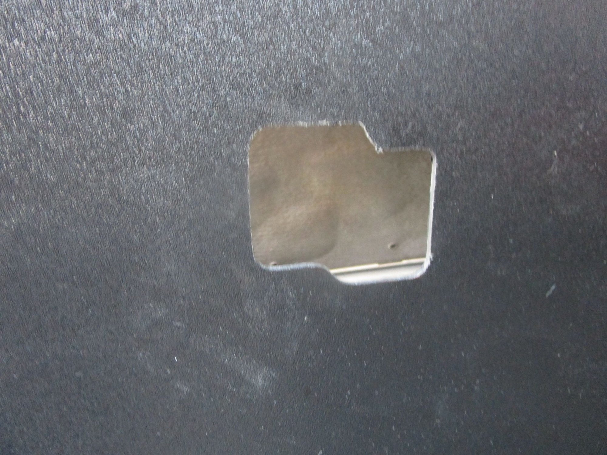

8. The board does not come with pre-drilled holes for mounting the map light. I tried to make a tempalte from my original healiner board to locate the screw holes but found out the map light hole cut out in the Acme board is not the same as the original board. I felt around from the back and bullied the mouting screws through the board and into the roof frame screw hole, took them out and then mounted the map light base.
