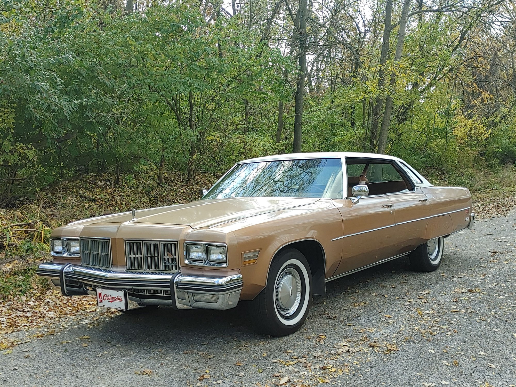

Well after eight months I've finally found myself a '75 Regency and joined the club!
It's a moderately optioned '75 in Canyon Copper, with Tempmatic Climate Control, Cruise Control and an "Anti-Slip" rear end to list a few of the big items. It's completely rust free (thanks to the thorough Zeibart application it has) and has all of the original paperwork from the window sticker and dealer order sheet to the manual and maintenance schedule.
Now it's not perfect (what almost-fifty year-old car is?) The clock doesn't run anymore, the horn button in the steering wheel doesn't work and dome, hood and trunk lights all don't illuminate, but that is all fixable (except maybe the clock) and there's nothing major wrong with it and it's been very well cared for.
I paid a little more than I would have liked for it ($8,000), but I honestly couldn't be happier with my purchase.

WOW that is a clean 98! Very nice find and congrats! Those are all minor things to repair. Start with the obvious like fuses for the horn and lights and clock too. The horn relay COULD be bad but I don't think I've ever had to replace one on my own cars. You could just have some dirty contacts. The clock can 100% definitely be repaired and it's easier and less expensive than you may expect. These guys are awesome so give them a shout. http://www.clockwks.com/Servicex.html. They did mine years ago and it's still keeping perfect time. How many miles on your new 75 98 Regency?

Mileage is currently sitting at 95228, though you certianly would think it's less with the consition it's in!
Wow, now THAT is a clean '75 98! Same color as mine, except I have a dark brown vinyl top. It looks like someone has some aftermarket audio in the trunk.
I'd say 8k isn't a bad price at all, especially in this market. It appears to be rust/rot free. My car was much less, but it was also severely neglected and and needed some work to make it a good driver. Now, it's being hacked apart to make it faster, more reliable, and ridiculously fun. Check out my build thread in my signature.
Congrats on the purchase! If my car was in that kind of shape, I'd just enjoy it as-is.

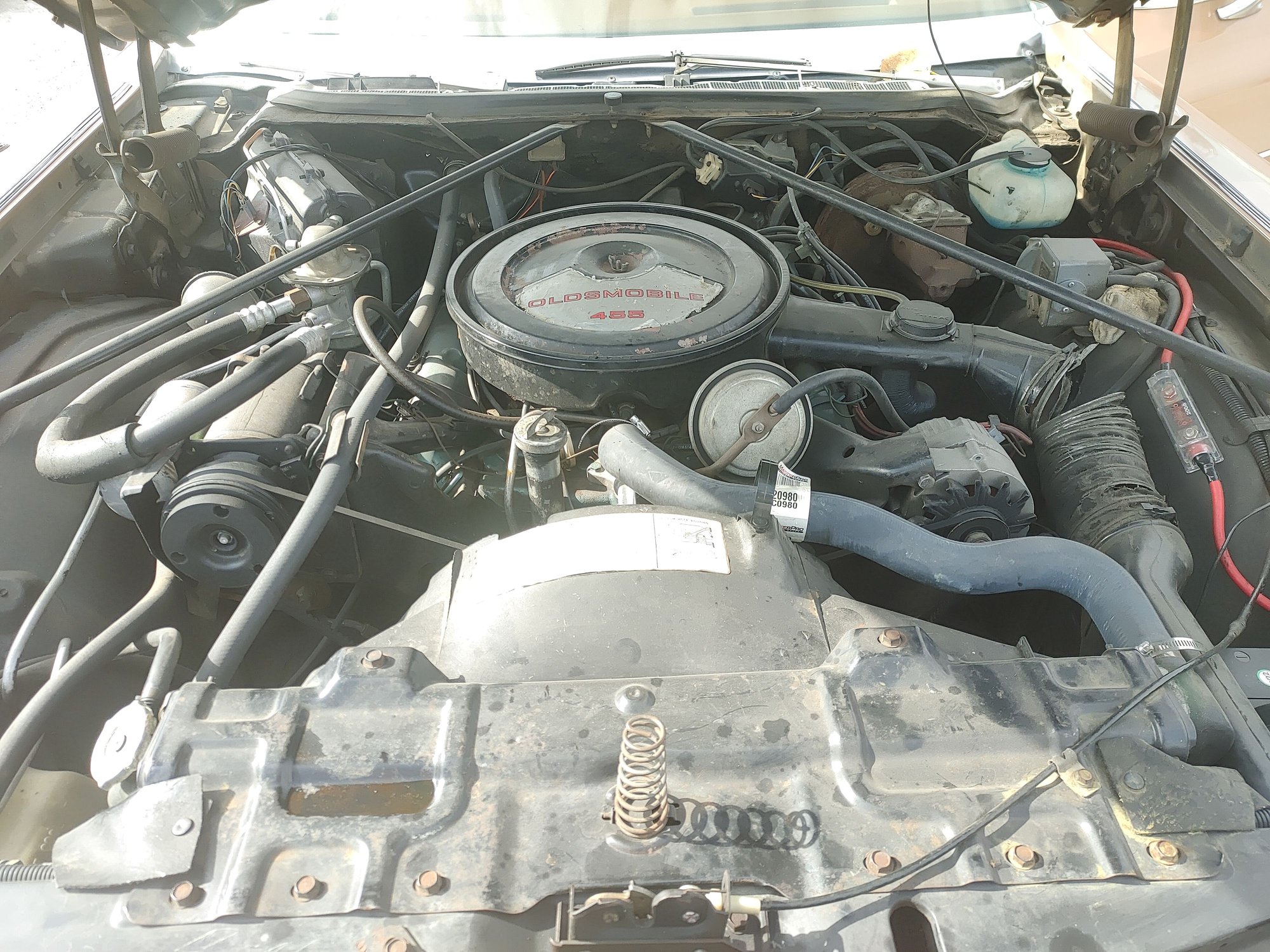

More pics will be coming! Currently sitting at 95228 on the odometer.
The fuses are all good. The clock I'm sure is a stripped plastic gear (thanks for the heads up on that company!) The horn seems to be the buttons in the steering wheel as I managed to get it to blow for half-a-second by pressing hard on it. As for the lights, it has to be a break in the circuit somewhere as pulling the fuse disabled the working door lights as well and none of the bulbs in the effected sockets are blown.

As for the pics, the car looks awesome and like it was well care for so you scored nicely! I noticed a few things so I'll offer some help. Is your washer jar broken or is it just the picture making it look that way to me? Your front speaker grille was either cut to fit a bigger speaker or it's broken. The stock radio section of the dash cluster was cut to fit the after-market radio. I have all of those parts if you want to repair/replace anything to get it back to original. I have had my 2 76 98's for a very, very long time so I know these cars very well.

Alright, it's been a hot minute but man, has there been a lot of "little repairs" carried out this past month. In no particular order I've...
- Replaced the passenger-side wiper arm (who thought encasing the pin in plastic was a good idea?) and both wiper blades with NoS Chrome Tricos
- Replaced the blower-hi relay
- Replaced the "accordion" air intake with a NoS Dorman hose
- Fixed the horn button contact
- Replaced the broken headlamp adjusters and re-adjusted them
- Replaced the three u-joints on the driveshaft (no more squeaking!)
- Changed the oil, oil filter, fuel filter, air filter, PCV valve and greased all the joints in what was probably the first time in a decade for this car
- Fully flushed and cleaned the cooling system and changed the coolant
- Ran three new wires (orange, white and light-green) to bypass breaks that were somewhere along in the wire loom that runs from the front-body connector to the rear-body connector, which in turn fixed my dome / map lights AND my non-functioning reverse lights (that was embarrassing to be stopped over for)
- Found the hose for the passenger-side lap-vent under the seat (as well as three Bic lighters, a bottle-opener, bottle caps and a pair of crushed Aviators) and put it back on
- Removed the stupid, over-sized speakers from the dash and re-connected the hose for the Tempmatic's aspirator so it will actually control the air temperature again
- Pulled the aftermarket radio and its harness (which was wire-nutted on...) and marked the wires from the factory harness
- Pulled the aftermarket speaker / remote wire runs that were made
I've done quite a bit, but as is the case, there's still quite a bit more to do, such as...
- Fix the blower low-speed position (as of now it just shuts it off)
- Fix the washer fluid pump (honestly I may just hold off on this until I upgrade to pulse wipers)
- Fix the broken-mounts on the lower dash piece (it was never fully re-installed with all of the mounting hardware, presumably when the radio was put in and as such, they've broken off in driving)
- Fix the seat-belt warning buzzer (it looks like someone removed the plug from the shifter switch and pulled the buzzer out)
- Change out the brake pads / shoes, drum hardware and flush system out with fresh fluid
- Get the dang clock fixed! It can't stay 1:20pm forever....
- Sort out the radio situation
Thankfully, outside of the wiring mess that was made putting the aftermarket radio in, there hasn't really been anything else majorly bunged up, just some issues here and there that are expected with age.

Dang, that is a nice 98! Out of curiosity, what options was yours equipped with?

Thanks! I don't have a seat belt buzzer either. Wonder if that stopped with the interlock going away after '74? Mine makes no noise or light if the belt is unbuckled.
Off the top of my head,
Cruise, tempmatic, fuel economy gauge, AM/FM/8 Track, rear defog, windshield antenna, power driver and passenger seat. Probably forgetting something.

Well it's been one hell of a month, but not even a dead transmission could keep me from driving my Regency!
For those curious, early this past december when driving home, I merged onto the highway and immediately noticed something was amiss as my even though my RPMs were climbing, my speed was not. Well, pretty soon I made the startling realization that I was not shifting out of first! I put on my hazards and crawled my way home. Over the next few days I did everything from changing the modulator valve checking vacuum signals (a strong 17 PSI, all good there) to dropping the pan and changing the fluid and filter but no matter what I did, the transmission would not shift out of first. After exhuasting all of the "easy" fixes, I decided to siphon some of the trans fluid back out. Despite changing 6 qtz of it a day prior, it was almost pitch-black and smelled heavily burnt. My transmission was officially dead...
...but of course I didn't just leave it that way! Thankfully there are a few mechanics in my family, and while none of them knew how to rebuild an automatic transmission, one of them did know an elderly gentleman they worked with a few times who, despite being retired, still rebuilt transmissions out if their shed. The following weekend me and my old man put the Olds up on his left and got to work pulling the transmission and lugged over to be rebuilt.
It was about this time with the transmission out I noticed I was leaking oil from the pan seal and decided I should probably change it. I also decided that if I'm pulling the pan then I should probably change the rear-main while I'm at it. After all, how hard could that be? Extremely, As it would turn out. While there wasn't much remaing of the original pan seal (it was so far gone the bolts had loosened and weren't even hand tight) and what did remain was so thoroughly cooked onto the block it took me two days with a hammer and chisel to remove it, with lots of sanding needed after that. Nevertheless, it I finally managed to get it clean and smooth.
After the pan seal was death with, I turned my attention to the rear main. I pulled the cap off and removed the old rope seal and immediately set to struggling for the next four hours trying to get the new one fed in. About an hour after loosening the other caps and lowering the crank to give me more space to feed the seal through, I finally had a moment of clarity and thought that maybe, just maybe, I was given the wrong seal. (Spoilers: I was.) Turns out the seal I was sold was about 1.5x thicker than the original seal. Fed up with fighting the rope seal (and having broke the tool to feed it) I looked for alternatives and found that a Neoprene seal for certain Ford engines would in fact fit the Olds 455 without issue. One round-trip to NAPA and a light coating of grease later, the seals were easily slid into their new homes and all of the crank bolts torqued back to their completely reasonable 120 ft-lbs.
At this point, I still had a good week before my transmission was supposed to be finished and decided that since I'm aready under the car, I might as well clean off the fifty years of grease from the oil pan, suspension components and A frame and re-coat everything with rubberized underbody coating. Fun-fact: Did you know it takes ten spray cans to do the entire underbody of a 1975 98 Regency? Because I sure as heck didn't expect to need that much! I also wire-wheeled the crossmember, driveshaft and starter mounting plate and gave them a nice new cost of enamel while I was it, because why not?
After everything was clean, coated and painted, I re-installed the oil pan with its new seal (and some permatex where the different seals met for good measure) and got it all put back together. I will say having the pan off really re-assured me on the health of the engine. Despite being almost fifty years old and having 96k miles on it everything was extremely clean and there wasn't a single thing out of place, only a slight film of fine metal particulate that had collected in the bottom of the pan.
A couple days later I got the call that it was time to go and pickup my newly rebuilt transmission. While I was expecting to be clean and functional, what I did not expect was that he even painted it for me!
Needless to say I was very happy with the work done and even happier with the what I payed (a whopping $500). I got to work putting everything back together and after another five hours, 5 qtz of full synthetic 5W30, a pint of ZDDP oil additive and 11 qtz of full synthetic ATF, the Regency hit the road again for the first time in over a month and man, does it shift extremely smooth now! Overall, despite all of the frustation and time I sank into doing this myself, I'm very happy I did. I learned quite a bit more about my car and I kniw everything was done right. My only regret that I have from this whole ordeal is that I did not taking more photos! Especially before pictures as the difference underneath is complete night a day. Hopefully the few after pictures I have will suffice, though!
