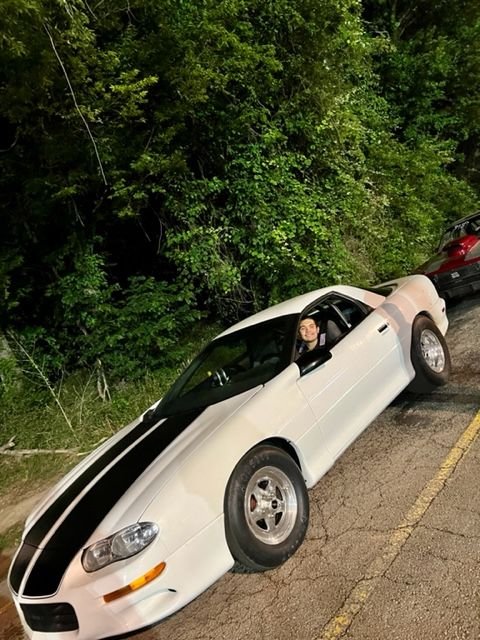

My son was able to get to the track with his 355 Camaro recently, very similar type of build as Copper Cutlass's type of build but the Chevrolet version. His combination used a unported L31 Vortec head, 1.940/1.500 valves, .435/.460 lift hyd flat tappet cam, with a Diamond dished piston. Intake was a Vortec Super Victor with a 750 Holley. Track conditions were: 98 degrees, 120 grains of water, 29.20 barometer, 3200 feet DA, I was very happy with his first outing. Its worth pointing out the Vortec headed 350 can be be a stout low dollar power maker for sure. This fall when he can get into some very good conditions I will report back. 1/8 mile times. BTW running weight is a light weight 3200 pounds.
1.373 60 foot
6.81 660
97.5. MPH
