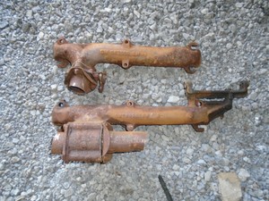

It would be a lot easier to bolt on a right-side manifold, replacing the left one and then fabricate a connecting pipe for both, as long as the rear left sparkplugs are still accesable.
If possible, have the pipe bent so that it runs underneath the engine, with a heatshield between it and the oil pan.
Of course, you'll probably have to cut off the generator's holding bracket, if it gets in the way. A custom pipe from the manifold to muffler or perferably glasspack would also have to get bent.
The only drawback would be sacrificing the heat riser. If you warm up the engine to operating temperature before driving, the heat riser would be rendered obsolete anyway

It is real simple. There is no need to replace or modify either of the manifolds. Order a kit from Waldron's and install it. Little if anything would be gained by connecting the two manifolds together. What you are talking about would probably be impossible to install and would be a big expense for no gain.

Using those restrictive manifols, there is little gain, no matter if both sides get connected at the manifolds or through an X. The thread author posed the question and he got his answer. If he doesen't want to switch to headers, why don't you just let him have his fun with his current set-up? After all, it's his car. Not anyone else's

The original OP never asked about headers and none are available for his car. I never suggested he switch to headers. You are the one trying to complicate this on a car you know nothing about. I have given him advice to achieve what he wants because I have done it on a very similar car. You are correct that it is his car. He should build it to suit himself and nobody else.

Well, you're half right, on that one. Unless someone went out of his way to weld together tuned headers, better than nothing halfway ones were to be had:
