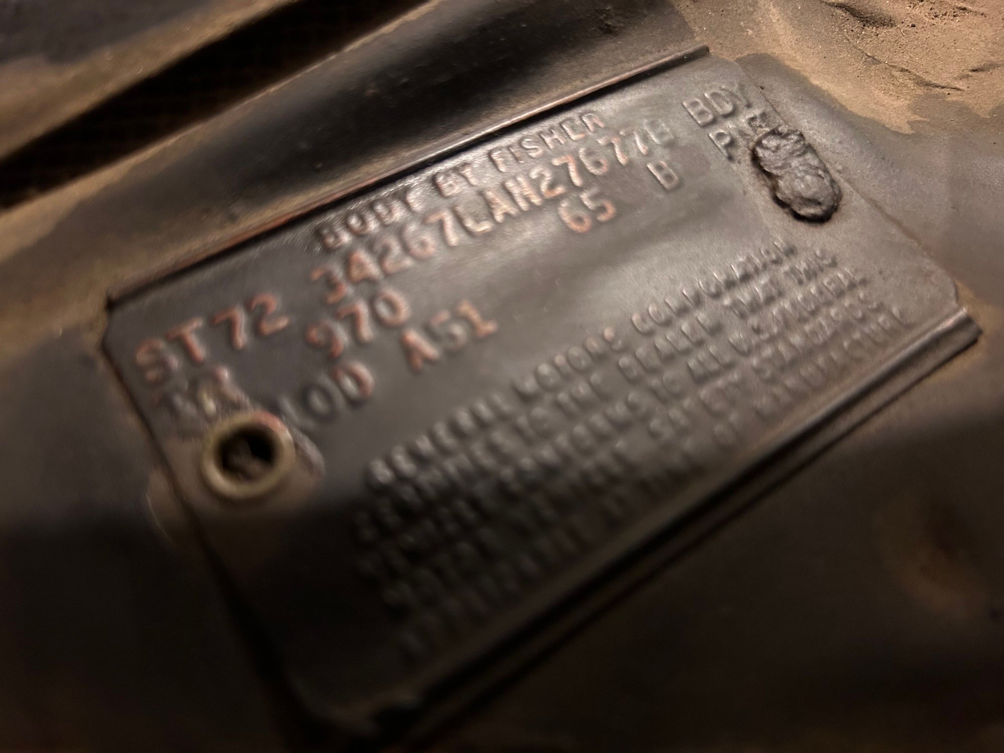

Need help decoding cowl tag and build sheet?
Build sheet is a bit worn unfortunately found it under my passenger floor carpet

From the cowl tag.
ST 72 = 1972 model year
3 = Oldsmobile
42 = Cutlass Supreme
67 = convertible
LAN = Lansing assembly plant
TR 970 = black vinyl interior
PNT 65 = flame orange poly lower body color
PNT B = black convertible top
10D = assembly date = 4th week (D) of October (10), in 1971
A51 = bucket seats

I was curious about the orange color on my 72’ wasn’t sure if it was original to the car or not
