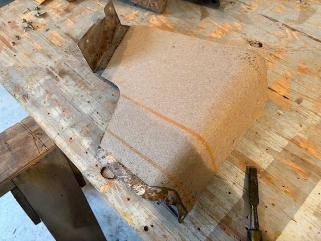

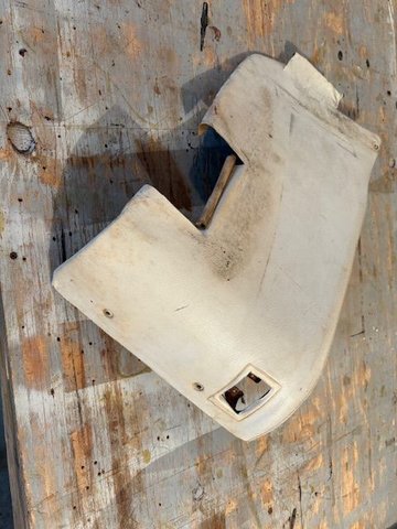

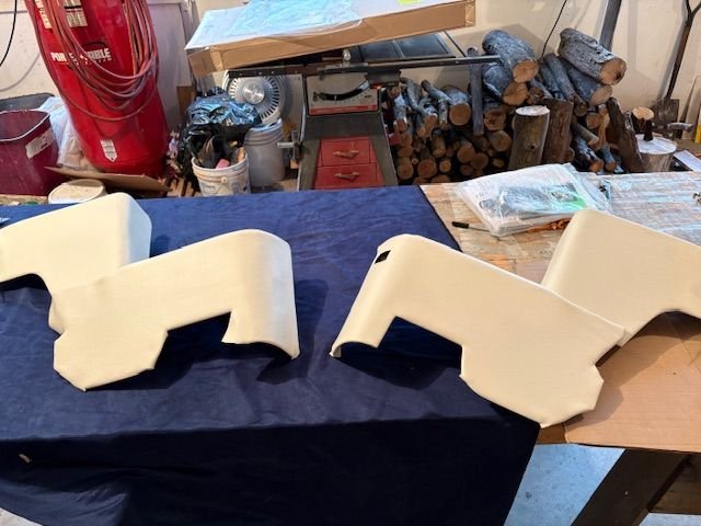

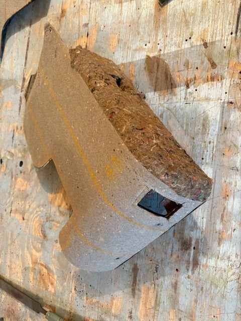

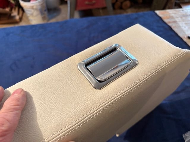

I started on rear seating area armrest/ashwell panels and piston cover panels, first photographing them and then tearing off old vinyl. These covers are bare steel Sheetmetal, I am guessing about 22 gauge? All had surface rust on backside. I cleaned off old glue and then blasted them. Did not prime them, as I didn’t want any issues with glue compatibility. PUI has a great 8 minute YouTube video showing covering an A body rear armrest. I followed that as my best practices. Best tips I learned, are that the surface areas are NOT glued, just the edges of fabric where it is adhered to back sides of Sheetmetal. Other tip is to use 3M rubber and vinyl adhesive. It is hard to find and 50 bucks a can.
Here is where I am at now, Dec 16, 2024

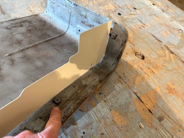

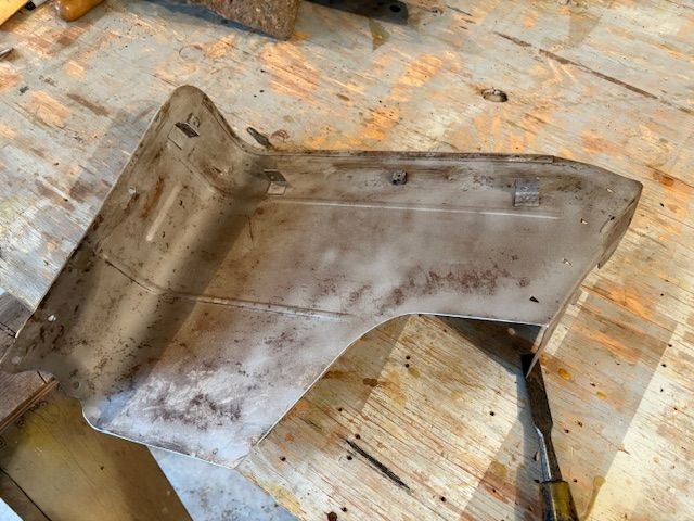

The following 5 pics are after removal of old vinyl and then blasting away most of rust. The old factory applied armrest padding and cardboard like padding was in good shape, and retained
The white Sheetmetal piece at top of piston covers was cleaned up and repainted. Here my finger is pointing to a welded in place square nut, that I have no idea what purpose it is to serve. They make it hard for the new vinyl to go over this area, but that is how the old one was, so I kept them and covered them with new vinyl
Armrest jute padding on top, and cardboard padding on side
Armrest blasted and ready for new vinyl
Piston covers blasted and ready
Front side of piston cover has factory cardboard padding, that was in very good condition
Armrest before removal of old vinyl. This should have been my first pic
Old and newly recovered side by side
Old ashtrays cleaned up very well. A little oil on hinges and they work well
The completed recovery of the Ashwell/Armrest covers and upper Piston covers. Not a Pro job, but acceptable to me anyway.

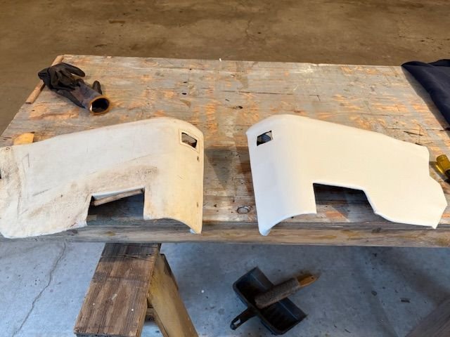

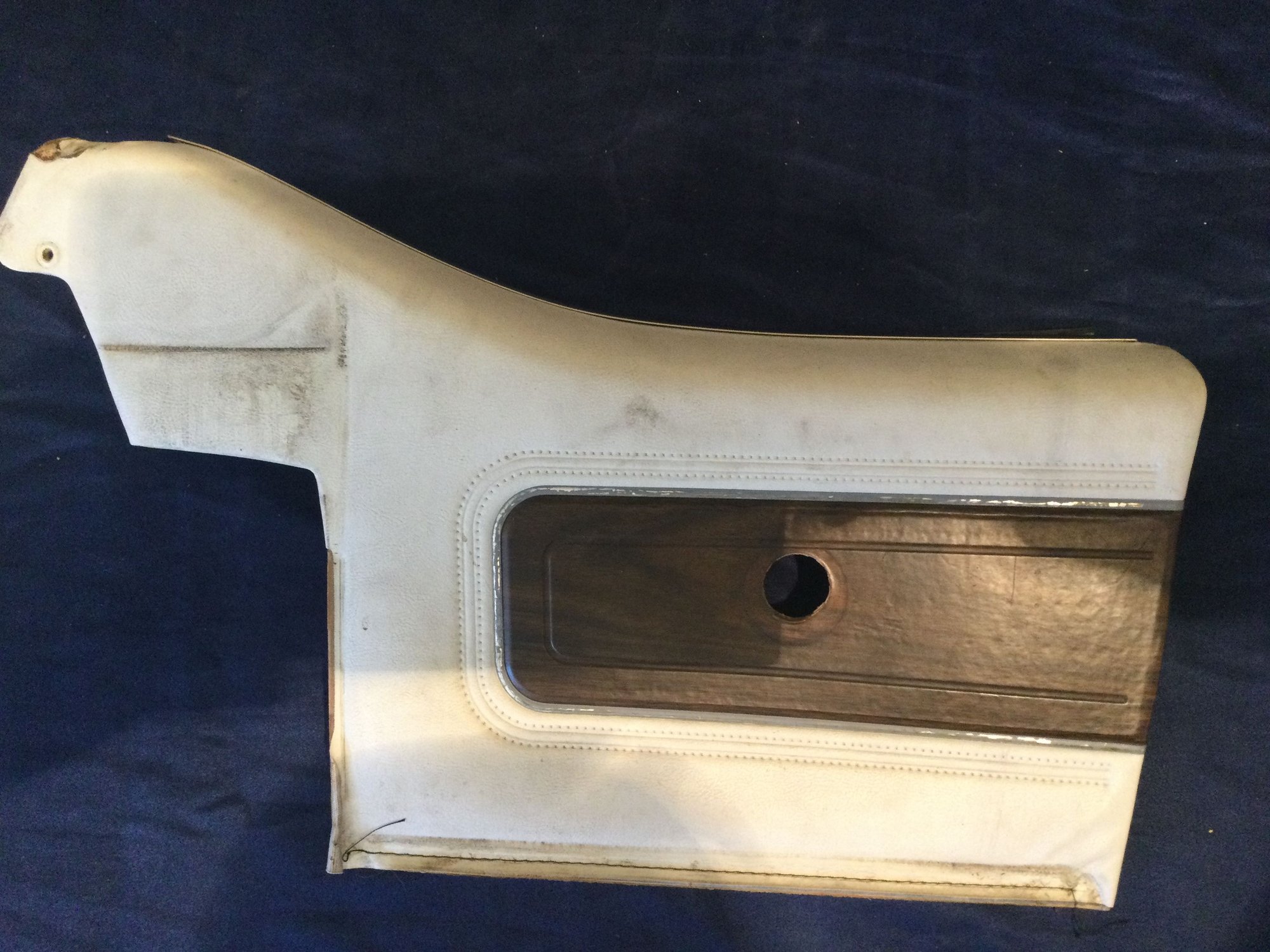

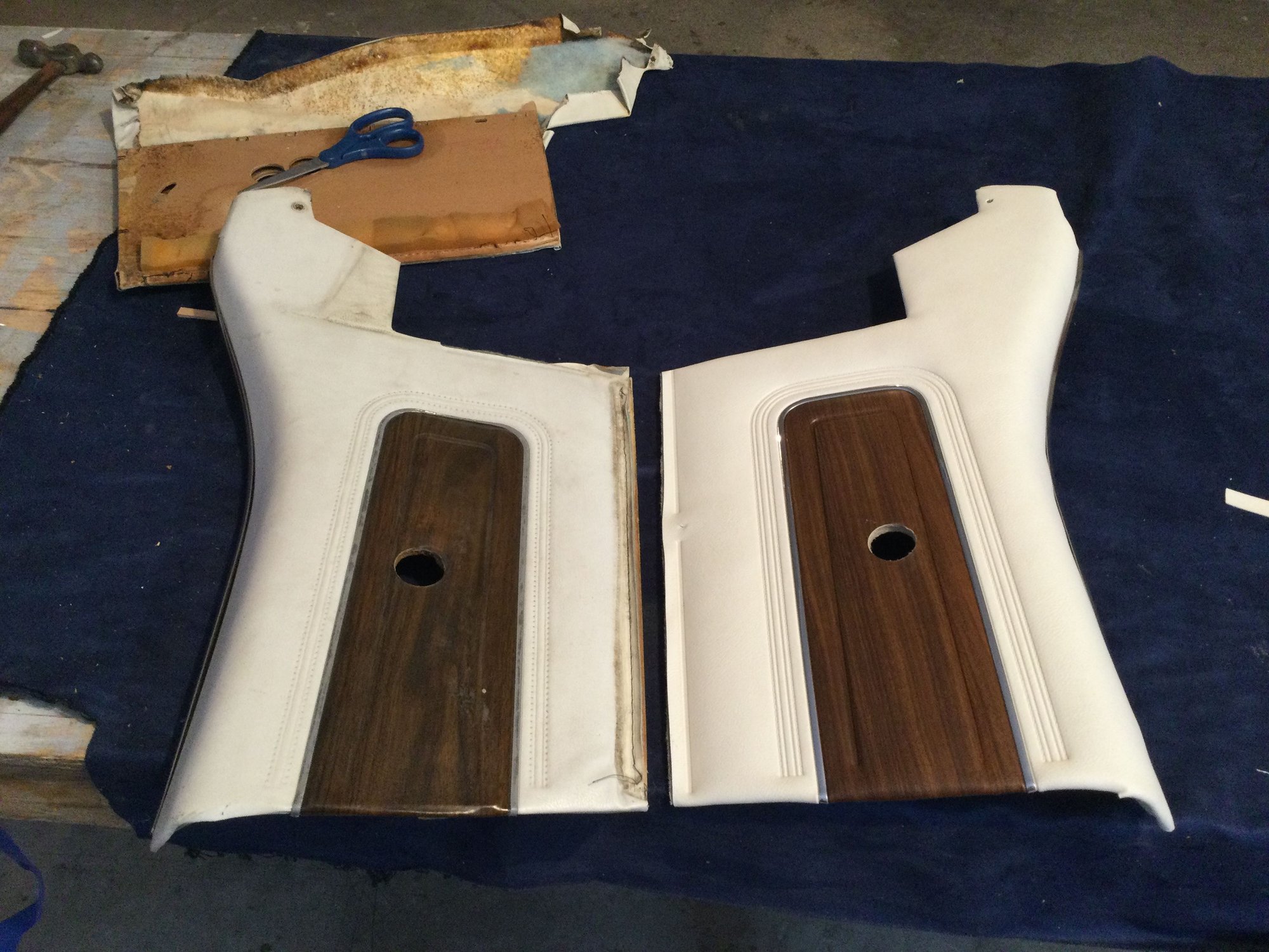

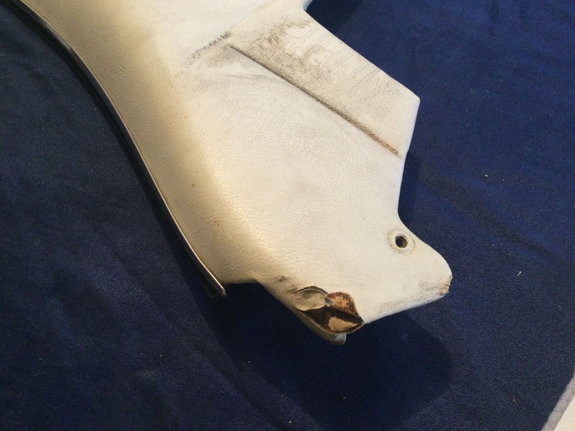

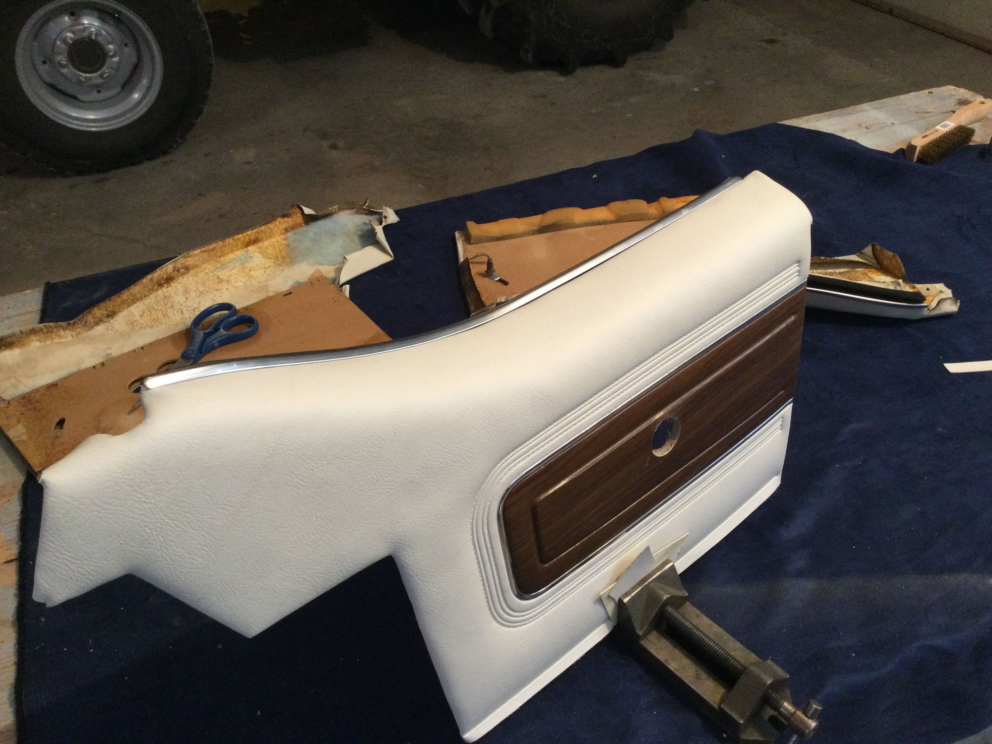

I resumed the interior work by recovering the rear seat side panels. A kit bought from OPGI made by PUI. As earlier mentioned, the vinyl is thicker, and a little hard to shape around tight turns. This work required disassembly of the old parts in order to reuse the upper hard fiberglass part that forms the upper portion. It is stapled to the two piece cardboard panel backer.
Old panel before disassembly
Top edge was tattered
This is the new panel.  The top part of the old panel must be reused
Back side of old panel. Stapled to the hard fiberglass upper
The cardboard lower is actually two pieces, which allowed a easier way to stitch on the vinyl

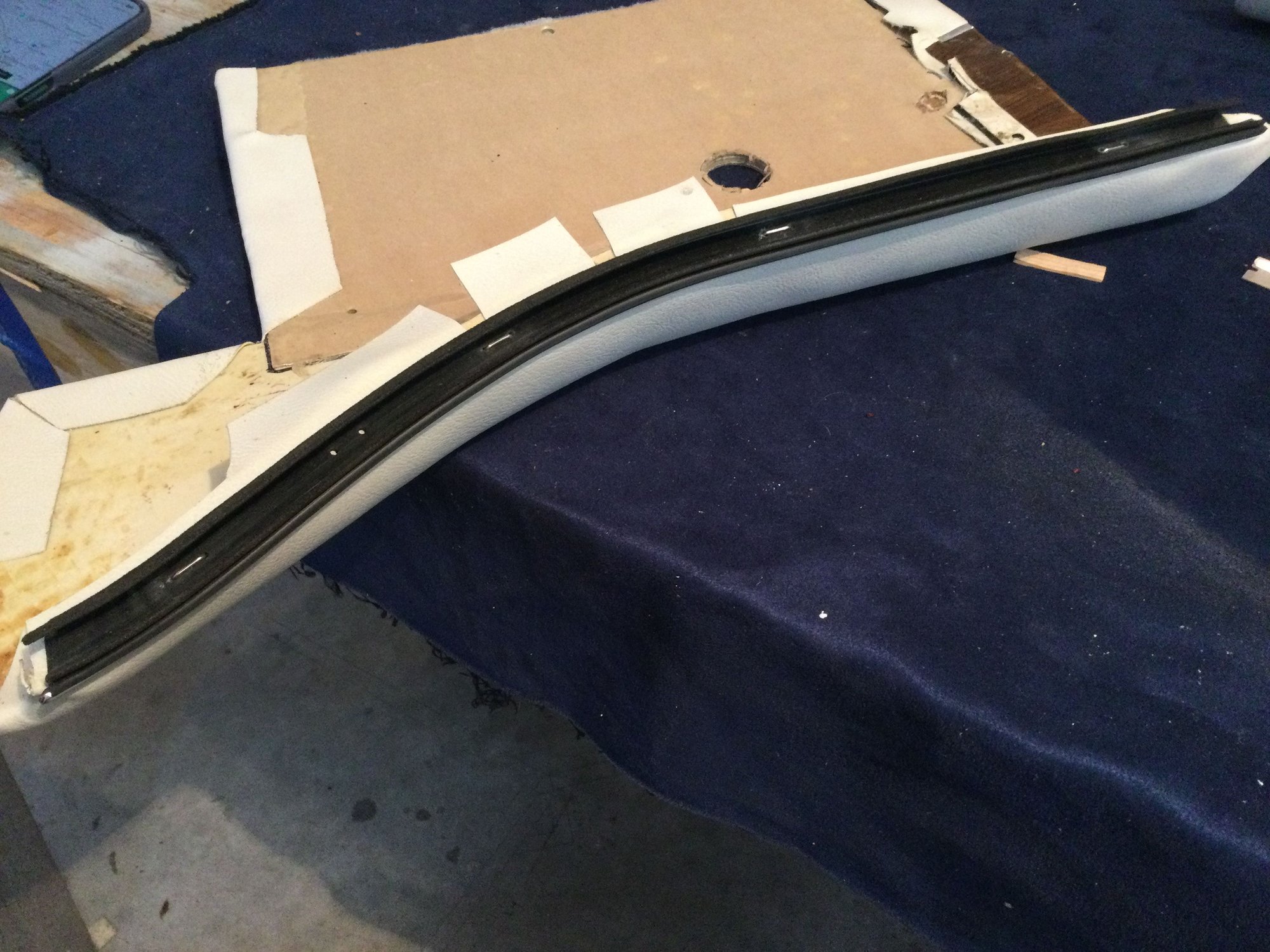

One of the meanest parts of this work is attaching the new interior glass belt line stripping.  It is done with stainless steel staples.  Touchy work to fit and drill through the prepunched holes into the fiberglass, and then trying to bend over the staples.  It is for sure doable, but not easy
Old and newly covered next to each other.
The new cover job with belt line strip installed

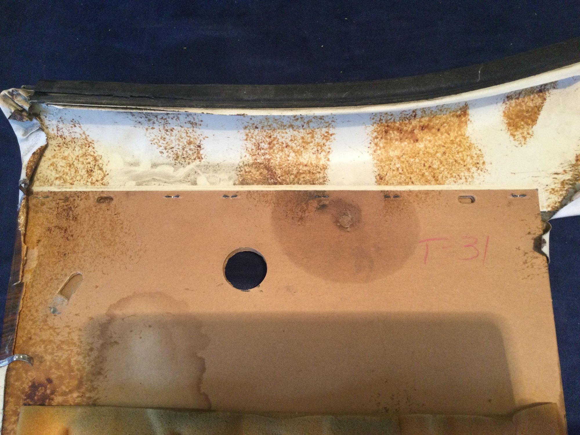

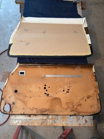

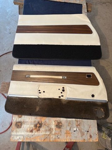

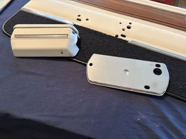

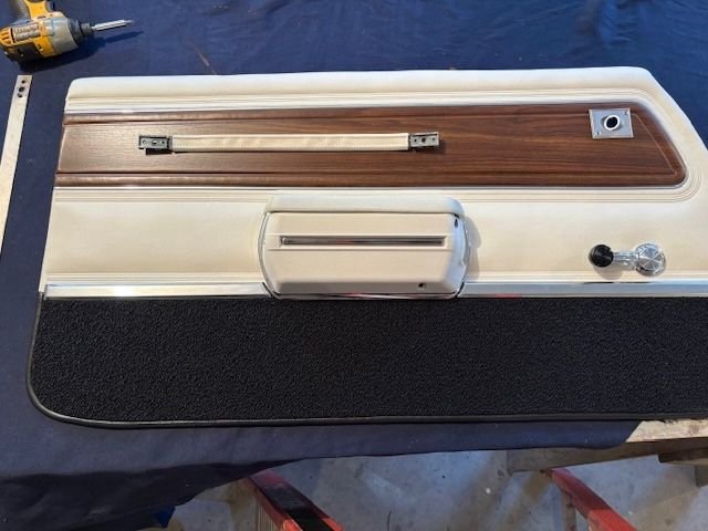

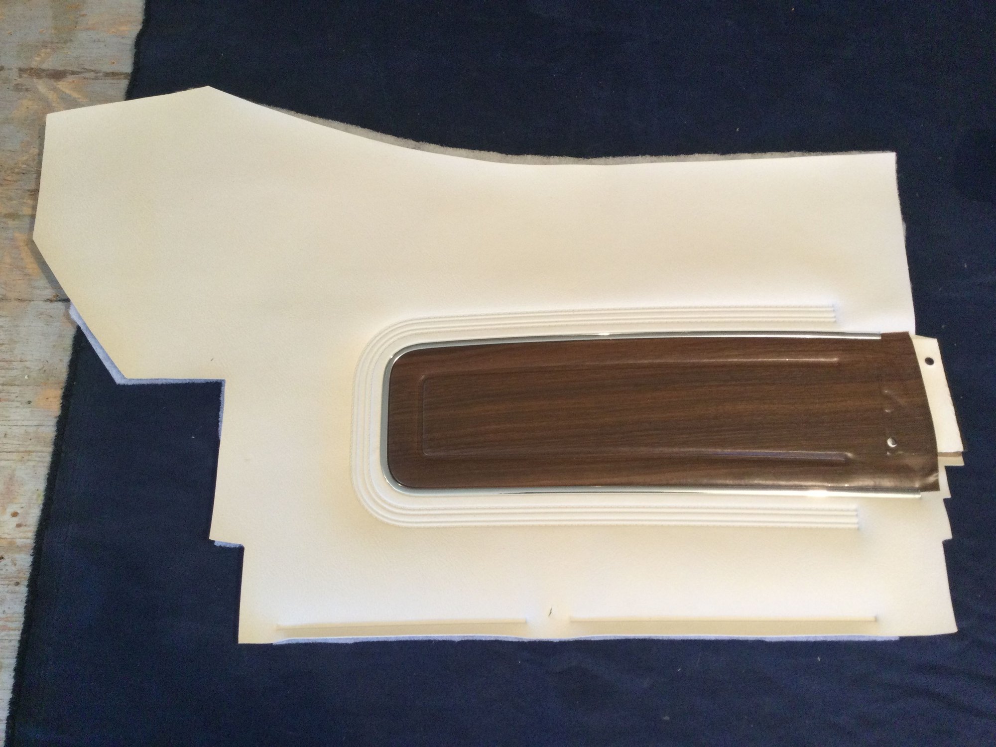

So when I bought this car in July, the interior was a disaster, really. What really looked bad were some cheesy loudspeakers that someone chopped into the lower front corners of the doors. I imagine great sound! But wow did it ever look bad. Last couple days I worked on the driver side. Again, this is a kit supplied by OPGI and made by PUI. I could have bought the complete panels by Legendary but cost was twice as much. This kit requires re use of several of the existing door components like the stainless steel trim elements, door lock grommet, door pull strap, and other things too. Biggest one is that the top rolled edge of the door panel substructure is a piece of curved steel, and that does not come in the kit. I had to destruct the old panel and salvage that part.
The pic's

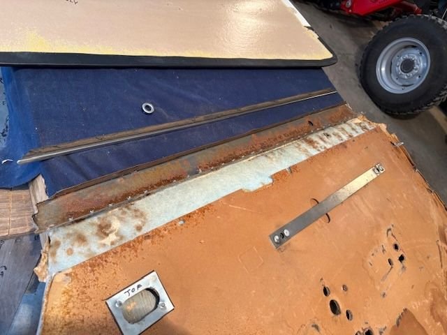

Old panel at bottom, with speaker hole in it, faded carpet bottom.  New kit fabric is the top

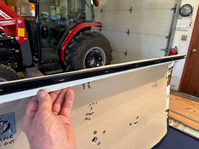

Back side of old panel at bottom.  Kit at top.  All holes were marked and partially cut out by PUI.  I had to complete the cut outs
Here I have separated the top piece of steel substructure from the cardboard backer.  Also removed is the interior window belt line seal.
Here I have reattached the top piece of steel and completed most of the vinyl work.  Fairly easy to do since there are no compound curves on the door panel.  Cleaned up and cut in the door lock grommet.
The beltline seal is installed
The staples supplied are stainless steel, of am alloy that is easier to bend than the originals.  Carefully drilling through factory pre punched holes in the strip into the steel substructure.  You have to be careful to not damage the stripping.  Then reach behind with long nose pliers and bend the legs over.  That gets the legs partially bent, and using some small wood spacer blocking to protect the weatherstripping, the legs can then be squeezed completely.
New plastic chrome armrest plate and new armrest and pad.  May have to return them.  Pad does not fit well.

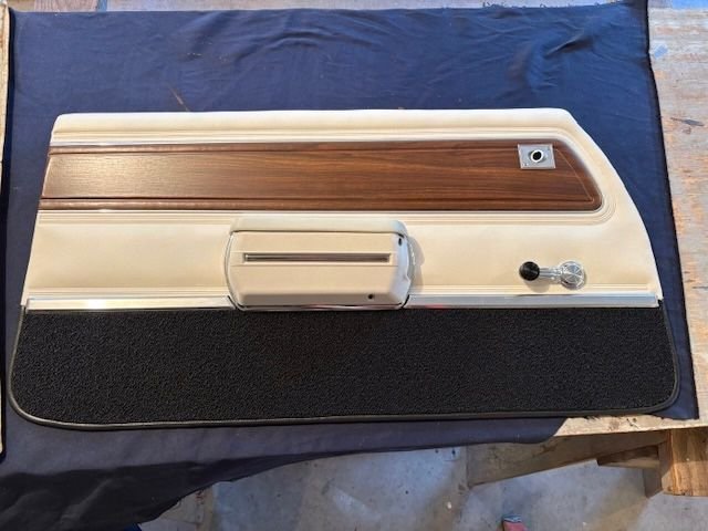

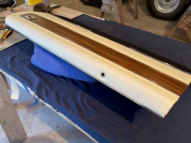

Completed door panel.  New window crank is just layin ther for fun.  Went with black color.
Did not install the door pull strap at this time.  Old one looks kinda bad, and I have not found a source yet for new ones.

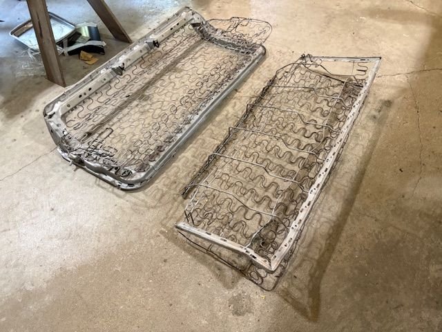

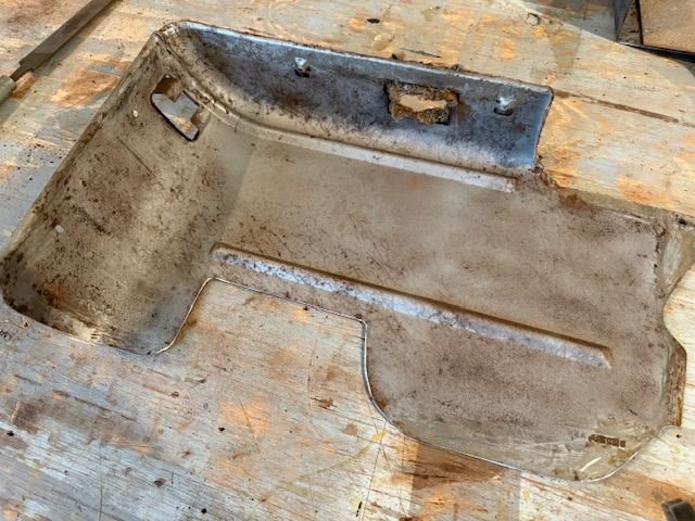

Jumping all over the place on this Cutlass. Working fenders and doors, headed for a repaint this fall/winter I hope! Meanwhile, the upholstery guy called and said he now has a schedule slot to install the PUI seat upholstery. I’ll tackle most things, but I really want a seat that is done right, so gonna pay The Man to do it. I took the front and rear seat parts to him yesterday. He wanted to do the disassembly. He called me today and reported that there were some broken spring parts, driver side bench frame. Also, if I wanted to blast and paint the steel parts, now is the time.
After blasting.  These parts are raw steel from factory, and had mostly surface rust, and in a few places, a little more rust.  I’ll coat it all with some spray cans of rust oleum
The driver side of the steelwork has a broken spring, so I’ll see if I can find that part?  Kind of hard to see in this pic.  The broken part has some black plastidip or something on it, so may have been replaced once already, don’t really know.
The driver side of the steelwork has a broken spring, so I’ll see if I can find that part? Kind of hard to see in this pic. The broken part has some black plastidip or something on it, so may have been replaced once already, don’t really know. The severed part is just above finger. Actually broken in two places.

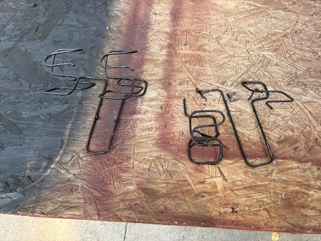

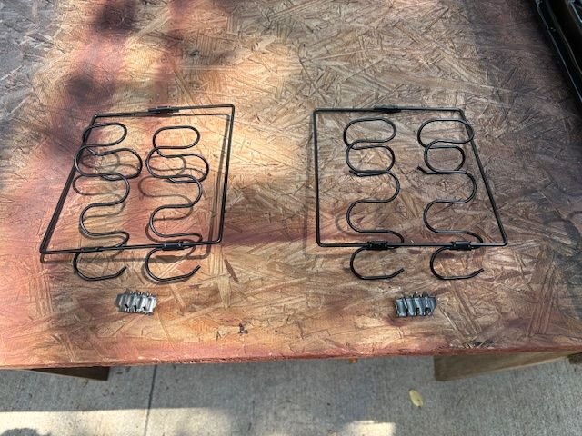

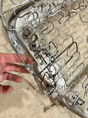

I decided to use a mini spray gun and black rustoleum to paint the cushion parts. I was able to find new bench seat end springs. Not many places to buy them. Two spring assemblies $50 to the door. So I will return these parts to the Upholsterer. Monday.
These are the end cushion springs.  It looks like they perhaps were replaced once already?  Not real sure about that.  One side was broken in two places, other side was OK.
Here are what I believe to be the correct springs.  They don’t look exactly like the old ones
Here are what I believe to be the correct springs. They don’t look exactly like the old ones. They came with black on them.
New, installed.  Small soft steel wrap around sleeves are used as attachments.  Getting these springs in place went pretty well.
New, installed. Small soft steel wrap around sleeves are used as attachments. Getting these springs in place went pretty well. Cushion steel as factory supplied is all raw steel. And it was all lightly rusted. So, some black on the steel not factory correct, but better, I think?
The bottoms of the springs fit into these retainers.

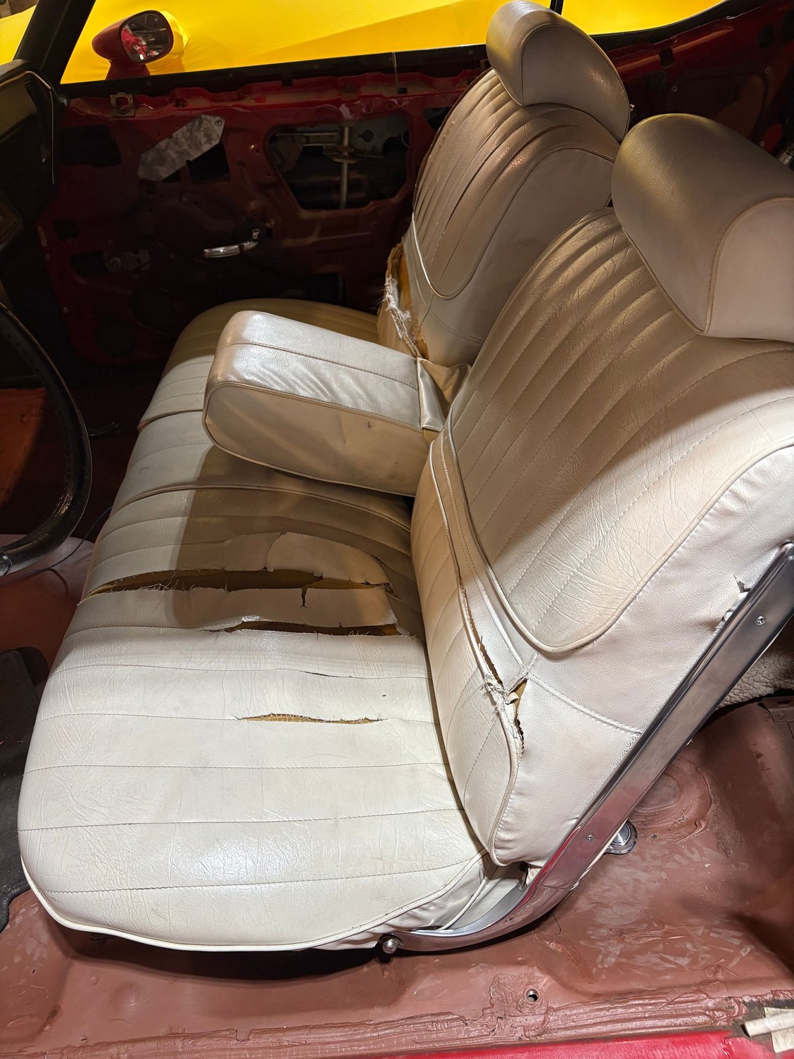

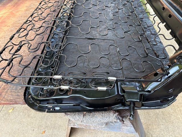

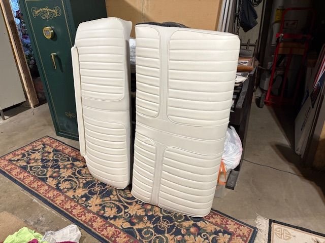

This was a fun day. The upholstery fella that I was VERY fortunate to find called to tell me he was done with the seats. I had bought PUI front and rear seat upholstery. And he was willing to do the installation. His cost I thought very reasonable. Not easy to find anyone to do this work, and the 4 month wait was well worth it for me.
I am really disappointed in myself for not taking some good before pictures. I was able to find one, but I didn’t do a good job of documenting this.
Front seat was a disaster.  Arizona sun killed it, I think?
This is such a huge improvement.  A stock white color, and original Olds stitching.  All in for parts and labor to install, about $2000.
The rear cushion and backrest.
So for now, these parts will rest in the basement.  Covered them well, because the cats may mistake them for new scratching posts.   I now have everything needed to do a complete new interior.  I will likely leave it sit until the exterior bodywork is done.  May temp install the front seat for a fall drive.

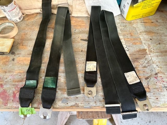

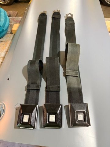

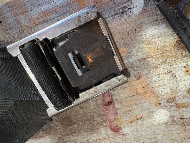

When I took the seats to the Upholstery man, the front seat had the seatbelts threaded through the seat. When I picked the seats up, he told me, Steve, I just couldn’t put those old dirty belts next to the new clean vinyl. And I told him, Thank You for NOT putting those filthy belts back on the seat.

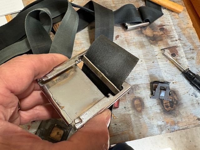

I had previously disssembled the rear belts and cleaned them up. I found a video showing how to get the buckles removed, and then put the straps in with a load of laundry. They cleaned up and almost looked brand new. But I’ll tell ya, getting them apart and back together is worse than pulling a cylinder head!
Heres the vid if interested
A few pictures.

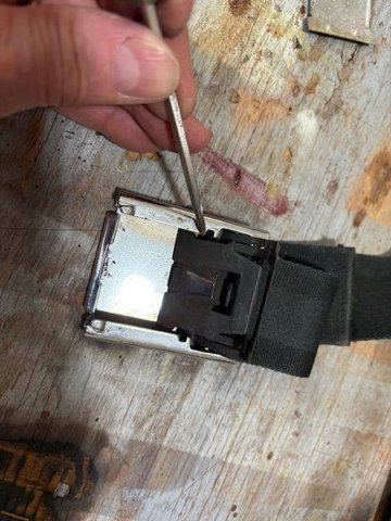

Insides of the buckle.  Lots of dirt and dust.  Used a soft brush and multipurpose cleaned to clean them up.
Insides of the buckle. Lots of dirt and dust. Used a soft brush and multipurpose cleaner to clean them up.
This little spring is nasty to remove.
Spring is sharp and will cut you if not careful.

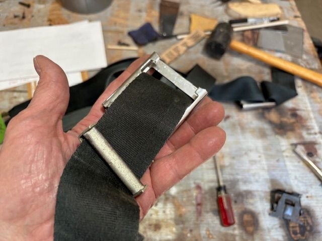

With the spring out, the belt will twist out
With belt retainer twisted at an angle, the belt can be pulled through the buckle frame.
Remembering how it all goes back together is the hard part.  Lots of pictures help.  And this is something that I want to get back together quick, before I forget how to do it.
Old uncleaned belts on left.  Belts ran through the laundry on the right.

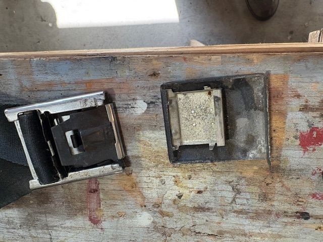

I reassembled the two belts, before I forgot too much! Still had to relearn a few things. These buckles are simple, if you work on them enough to learn the secrets, and there are some.
While I had the buckles apart, I removed what was left of the old black coating.  Seemed to be like a rubberized paint?  Not sure, but it didn’t look real good anymore.  So repainted the two on the left with satin black spray paint.  My thought at this time, is to just put a driver set and a passenger set on the bench seat.  Belts from that era are such a nuisance except when wearing them.  I will disassemble, clean, and paint the one on the right, and store the part.
While I had the buckles apart, I removed what was left of the old black coating. Seemed to be like a rubberized paint? Not sure, but it didn’t look real good anymore. So repainted the two on the left with satin black spray paint. My thought at this time, is to just put a driver set and a passenger set on the bench seat. Belts from that era are such a nuisance except when wearing them. I will disassemble, clean, and paint the one on the right, and store it for the center set.
