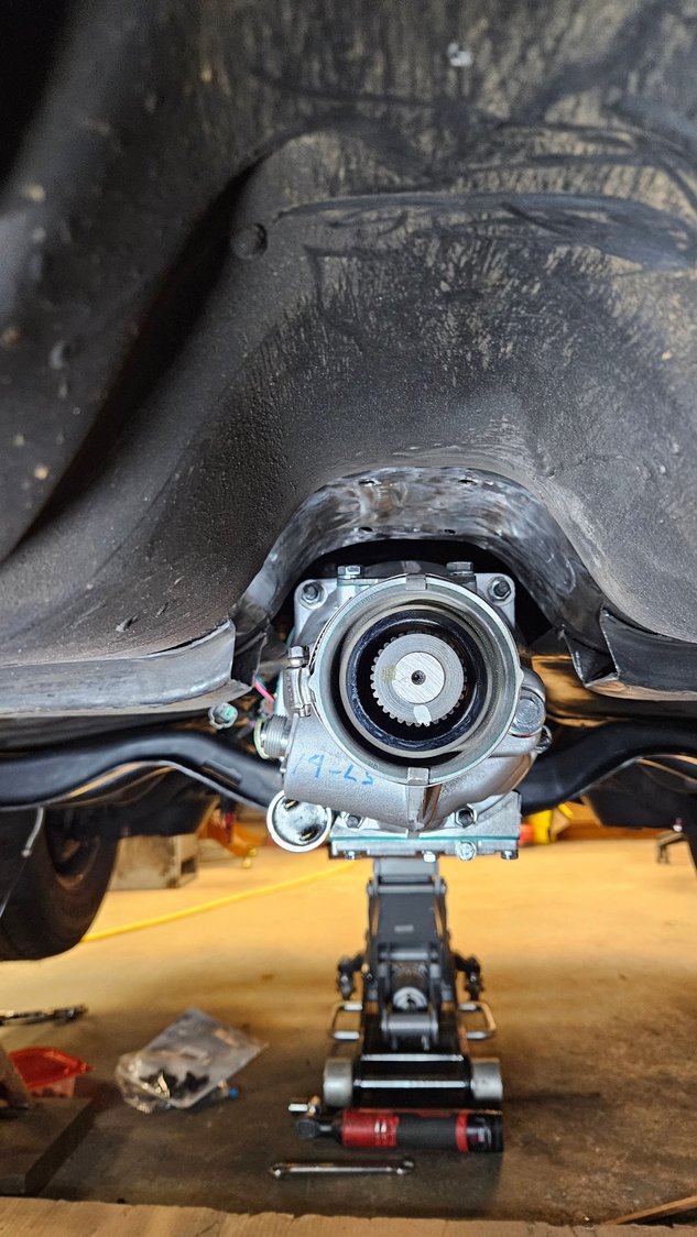

So I have decided after spending some up close and personal time on my back to drop the unit and massage the tunnel a bit more to raise the tranny closer to stock height. I have the trans mount now at 1.5" high, stock is around 1.875 to 2". I have it set and will put a small notch in the floor brace to relieve a slight bend in the speedo cable. Speedo now comes in on the drivers side as opposed to passenger side. Also my angle between GV and pinion is not parallel. Tranny down and pinion facing down. I have adjustable upper arms to that will be the final adjustment. Everything except the trailing arms should be set this weekend.
woodie582 is offline

Reworked and done. 2 drives totaling 50 miles. The tunnel took quite a bit of massaging with an air hammer. 70 in 4th no gv is about 3200 with gv rpm drops to 2500 and change. I installed Umi adjustable upper arms and brought the pinion nose up to within 1.5 degrees of tranny to allow for pinion climb. No vibrations.

Nice 👍. I used the low profile Muncie mount from Gforce with 4 - 1/8” shims. Tranny was down 3.5 degrees.

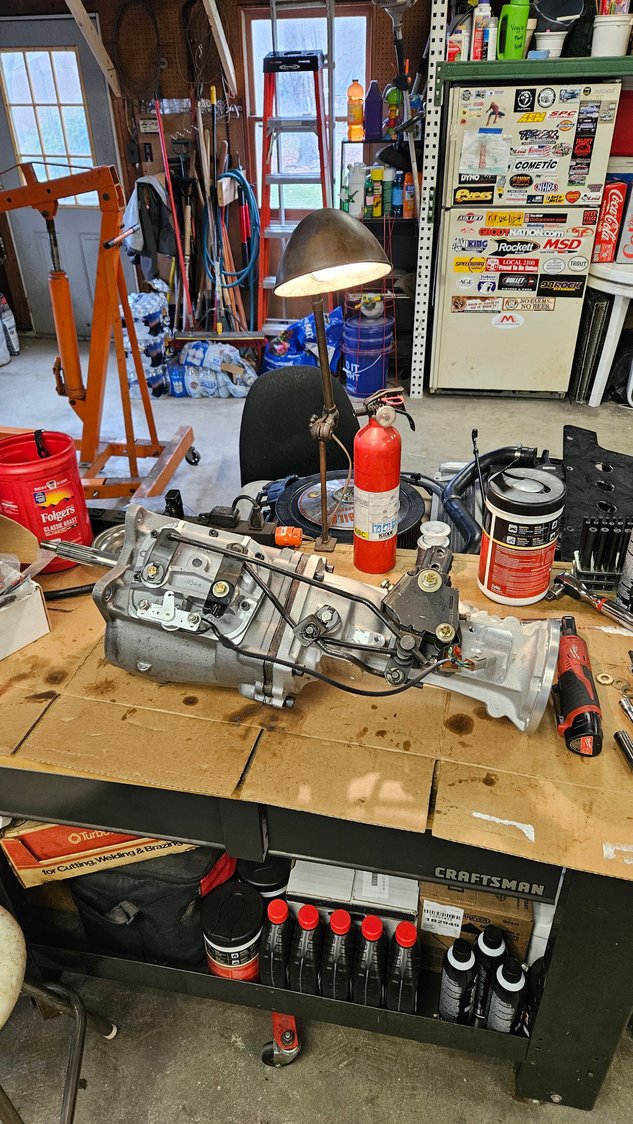

It's in, and back out. Required a lot more cutting than anticipated, but is serviceable.

Wow! It slid right into my 65 without any trans tunnel work.
looking good though! Nice progress.
