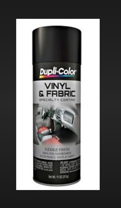

The SEM vinyl dye paint works well, its availible in many colors or some places will custom mix it for you.
ive used black to change from green on the pass side seat of my car, its been several years it still looks good w no cracking or peeling. You would never know it was once green.
i used it in the past to change green to blue...also worked well. Good prep goes a long way.
I also used the carpet dye spray can (maybe duplicolor) from advance auto to freshen the carpet at the bottom of my door panel. The black had faded to a brownish color. The dye made it nice an black again. It looks great, but it does have a coarse feel to it. The feel is a non issue, but if its a carpeted part that is touched frequently it might be something.
iirc the carpet dye also said vinyl dye, but ive only ever used SEM for vinyl (and plastic bits too).
