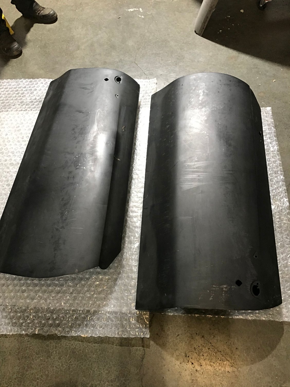

While I’ve got your attention. Ever try or know anyone who has tried to repair plastic front inner fenders? Mine were removed rather roughly and suffer from some tear outs around the mounting holes.

I have a few used sets if interested. Im in MA and shipping would be pricey though.

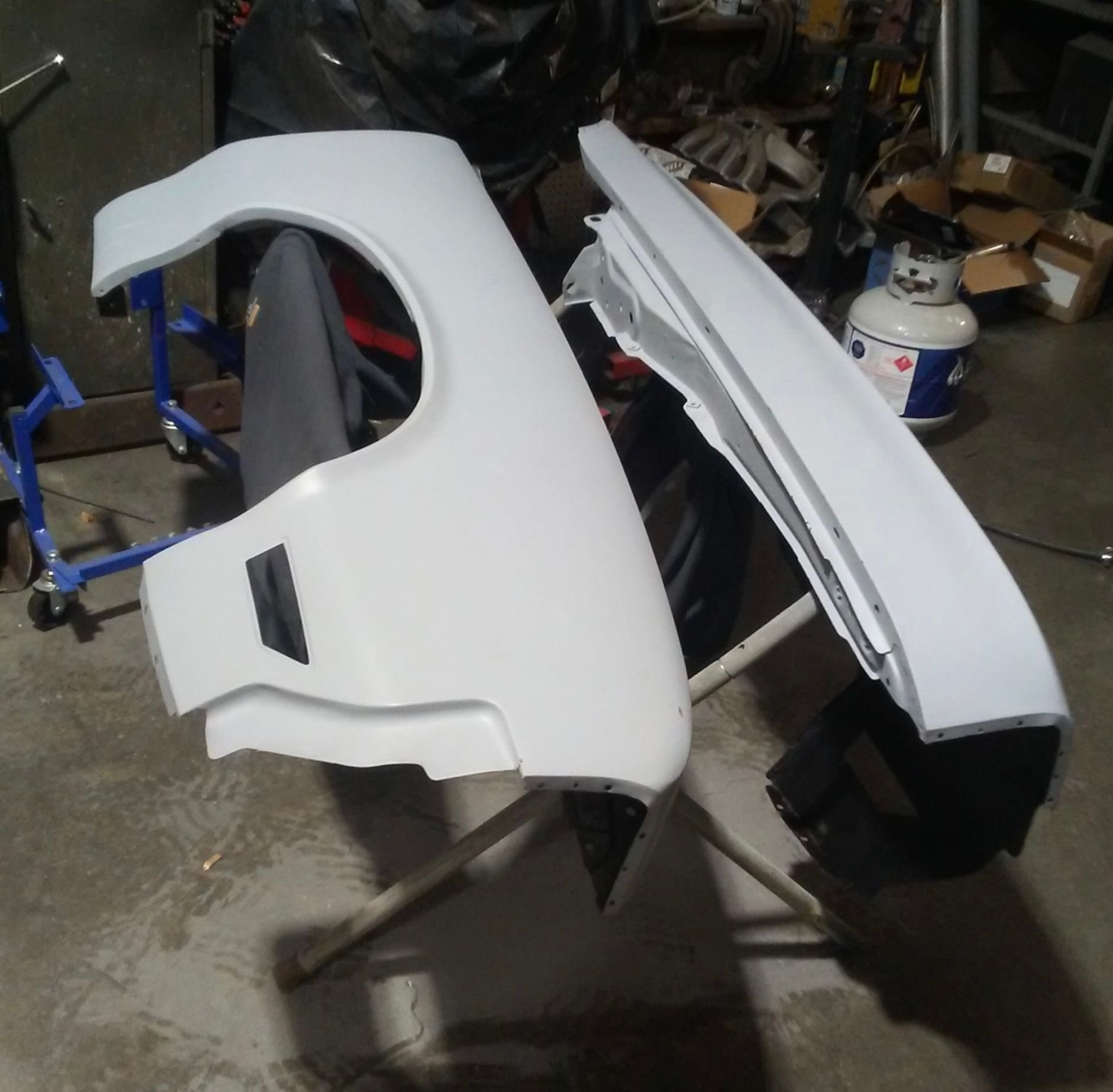

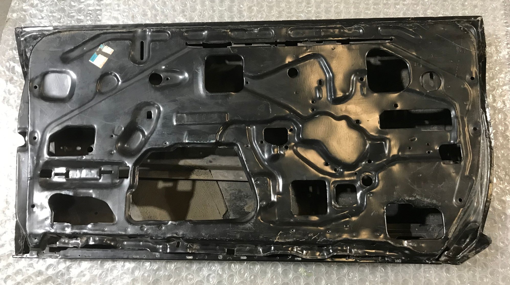

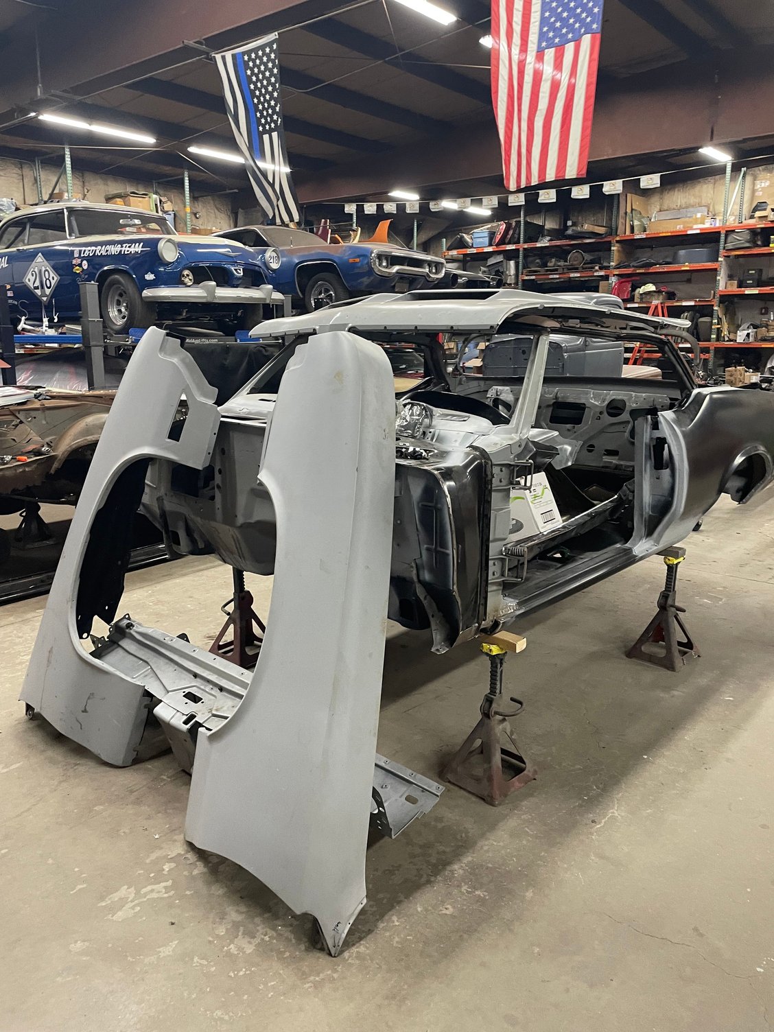

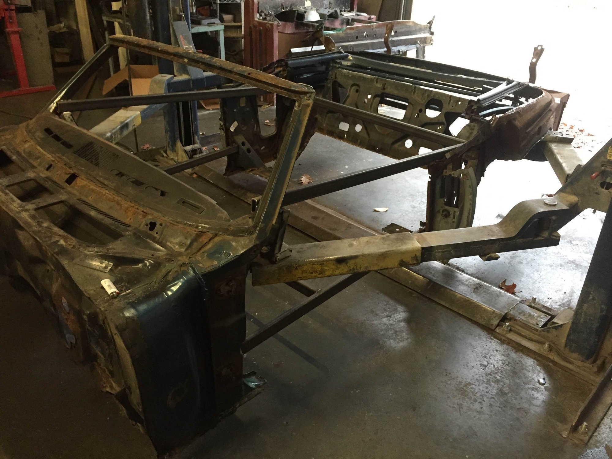

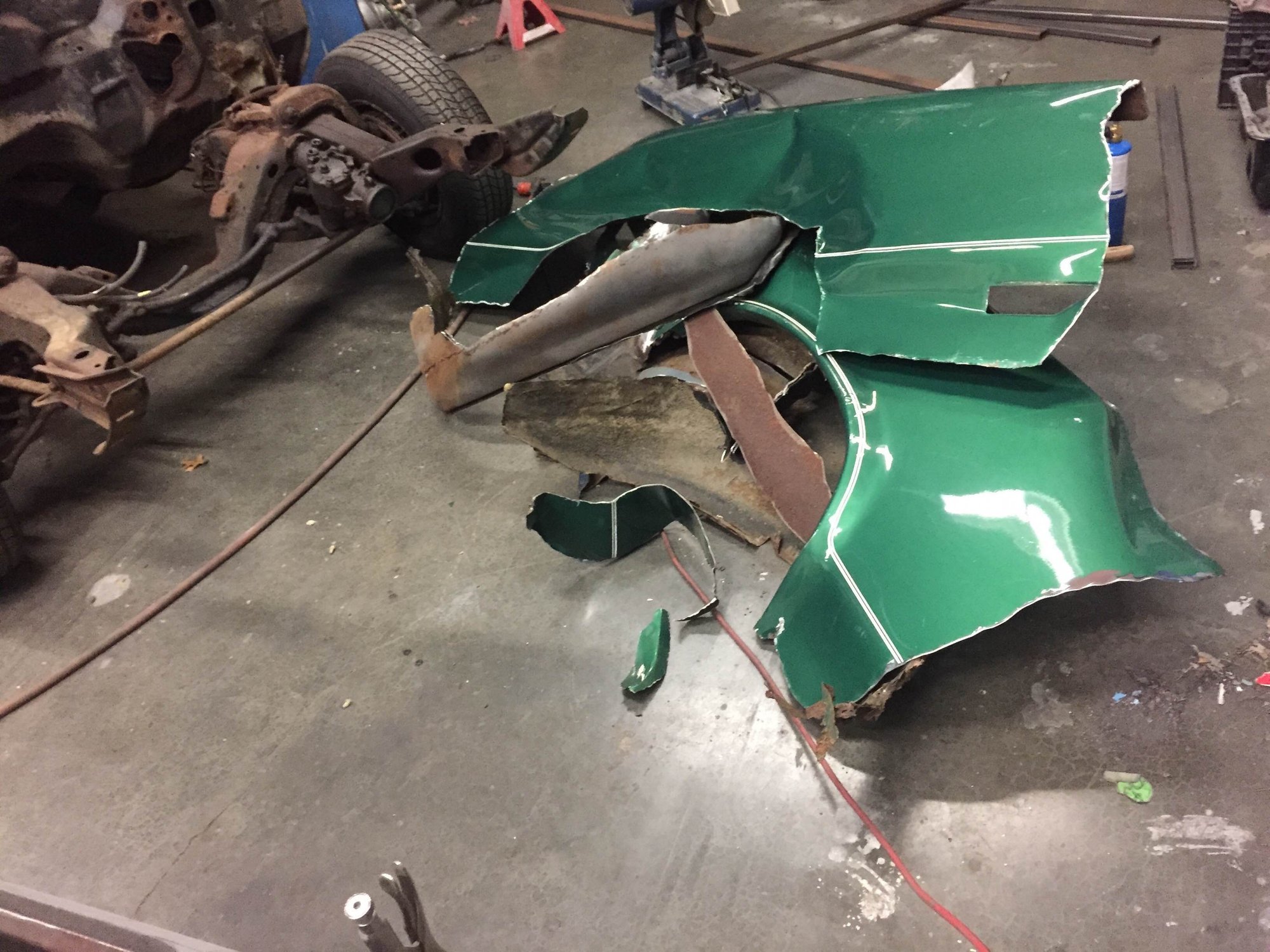

SO.....As you can see above. Found some nos doors and two real ‘70 front fenders. Also picked up a one-off front bumper (not shown). Original had typical tow strap grin.
Welder hung doors and is working on gaps ...again. I admire his patience. Once he gets the nose on and creates a dolly, I’ll take the rolling donor frame and line it up next to the original frame. I can then get to restoring or replacing suspension, brakes and lines, etc. That’s my plan anyway.

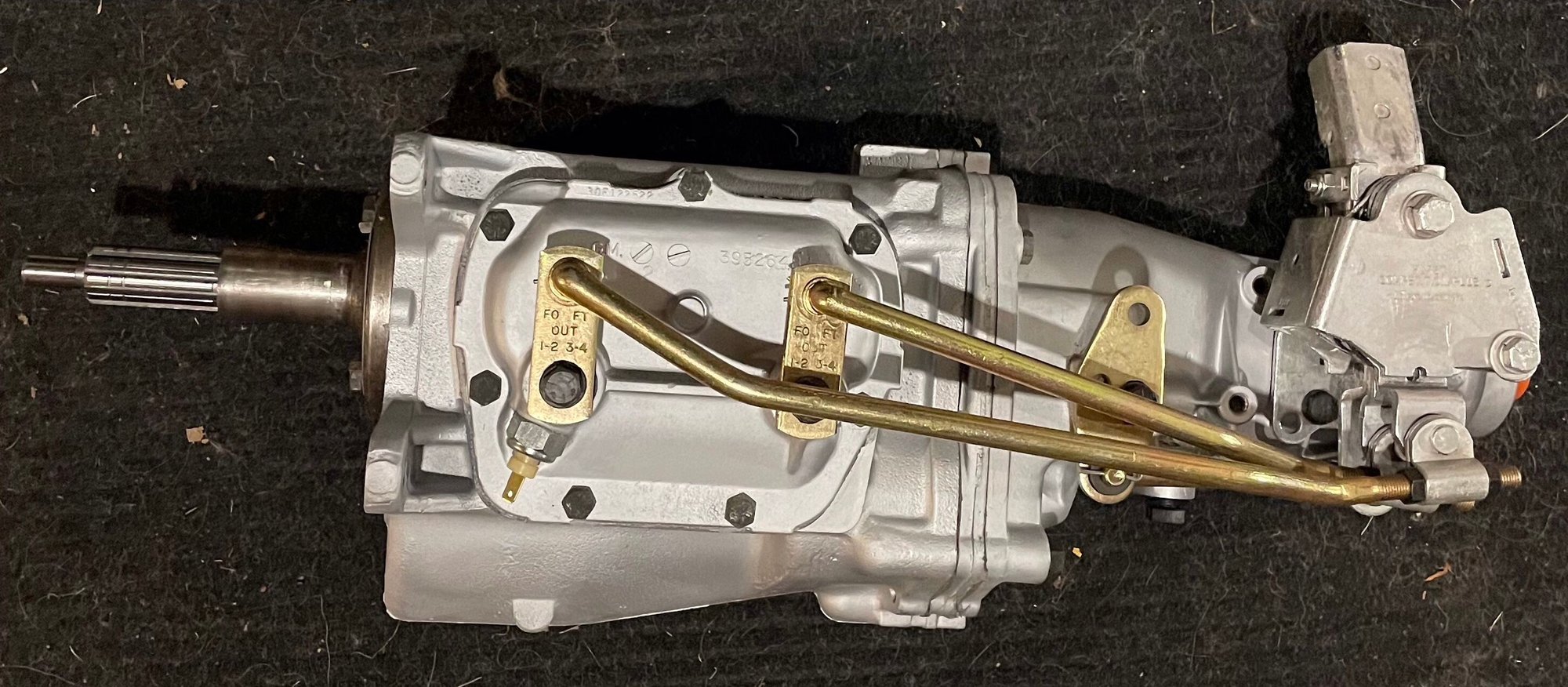

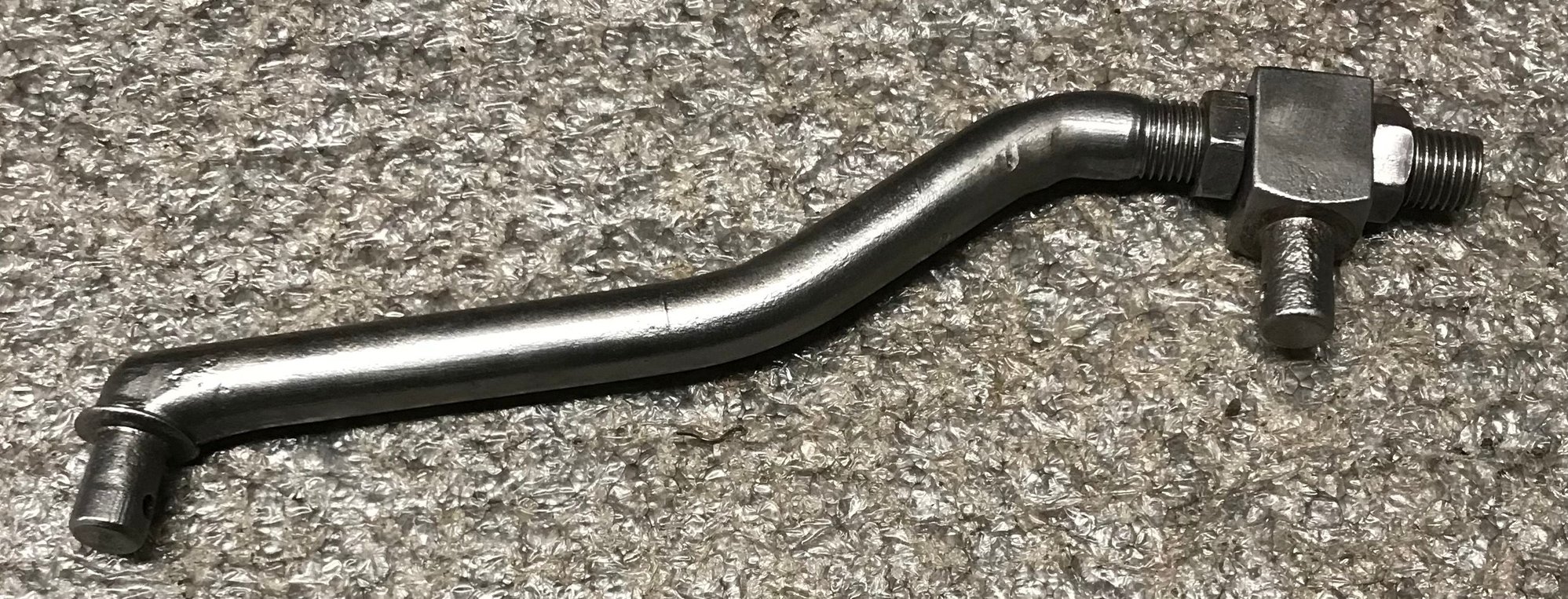

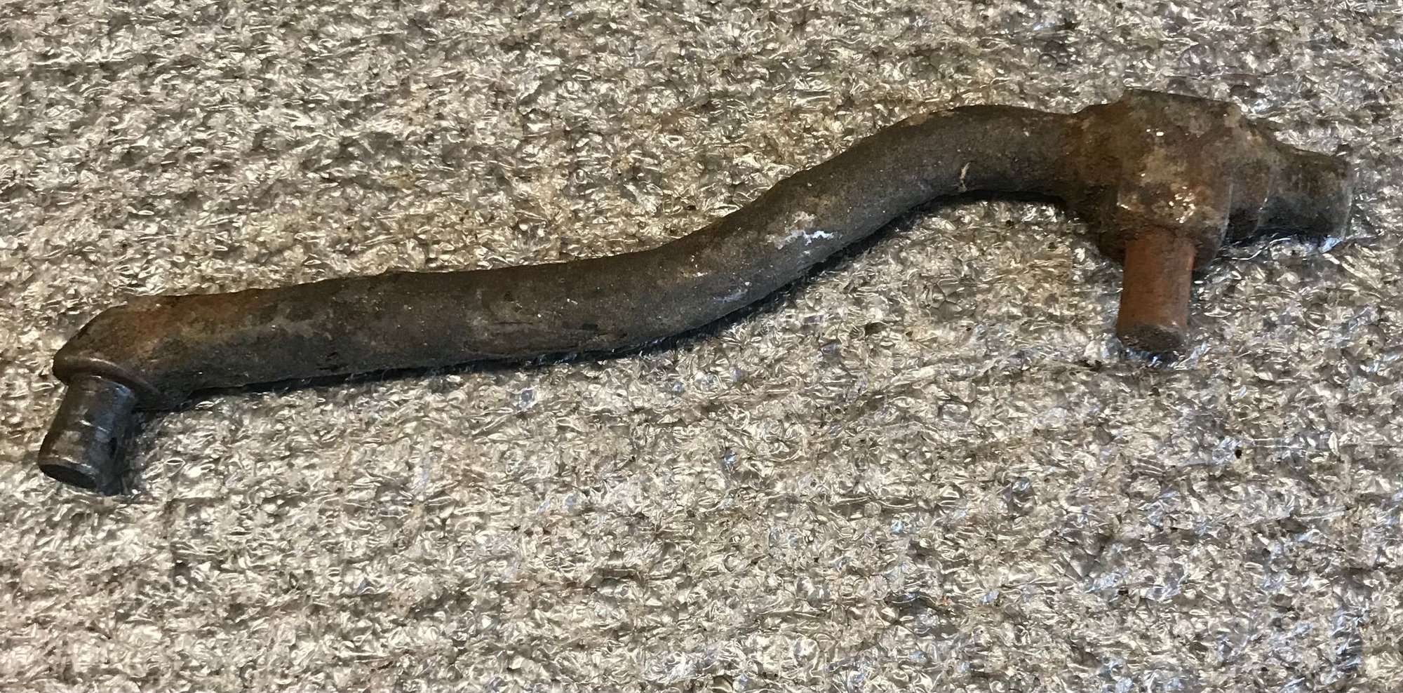

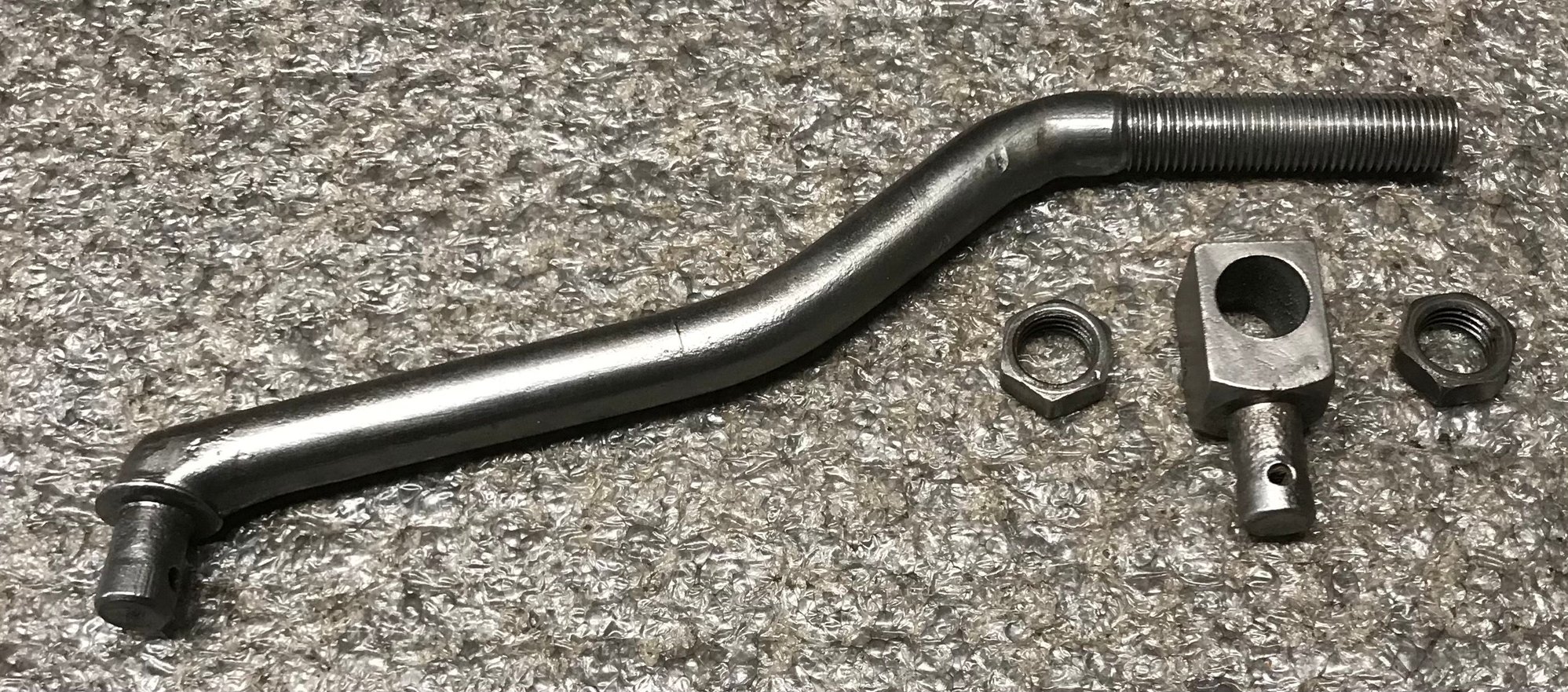

Some degreasing/wire wheel work on linkage before and after pics for ya. Lots more of those but looking at too many gets redundant. All will be shipped out for painting/treatment as required.

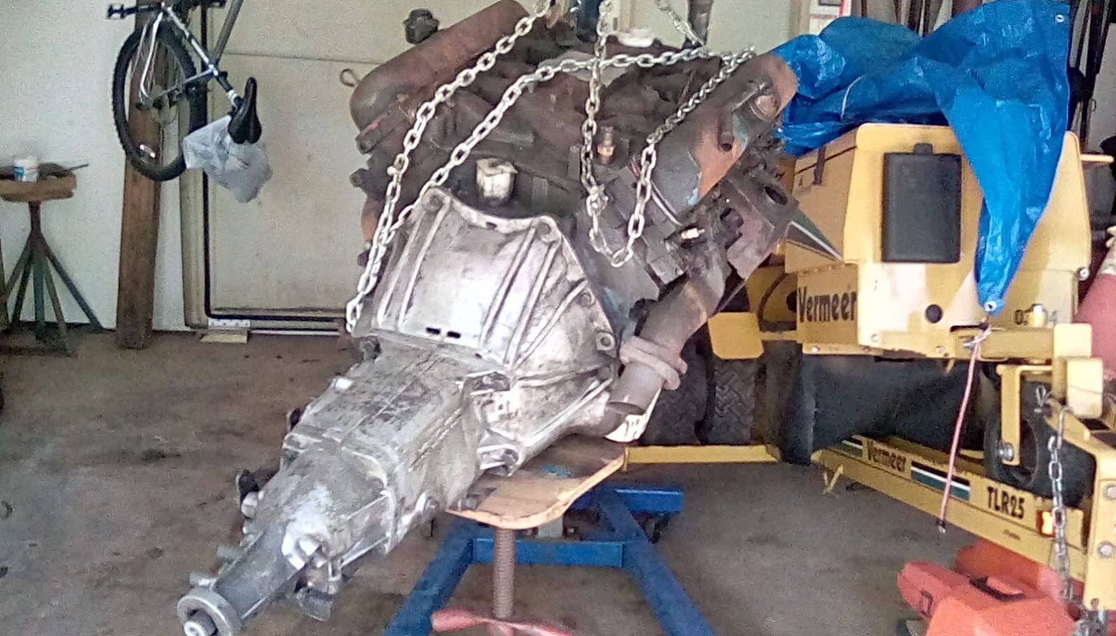

A bit of a snag getting at transmission. Still mounted to motor and both have become buried in the back of engine guy’s warehouse/garage. Once he clears a path will send it out. My fault, you snooze you lose. ; ]

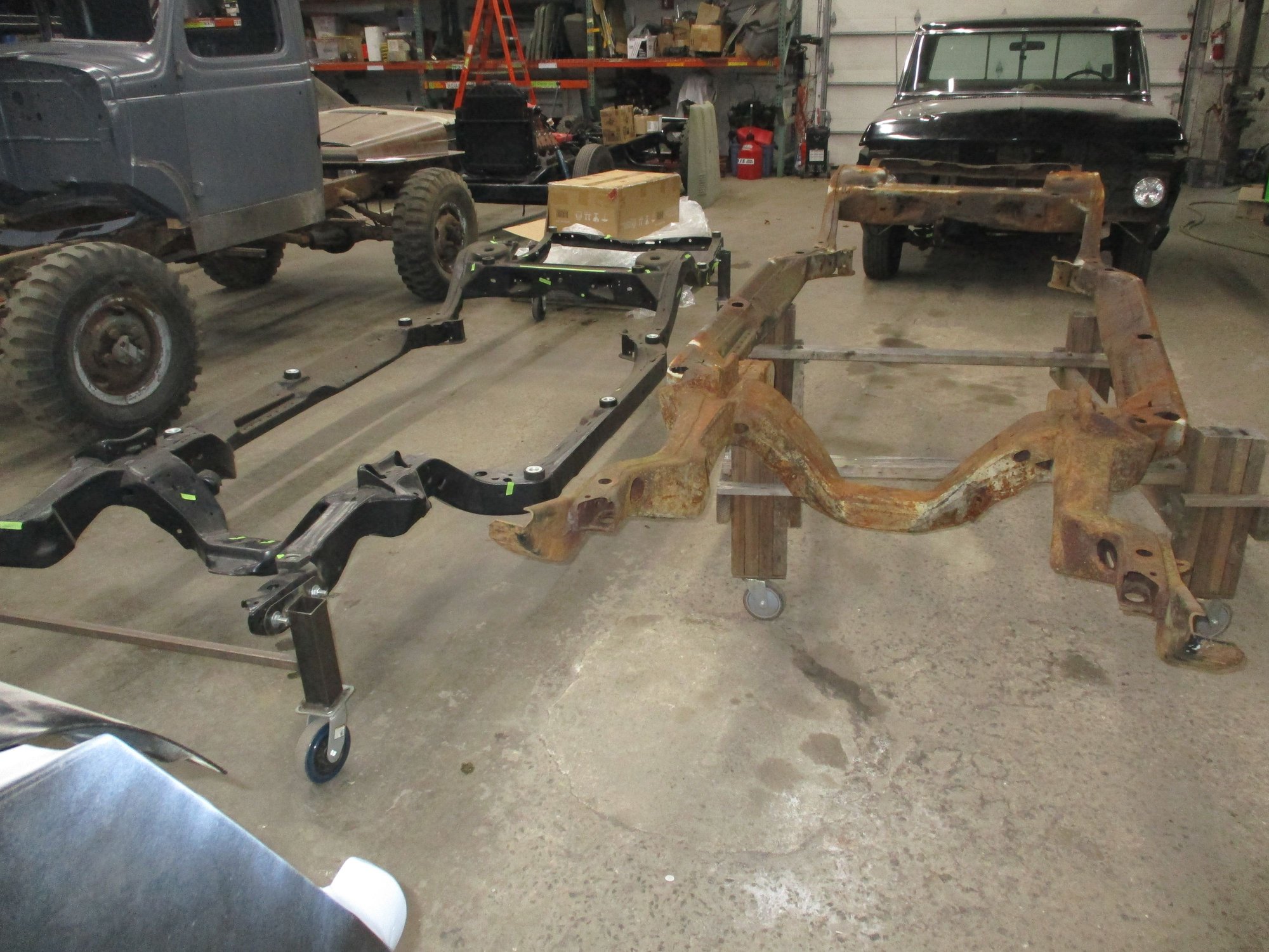

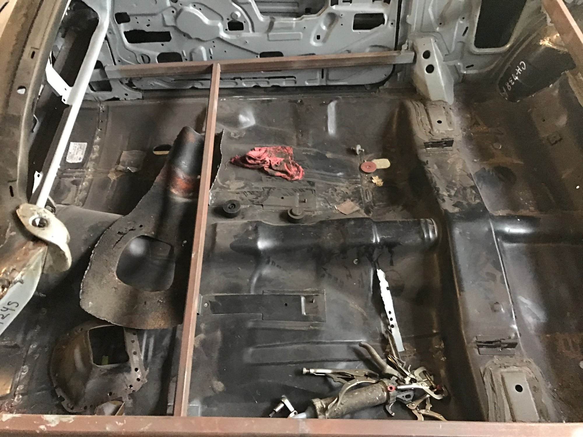

Have the frame put on a frame rack (table) and checked for square. Then start restoring it. Be sure to coat the inside of the rails with something.

Ya know? You’re right. I hear ya. think I was blocking that possibility out. Good advice man. I will forward your suggestion on checking the frame tomorrow. I recently watched body alignment problems develop on a guy’s project due to an unchecked bent frame. They had to take everything apart and straighten. Will let you know what I find out.
Going with original paint scheme. Twilight body, blue top and pearl gut.
Have installed aftermarket deck lid, will add rear spoiler along with a W25 hood for fun. Thinking black stripes on hood.
Keeping original trunk lid and the original slick hood. They’ll be painted along with car (twilight) and go into storage.

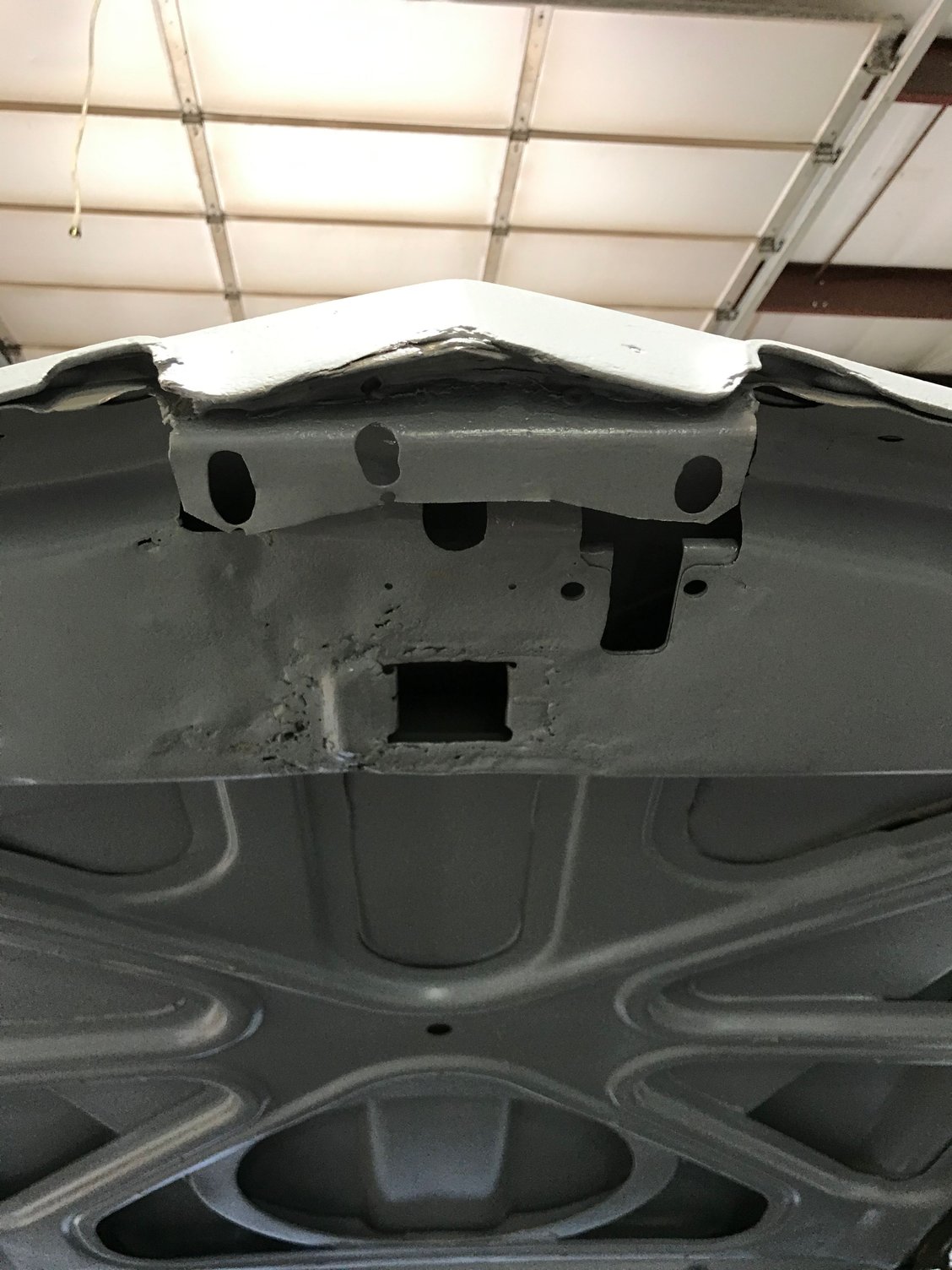

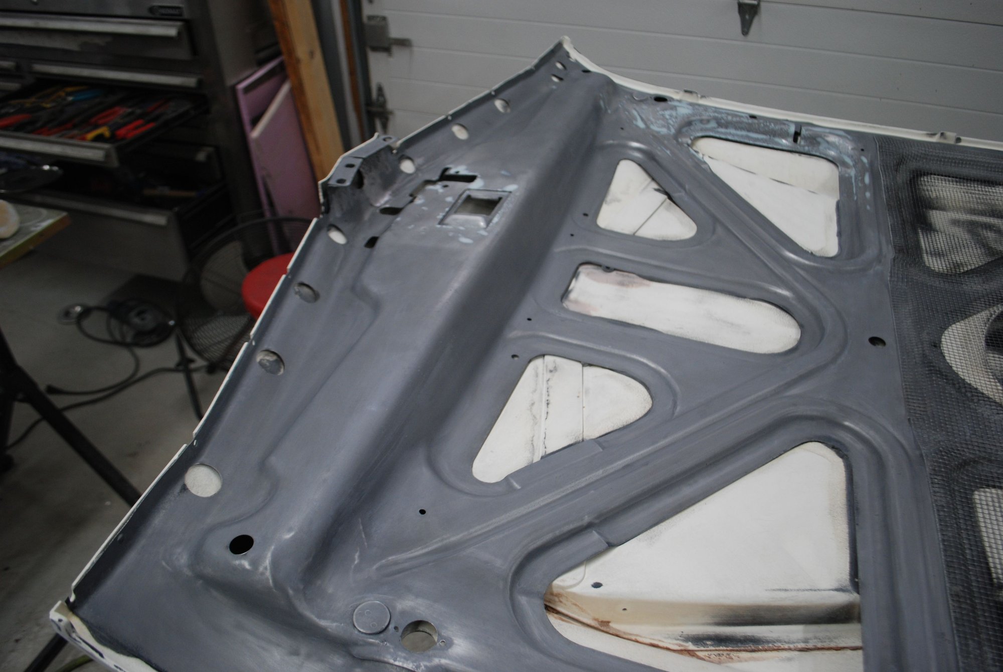

Question Requesting help with W25 hood nose repair.

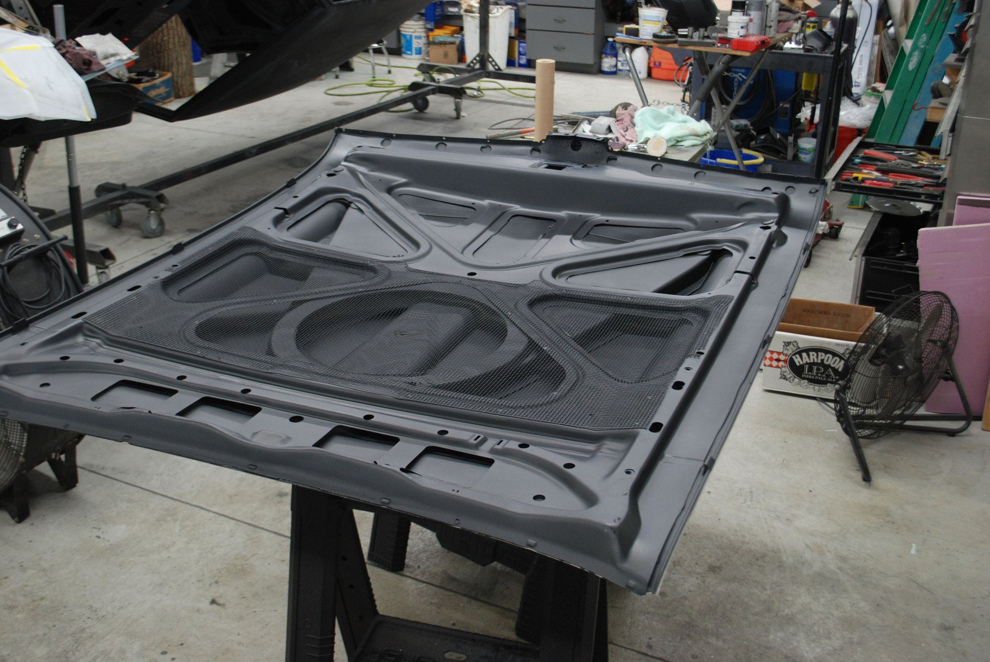

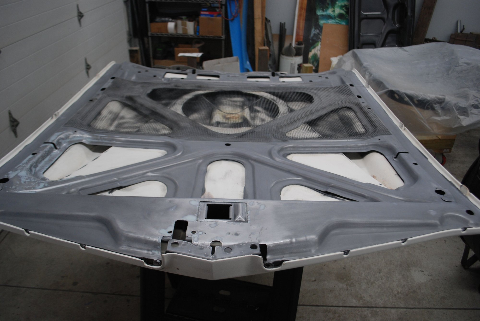

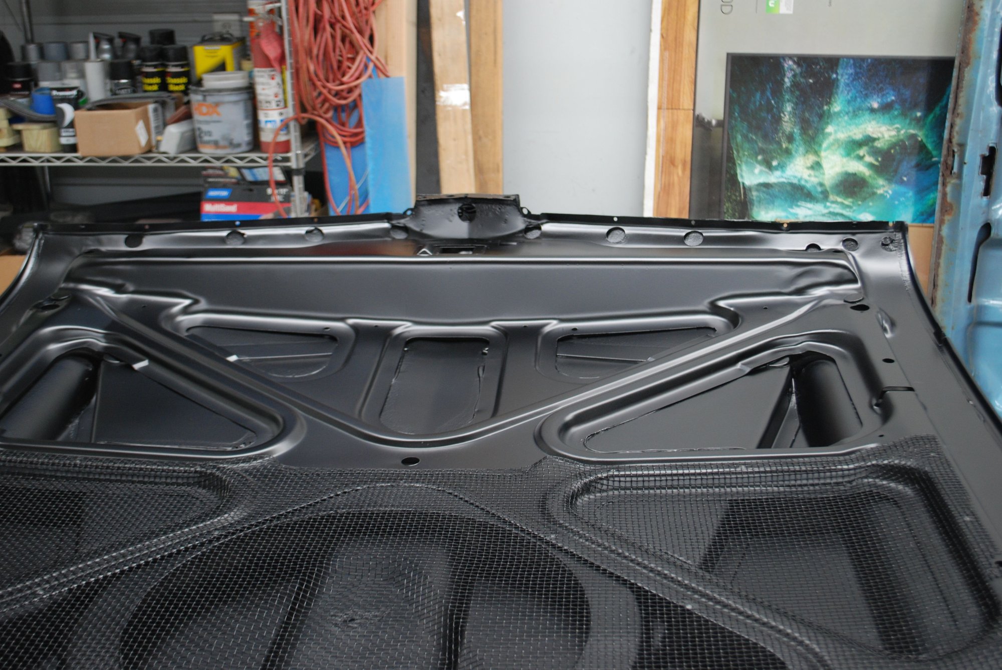

Trying to repair ‘70 442 W25 hood nose. (1 of 3). Need reference pictures
Trying to repair ‘70 442 W25 hood nose. (2 of 3). Need reference pictures
Trying to repair ‘70 442 W25 hood nose. (3 of 3). Need reference pictures
Looking for photos showing a good W25 hood with emphasis on nose and how fiberglass attaches to steel here. This one’s been poorly repaired and my guy needs reference pics to attempt to restore. Thanks in advance.
- Krusty
KrustyAV8R is offline
Old May 18th, 2021, 05:17 AM
scrappie's Avatar
Join Date: Mar 2007
Location: eastern MA
Posts: 3,287
Here you go Dean, hope all is well. Let me know if you need any more pics.

Looking good, great color combo too! Could you source a regular steel hood for a donor and graft the front section to yours? Your hood looks like a lot of work but you have some talent moving the project along.
Post70 is online now
Old May 18th, 2021, 08:28 AM
KrustyAV8R's Avatar
Join Date: Nov 2020
Posts: 47
Thanks Buddy!

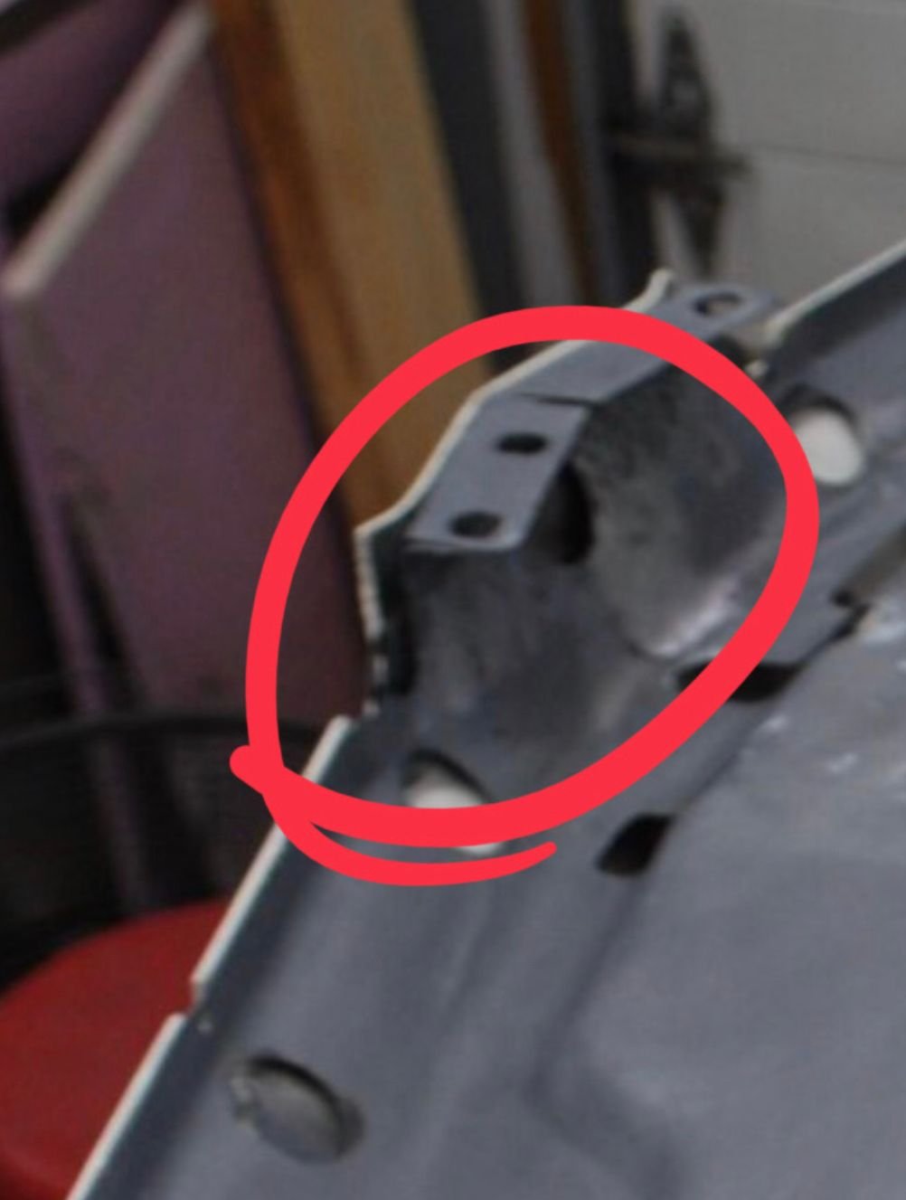

Sent them to the fabricator. He replied and is requesting a little more detail.
You’re helping me out is really appreciated. Trying to get this car out of welder prison. lol.
His annotations to your pics are in the captions below.
“Kind of in here. That way I can see how far in the second layer of steel is supposed to go.”
“Any chance of getting a close up in this area?”

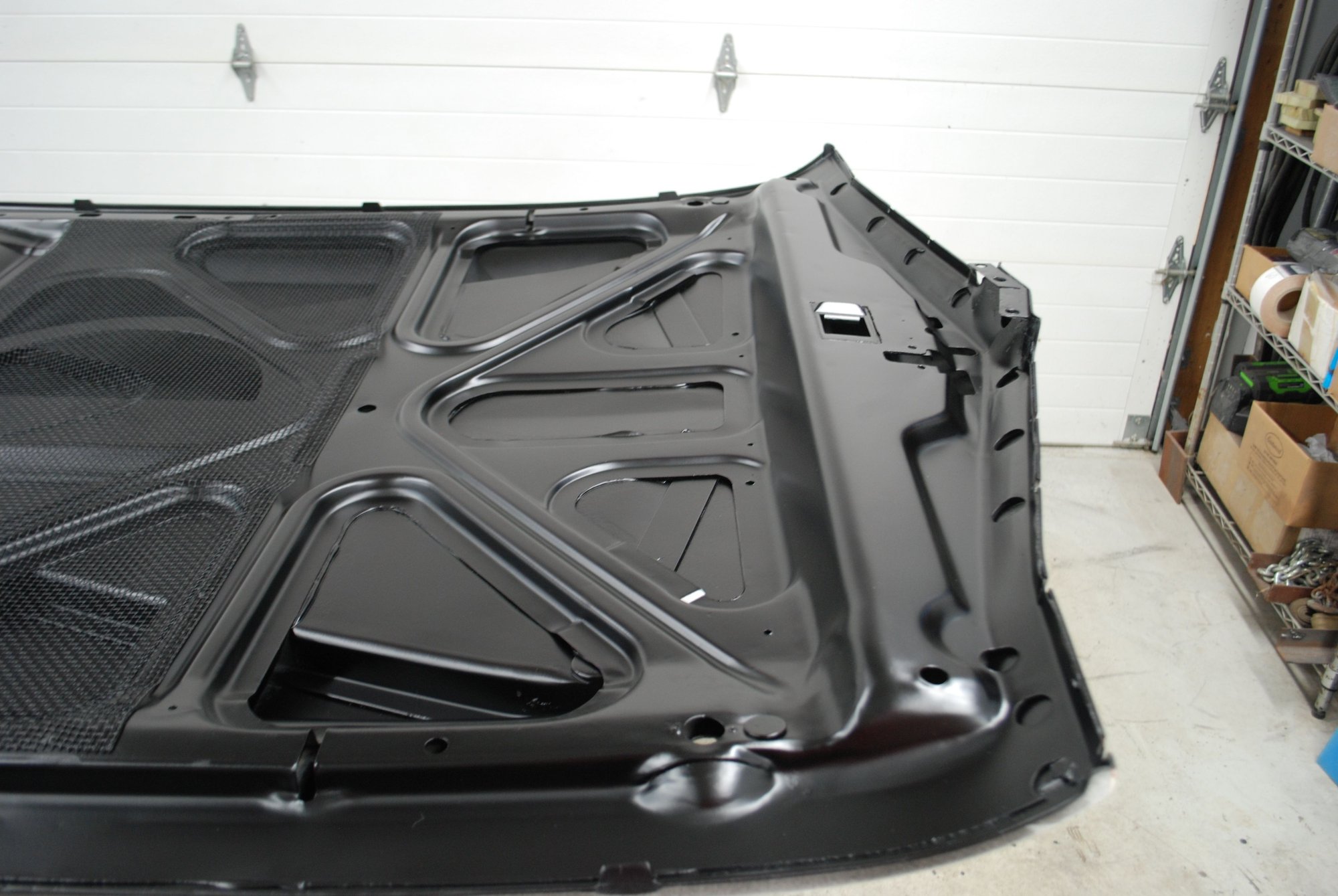

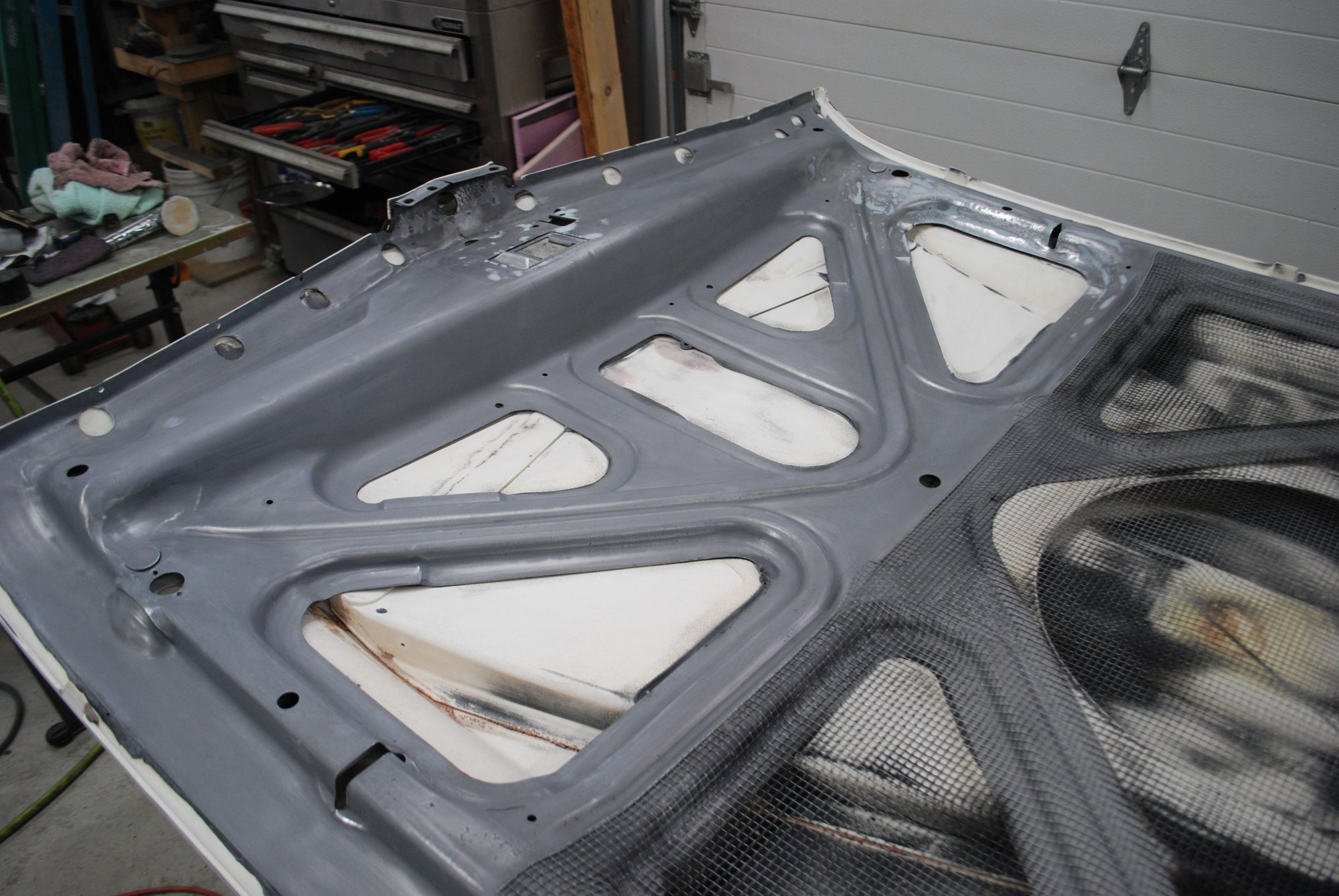

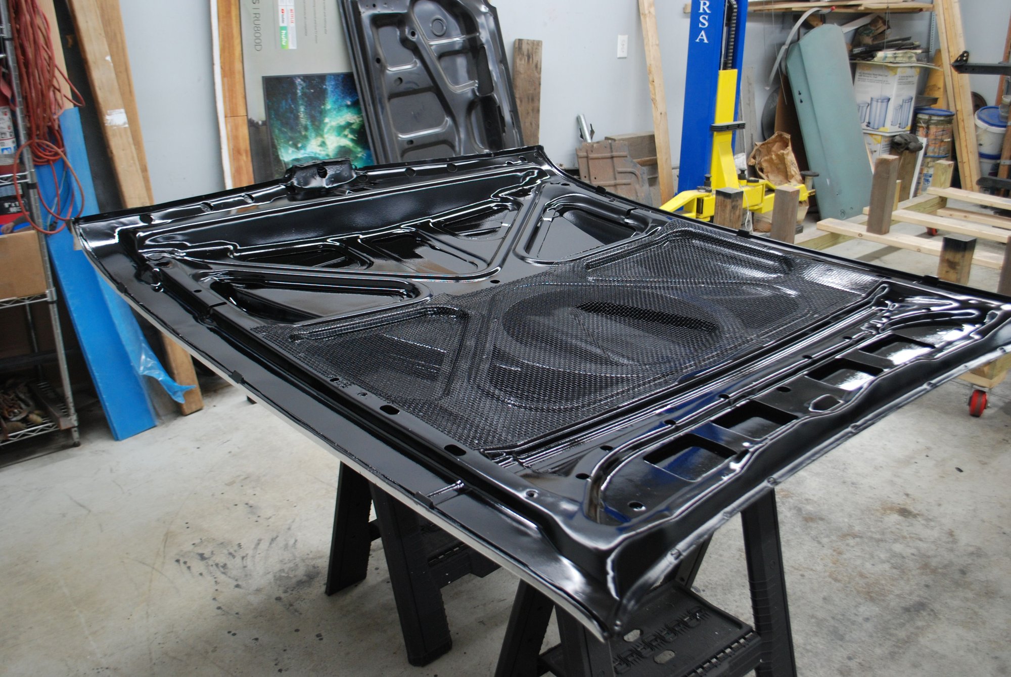

Yes sir...got that and just had steel hood frame removed and blasted...below.
The fabricator is interested in how the fiberglass and steel frame meet at the hood nose. The W25 hood I stupidly bought off a guy 7 years ago has serious probs I’m working through now.
Appreciate the advice!

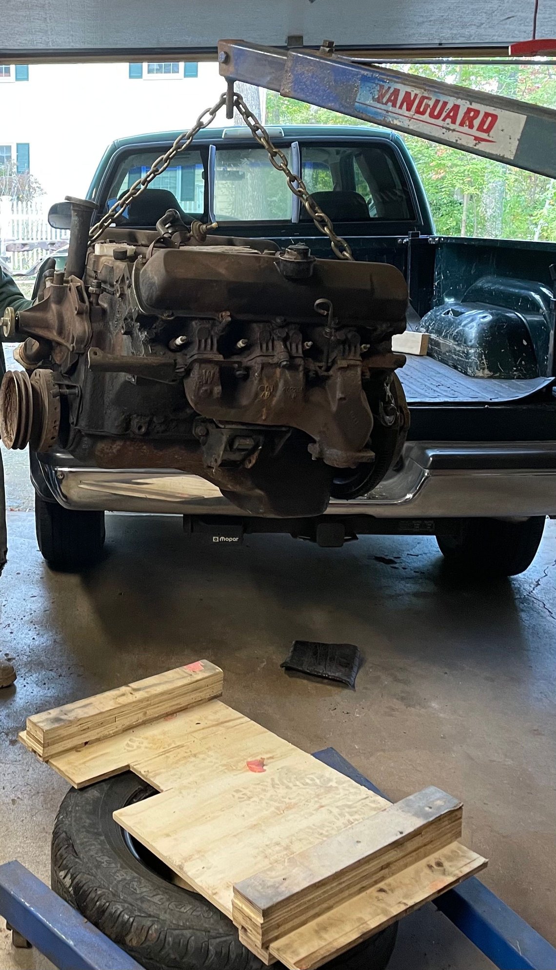

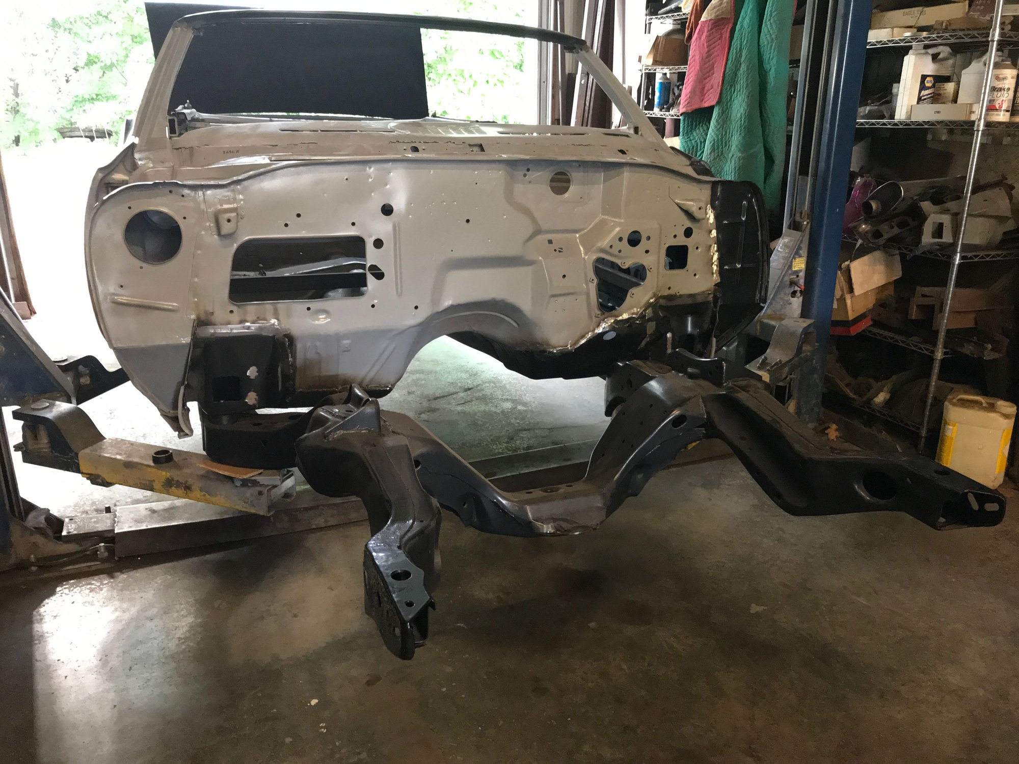

Sprang motor from Mechanic prison. He said 3 months…turned into 3 years. Nothing accomplished. They destroyed the heat riser pipe and dip stick base while jockeying the engine around in storage. Disappointing.
$ Northern Tool engine stand. Seems fine. Motor now wedged inside my ever shrinking garage.

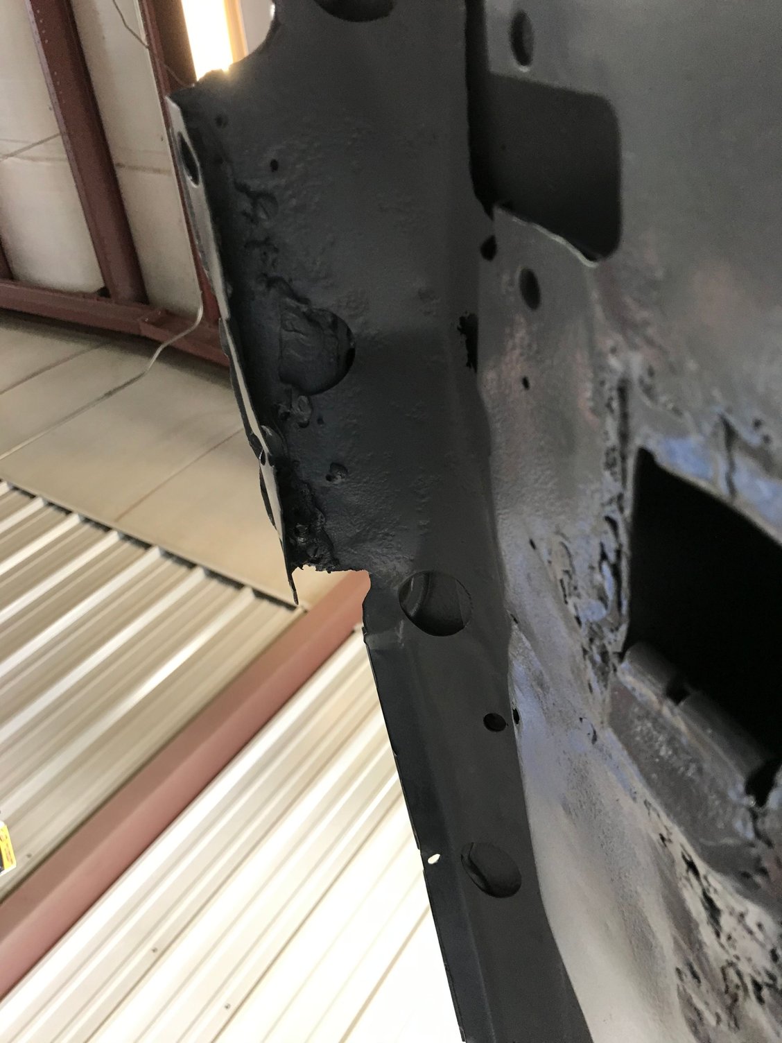

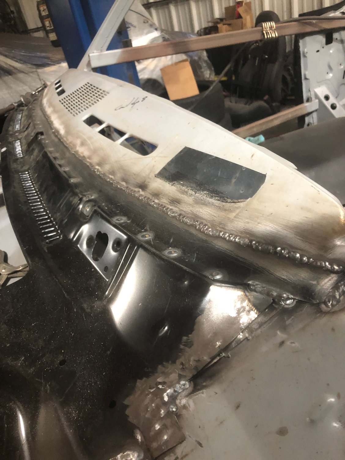

Welder grinding along. Glimpse of lower windshield issues and repair. (1 of 3)
(2 of 3)
(3 of 3)
Here now over 8 years…still in welder jail. I’m told he’s ready to “button it up”. I think that means in another year or two…or three…ha ha

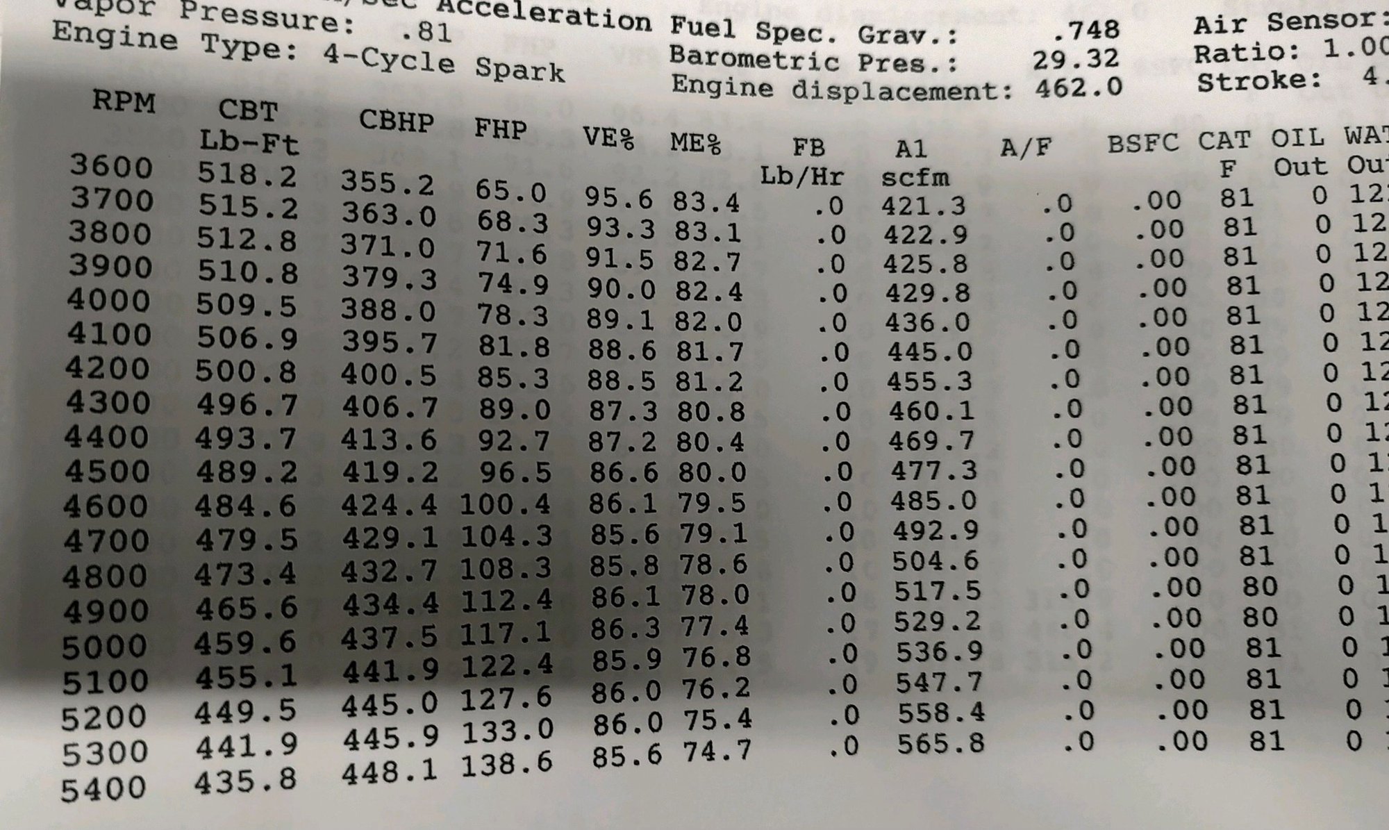

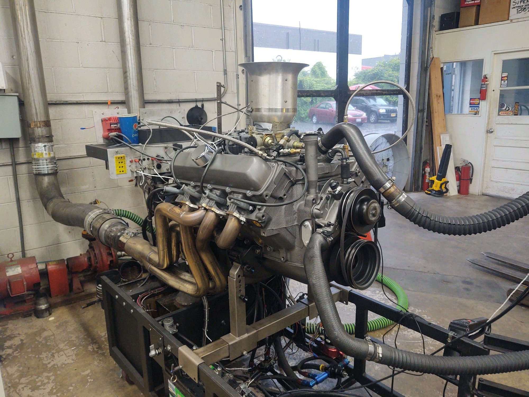

Great work! I never saw this thread before- NICE!! Man that dyno sheet is great- lots of torque down low, should be a powerful smooth engine.
Greg Rogers is online now

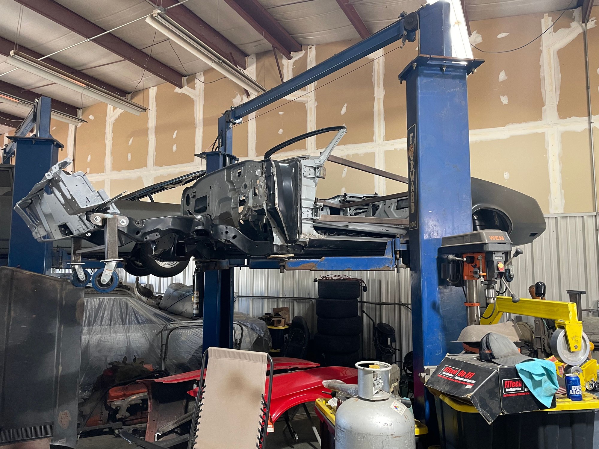

Looks good, where’s your frame

Project has been, and continues to be an interesting challenge. 3 separate trips to the dyno due to an incorrectly ground crank. The last pull shown there generated around 530 ft lbs at 3200 rpm. These motors were true torque monsters. “Powerful and smooth” would be great.

I know it, right? Well, more than likely I’ll end up with THREE by the time it’s finished. Here’s a pic of the original and a restored donor off a ‘68 Buick Skylark conv. After a side by side comparison I don’t like the ‘68 frame for this job. Although strait, rust free, powder coated and bolts up correctly, there are manufacturing differences besides the usual odd holes and slots. e.g. Crossmember piece over rear axle area is much narrower and there are frame grooves or gulleys that are not present on the ‘70 frame.
As of this writing, it’s serving as a jig for panel fitment. Will either restore org. frame or acquire a ‘70 donor. Must compare time & $ of each.

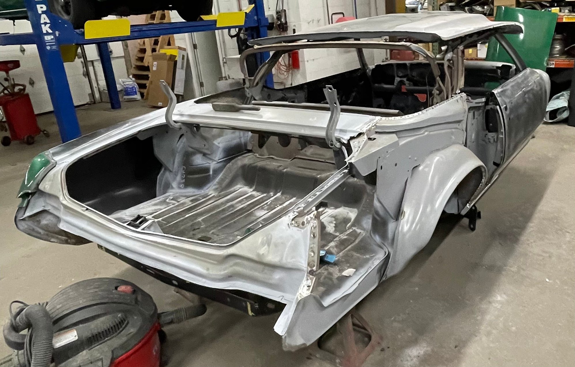

Quarters coming off…again

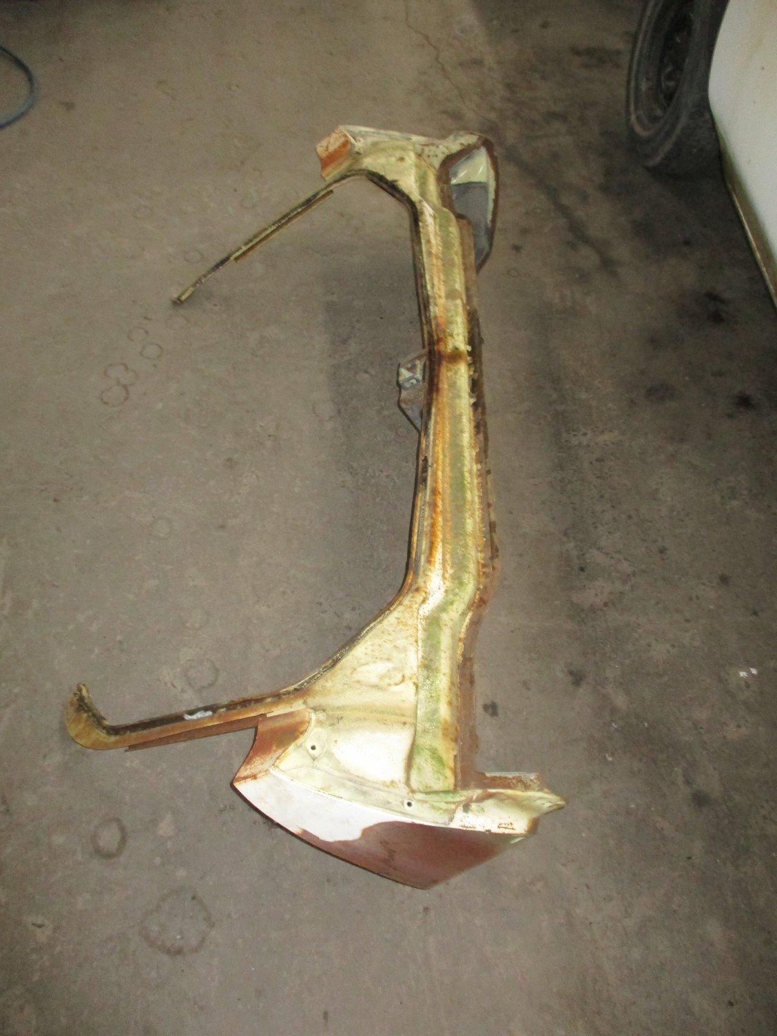

Old March 25th, 2024, 04:59 AM
  #39
KrustyAV8R's Avatar
Join Date: Nov 2020
Posts: 47
Donor car trunk pan/tail removal.
Old March 25th, 2024, 05:16 AM
  #40
Post70's Avatar
Join Date: Apr 2020
Location: Kansas
Posts: 119
That's impressive work! Nice to see another one saved.
