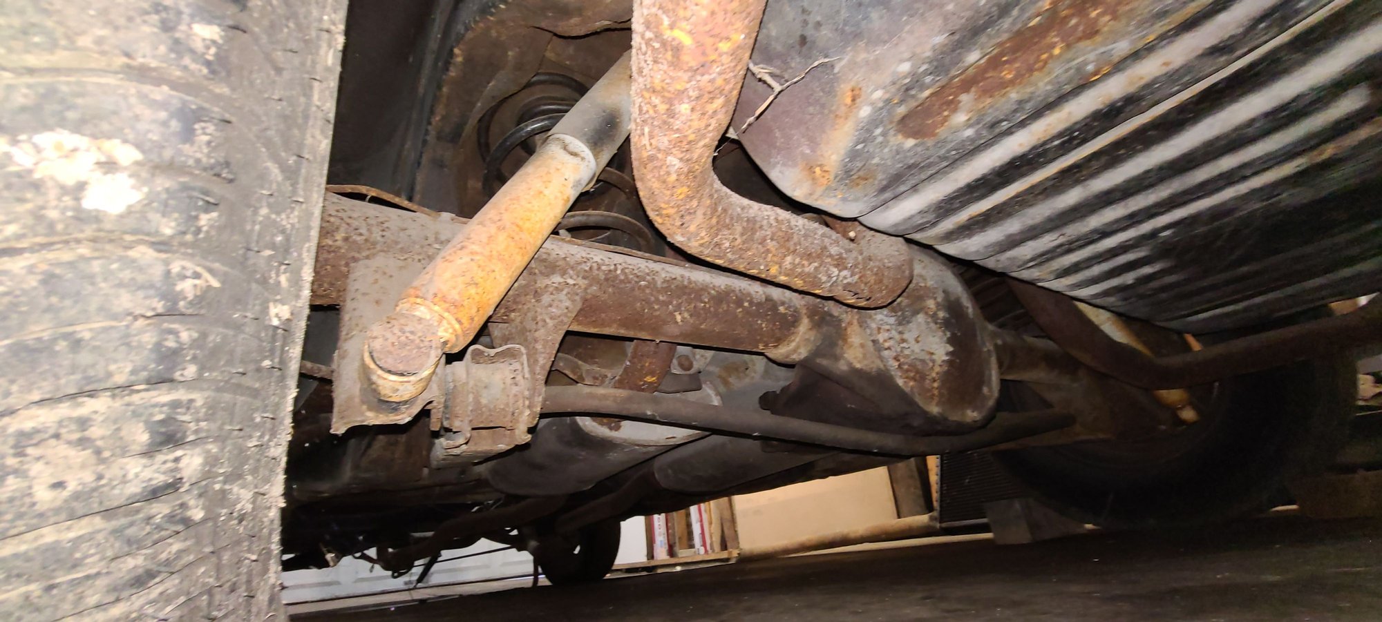

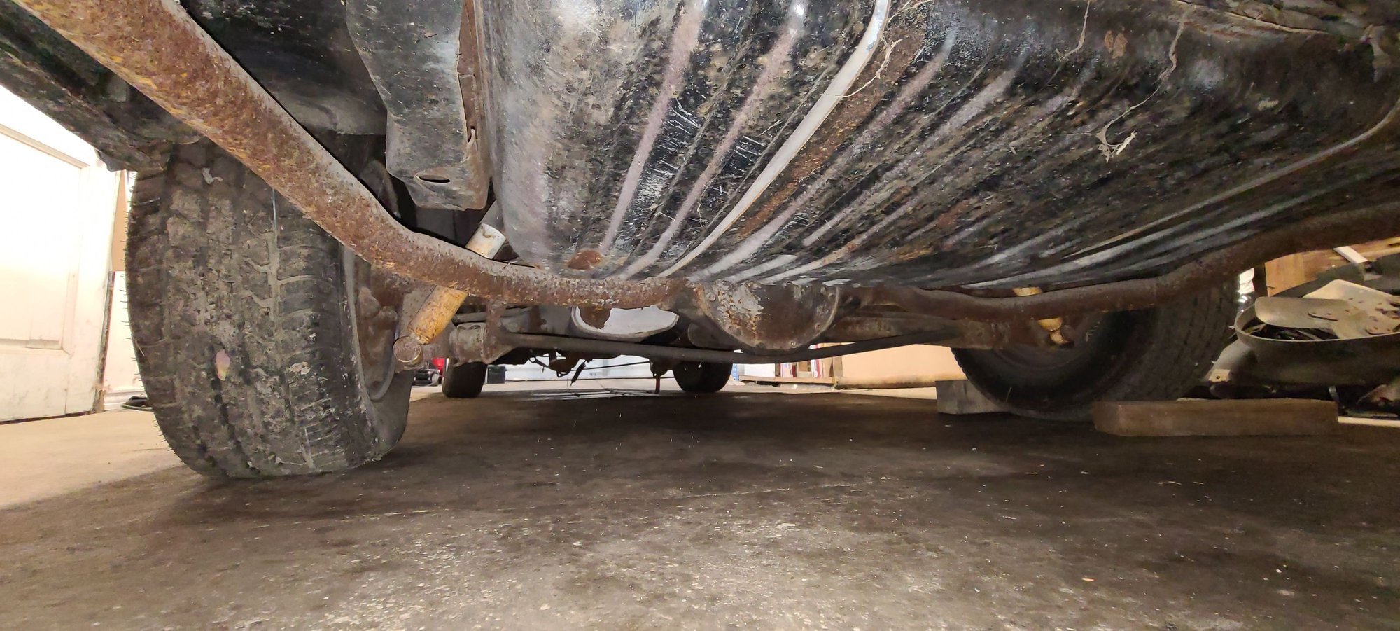

Is there a place that sells a complete front/rear rebuild kit for the suspension, or do I need to piece meal it?
This car has 31k original miles, but has been in a barn for the last 15 years. I put new shocks in when I changed the brakes all the way around, but when doing that noticed 3 of the 4 springs have some sort of helper or something in them. The longer it sits waiting on the engine to be finished, the longer I sit and think of how I need to just be proactive and replace the bushings/balljoints/etc since its down.
As much as I'd like to put springs in that drop the car a bit, based on the layout of my "driveway" its not a good idea.
Thanks in advance.

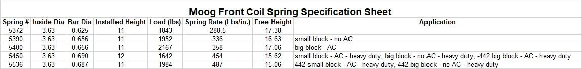

I replaced the original front springs on my car with Moog 5536 which are the HD FE2 equivalents. The car sits the same height as before but is much firmer, without being stiff, and still maintains a very comfortable ride quality.

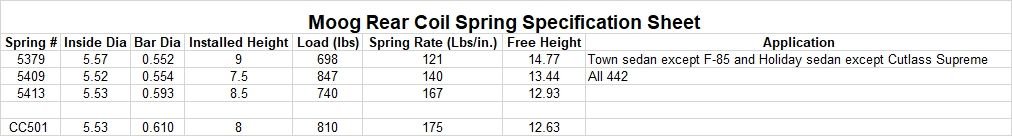

Here's info that I archived from the online Moog catalog many years ago. I stripped out everything except the 68-71 442 applications. Dunno why the 69 application shows a 350 engine - there wasn't a 400 listing at all for that year. Anyway, I would do 5536 front and 5409 rear (that's what I have on my car).

I've got a 69 442 with the 400 with AC. Based on the 2nd chart above, wouldn't I be looking at the 5450?
brotherGood is offline
Old November 23rd, 2021, 06:26 PM
Join Date: Feb 2013
Location: Phoenix, AZ
Posts: 13,949
Yes
Fun71 is online now

The Rock Auto link is to the 5536 which seems to be a softer spring. Based on the chart, it also isn't correct for the BB 442 with AC.
Would it make that drastic of a difference?
Old November 24th, 2021, 11:44 AM
Join Date: Feb 2013
Posts: 13,949
Sorry, I looked up the 5536 instead of the 5450.
As for the 5536 being a softer spring, if you note in the specs, the 5536 has a spring rate of 487 lbs/in and a load rating of 1984 lbs. The 5450 is 454 lbs/in and load rating is 1642 lbs. So the 5450 seems to be the softer spring.
I think the key difference is the installed height, which is 1" taller for the 5450 over the 5536.

Just got a reply:
Here's the specs listed in the book. Keep in mind that many times they are slightly different than what's listed in the books.
Front
3.620 ID .690 Wire 1642 lbs @ 12" 449.9 lbs/in 15.650 Free height
Rear
5.545 ID .552 Wire 737 lbs @ 7.5" 142.0 lbs/in 12.681 Free height

Just compared the ESPO numbers to the Moog chart above, it looks like they're closest to the Moog 5450 front and the 5409 rears.
Neither of which I had been able to find when I looked the other day (they show as being indefinitely out of stock).
That being said, I may go ahead and order them as they seem to be in line with the other spring pricing I've seen.
