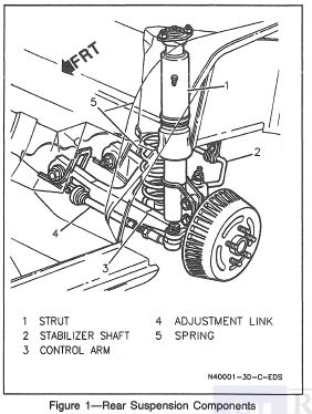

Here is a schematic of the rear suspension:
I figured I could go to the salvage yard and take the rear control arms off of a parts car then have the control arm bushings and ball joints replaced by a shop. Both the control arm bushings and ball joints in the back are pressed in.
The question I have is how do I safely remove the control arms in the salvage yard? The cars are up on 4 mounts so the rear suspension should be completely hanging. The service manual calls for using a special tool under the control arm (of course I don't have it). In the past I used a hydraulic floor jack under the ball joint and lowered the control arm after disconnecting the spindle but the salvage yard says "no floor jacks allowed!" Am I going to have to use side mount spring compressors? A friend of mine lost a finger to those before. Has anyone used a chain when compressing springs before?

You could disconnect the sway bar links. Then remove the upper strut mount nuts from inside the car with an electric impact if there is room. At least you will be inside when the fun happens. Lol
other wise asking the yard if they can cut the springs is the best option.

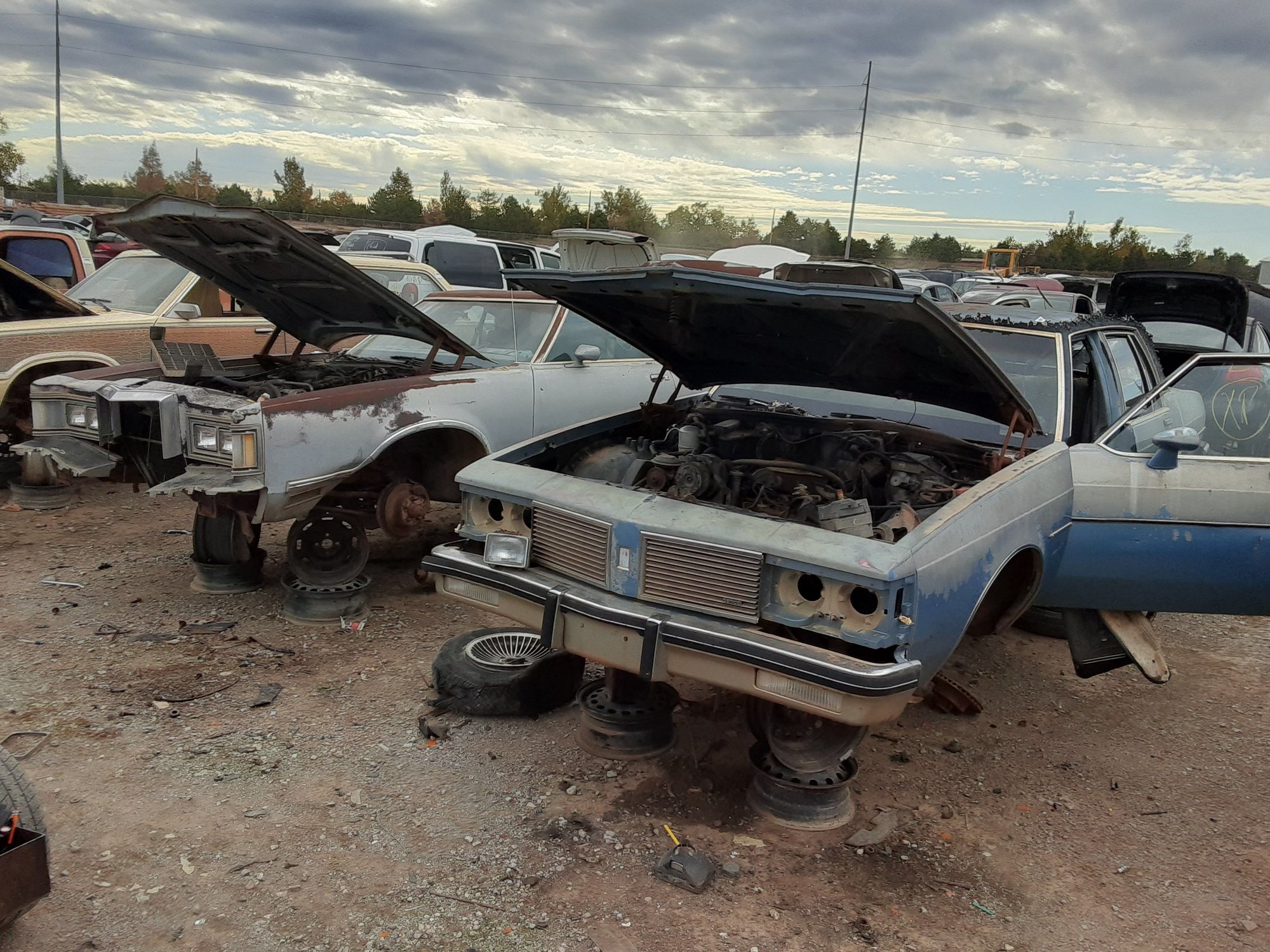

There was an 82 Delta 88. It has the 307 sans carburetor if anyone is interested. I had to include that Lincoln Mark IV in the pic. They sure knew how to make them years ago...
