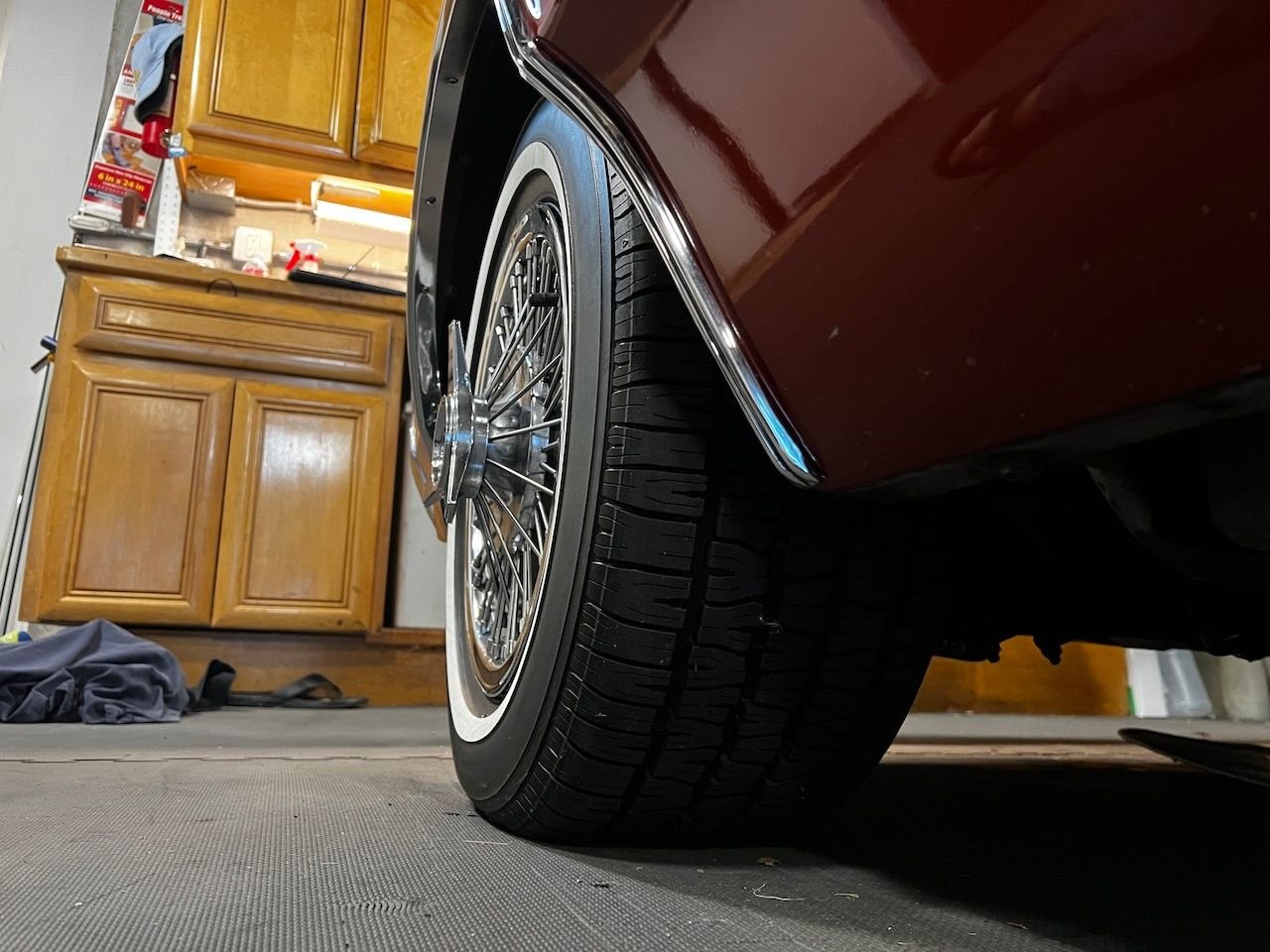

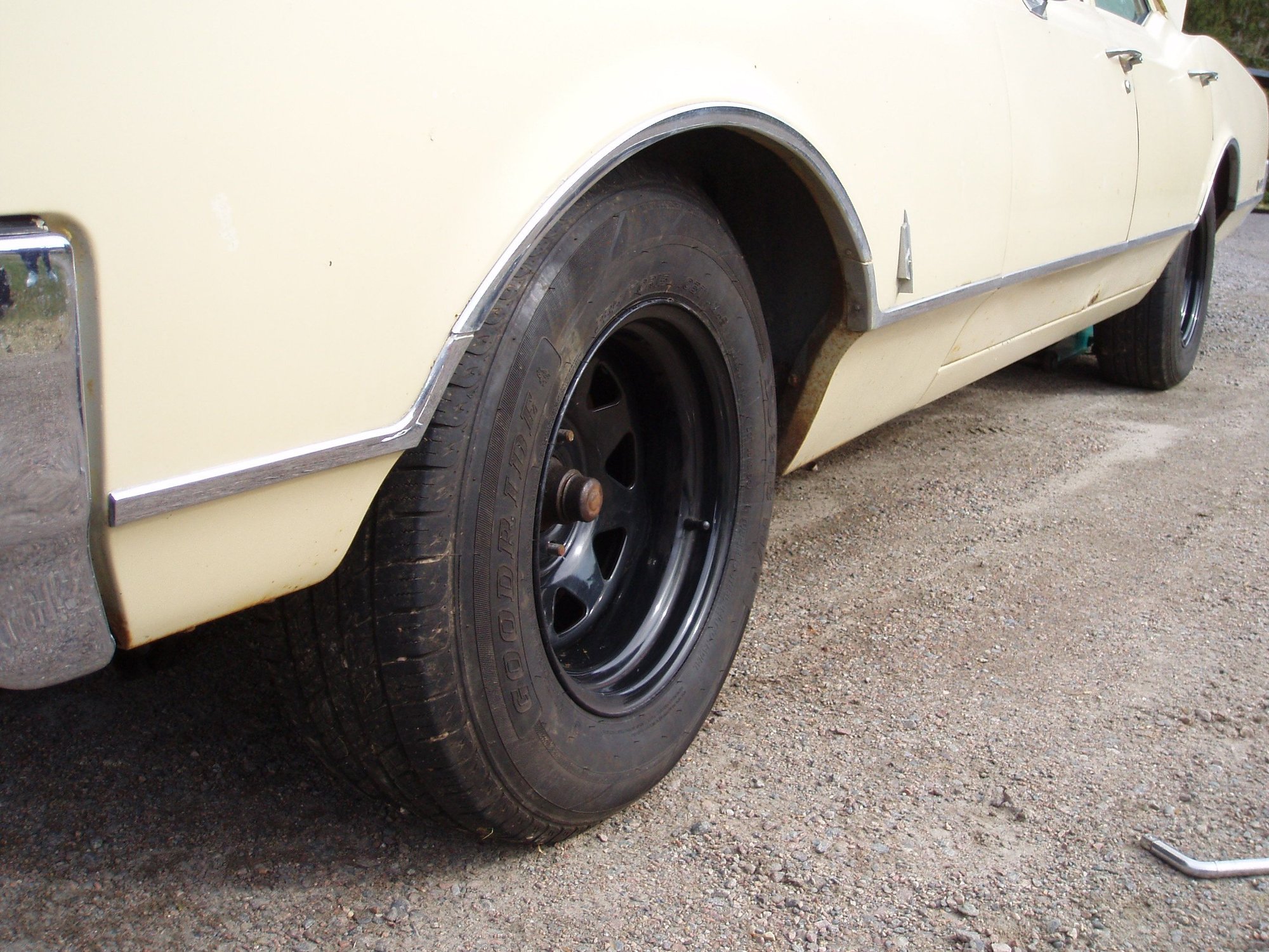

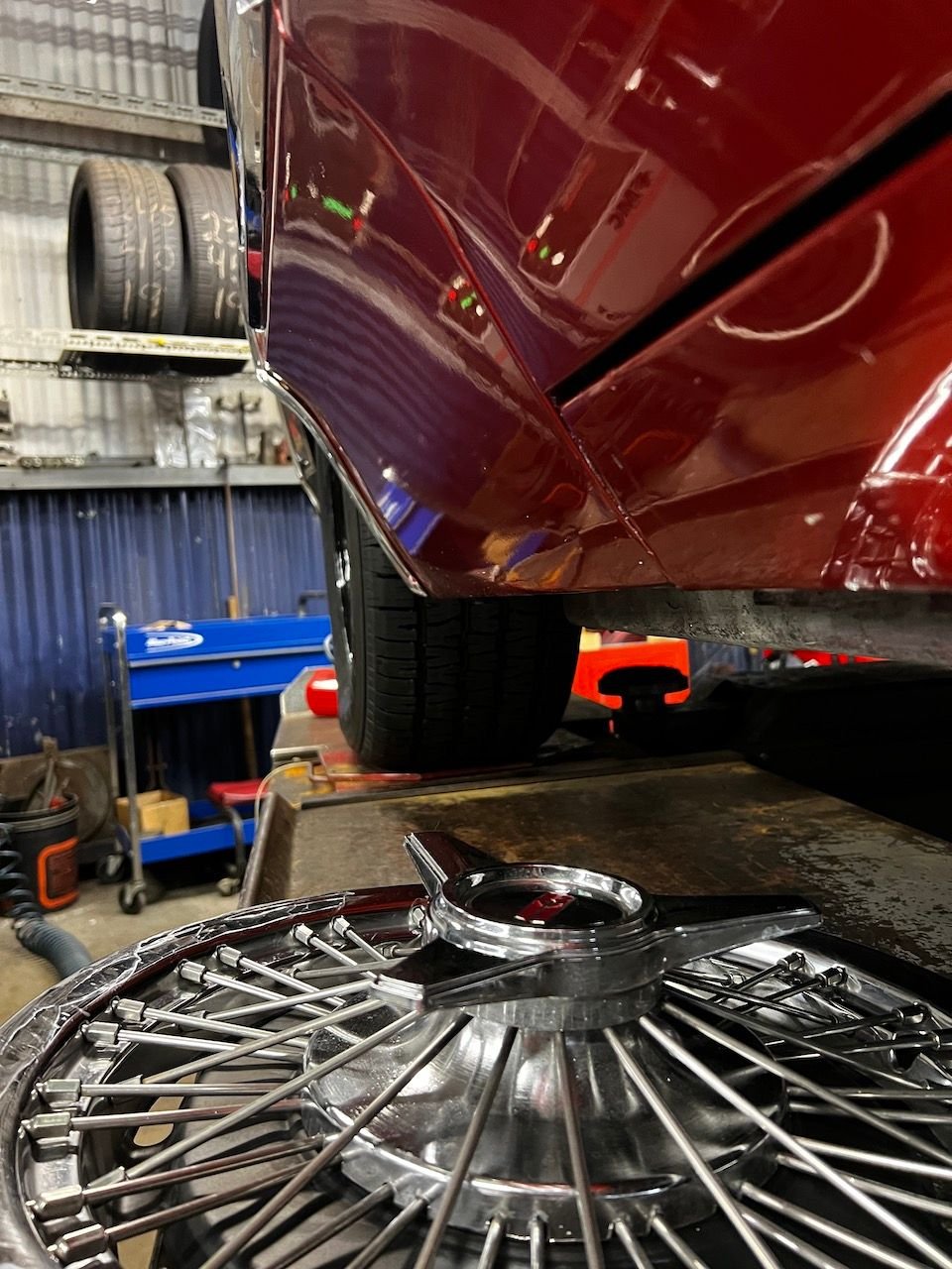

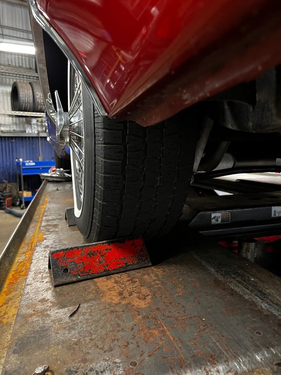

Thought you all might like to see a comparison of old vs new on the '66 Starfire:
The old: 225/70R15 BF Goodrich radial TA's on rear 15x7 wheel of my '66 Stafire. Better than the original 14x6 by a good measure, but I decided to upsize again.
Tire testing of 245/60R15's on 15x8 wheel:
The new: 245/60R15 on 15x8 wheel. Reminds me of the Blues Brothers line about "Cop tires, cop suspension"

Just tested the 245/60 R15 tire size on my '66 98 convertible. I have 2 pretty similar cars, I was hoping I could have 1 tire size for all.
No go on the 98. They'll work fine for my Starfire which, mechanically is more or less a gussied up 88.
The '66 98 Olds has fender skirts. The skirts force an outer limit for the width of the tire. The 245/60 R15's would work fine on the front, but will sit too close to the rear skirts to work well. They don't _quite_ interfere, but that's standing still. Tolerances were close enough that I had no confidence it would work in motion.
My tire guy ran the experiment with a 245/60 R15 mounted to a 15x8 with 4.00 offset. The fender skirt securing rod didn't clear the wheel unless bent and hit the tire too. We concluded this wheel/tire combo won't work well on the 98, unless I go chasing custom offset wheels which I'm not inclined to do this time around.
